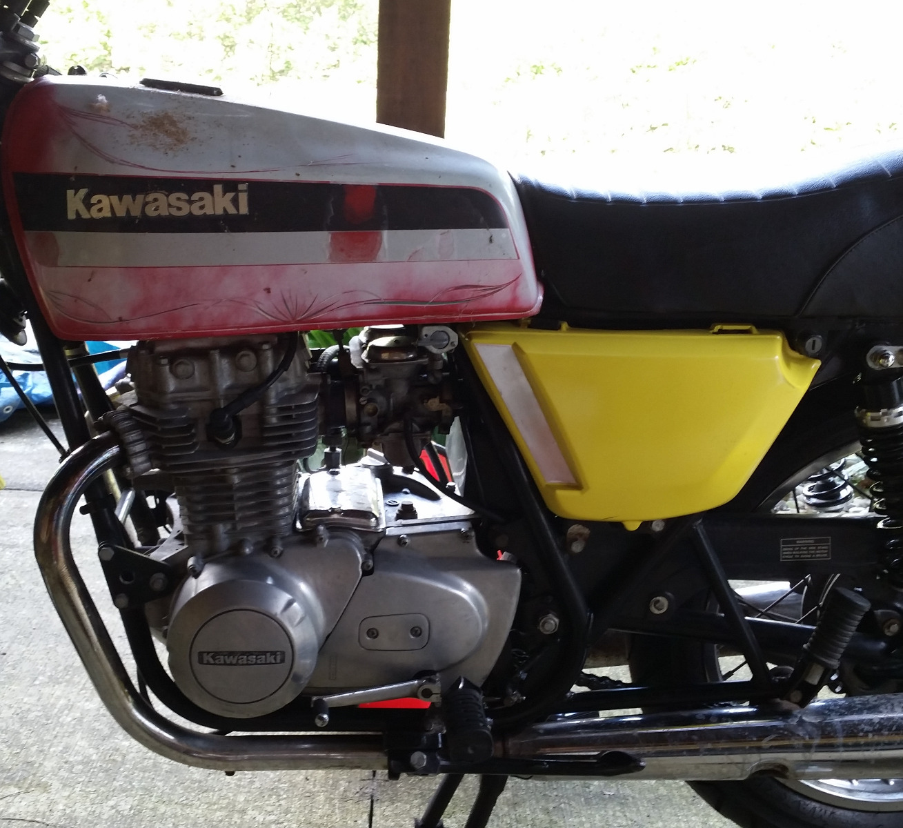

The tank from a KZ550 (or '81 GPz550) will fit, though I don't recall the capacity offhand. This is an experiment I did a few years ago.

D'oh! I'm sorry - didn't see that you have an A model *and* I managed to mix up 440 and 400.
That's a '79 KZ400B: it has a flat seat. However...
I didn't do anything to the rubber mounting dealies on the bike or anything to the tank - just stuck it on there. The clubman bars did not appear to be an issue lock-to-lock, but I must mention that I did not ride it like that.

When using a 550 tank on a 400 twin for daily driving, you will want to mod the front tank mounts to make it more stable.  We installed a small piece of radiator hose around the front rubber donuts to prevent the rubber donuts from slipping out of the metal holders on the tank.  Very easy to do and prevents the tank from moving and getting gouged up near the steering tube, which ends up very close to scraping the tank.  Also, even though some 550 tanks look identical to each other on top, they are different underneath.  The ones with smaller clearance underneath don't fit the 400 without bashing the underside.
