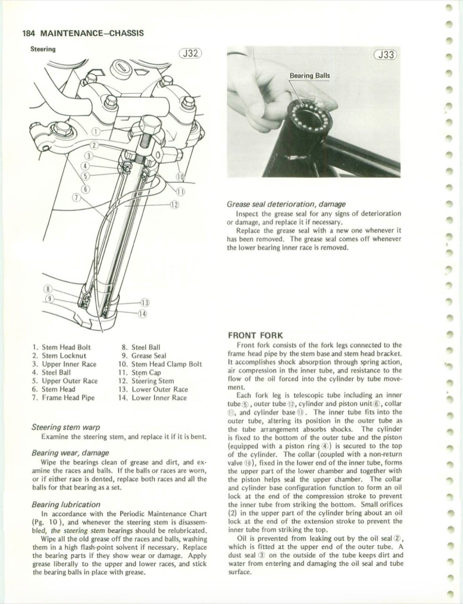

Sorry .. forgot to attach pic.
It should be 1977 or 78.

The spacer circled in the pic isn't a seal. I think it acts as a bushing. Mine are a white plastic.
AFAIK, replacements aren't available separately, but are part of the fork cylinder assembly.

It’s a fork damper piston ring. Z-Power sells them. Couldn’t find a listing for the 650.
Your original ones are phenolic material. Very brittle. If you must remove them EXTREME caution and patience needed. DO NOT over expand them to get them off. THEY WILL BREAK!!!
www.z-power.co.uk/z900a4-kz900b1-ltd-197...n-ring-5007509001000

Is there a way to determine the wear factor? I wouldn't bother changing it if it is still in the wear factor range.
I assume that it should have larger OD than the metal OD. How much are we talking about?

Here it is mentioned part number 4, but no mention of testing it. I’d suggest contacting a company like Sonic that deals with forks. They might have an answer.
