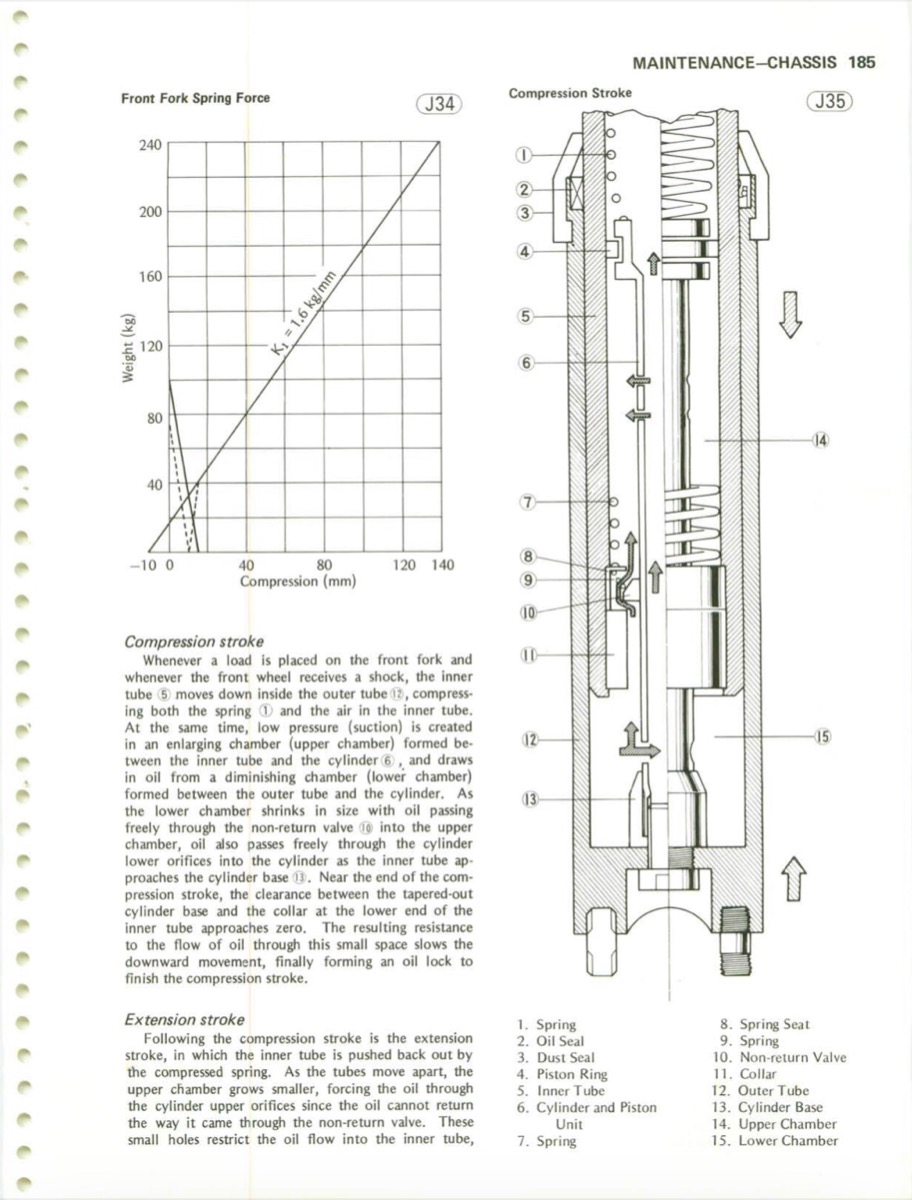

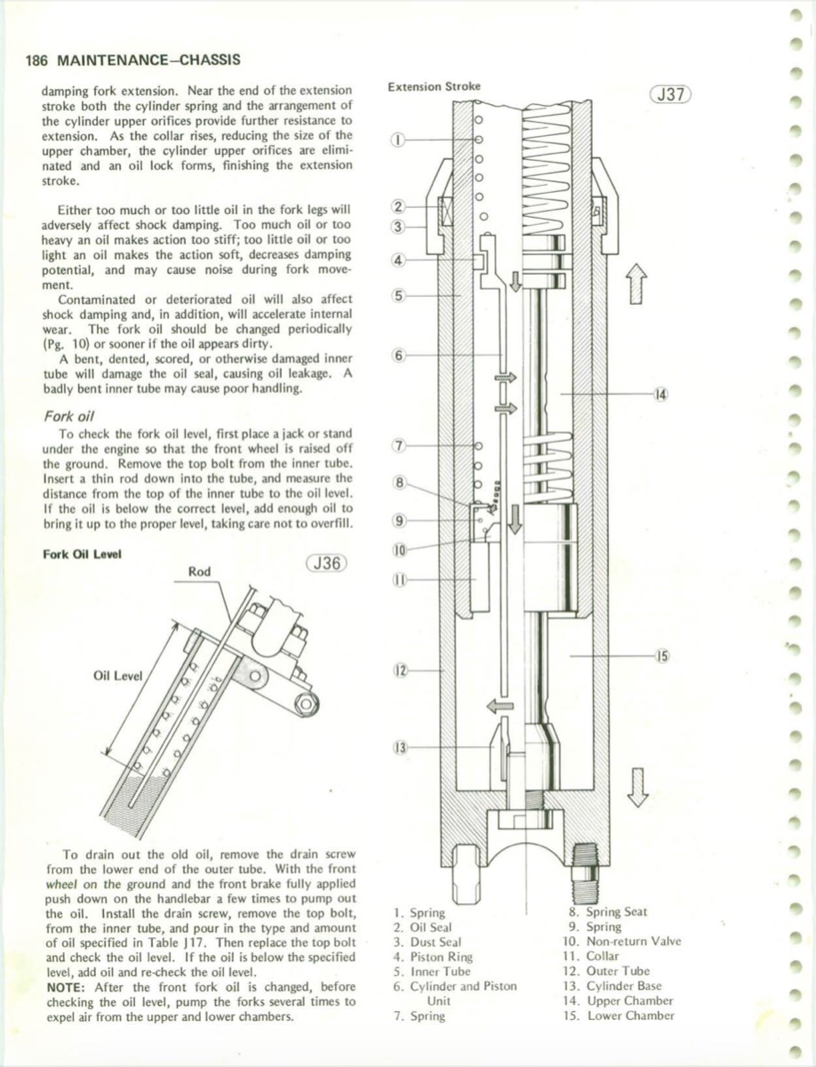

The spacer circled in the pic isn't a seal. I think it acts as a bushing. Mine are a white plastic.
AFAIK, replacements aren't available separately, but are part of the fork cylinder assembly.

It’s a fork damper piston ring. Z-Power sells them. Couldn’t find a listing for the 650.
Your original ones are phenolic material. Very brittle. If you must remove them EXTREME caution and patience needed. DO NOT over expand them to get them off. THEY WILL BREAK!!!
www.z-power.co.uk/z900a4-kz900b1-ltd-197...n-ring-5007509001000
