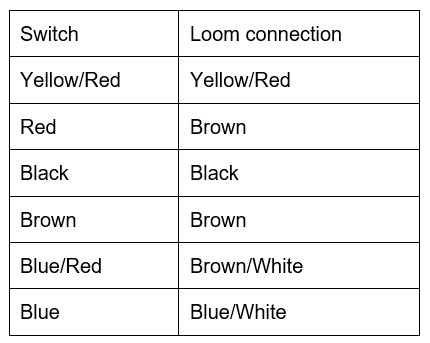

So hello to everyone.
i purchased a 1977 Kawasaki Kz1000A and it came with a right side handlebar switch for a 900 so the wire colors are different.
The SWITCH wiring is yellow with red stripe, red, black, tan, blue with red strip and solid blue.
I've taken the switch apart to see that The tan wire and yellow/red wire goes to off and on engine stop
The blue, blue and red strip and tan goes to middle On-PO-off switch
The black wire and yellow/red stripe goes to the starter button.
The colors of the wires on bikes main harness are Yellow with red stripe. brown with white stripe. Blue with white stripe 2 solid brown wires and Black
I do have a book but unfort- my vision is not all that great. I'm hoping someone can match the wires up for me! Any help match these up is GREATLY APPRECIATED

Re: 1977 Kawasaki 1000A wiring colors
22 Sep 2023 01:11The below should sort you out, if not I will need to see pictures of the inside of the switch. Let me know how you get onSo hello to everyone.
