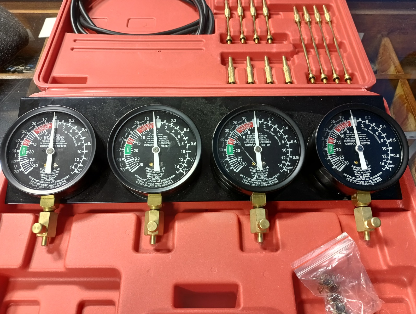

Hello everyone, I have not yet synchronized my RS34s. What would be the symptom of incorrect synchronization? I bought some vacuum gauges, but they are of low quality.

MLMG, that’s pretty much the same kit I bought but sent it back. I did use the hoses though and just did 1 at a time plugging off 3 with golf tees. I had a good quality gauge in my toolbox so I knew it was accurate. A little more of a pain that way but I found that I had to shut down the motor often because it would get a little to hot.
One little tip though is that 1and 4, 2 and 3 react together so say if cylinder 1 is at 12 and 4 is at 8, adjust cylinder 1 to 10 inches vac and 4 should be pretty close. Hope I’m saying that right.
