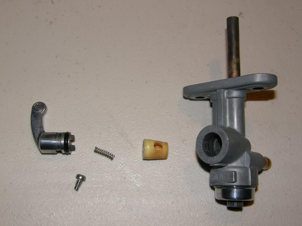

If it is the stock non-vacuum powered petcock there is not much to it, see attached pic. I have read of others using something like toothpaste to lap in so to speak that tapered plastic item and the port it fits into. Do not know if that will help or not?

it is indeed the non-vacuum version and the culprit is likely that little piece of conical plastic. I will try cleaning everything with my ultrasonic cleaner and hope for the best. Does anyone make that plastic piece, Z1 doesn’t seem to carry them.
