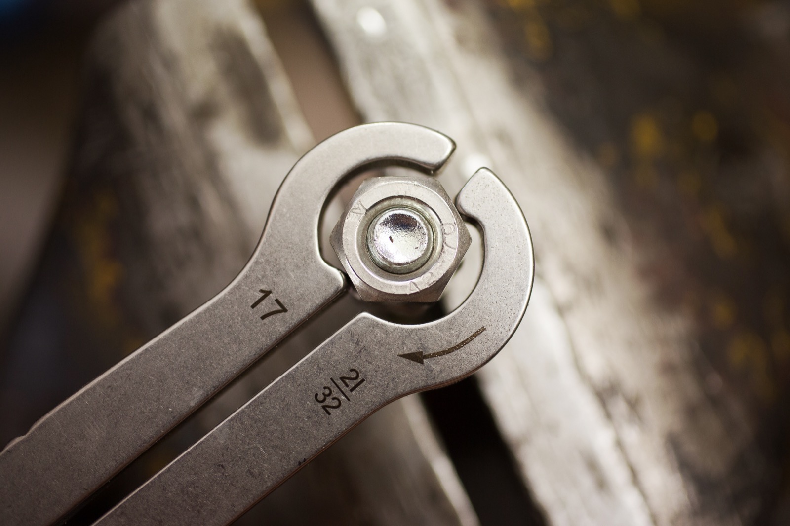

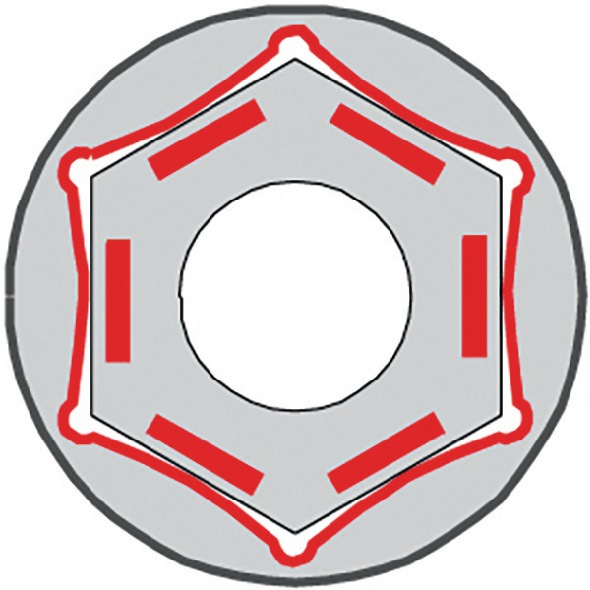

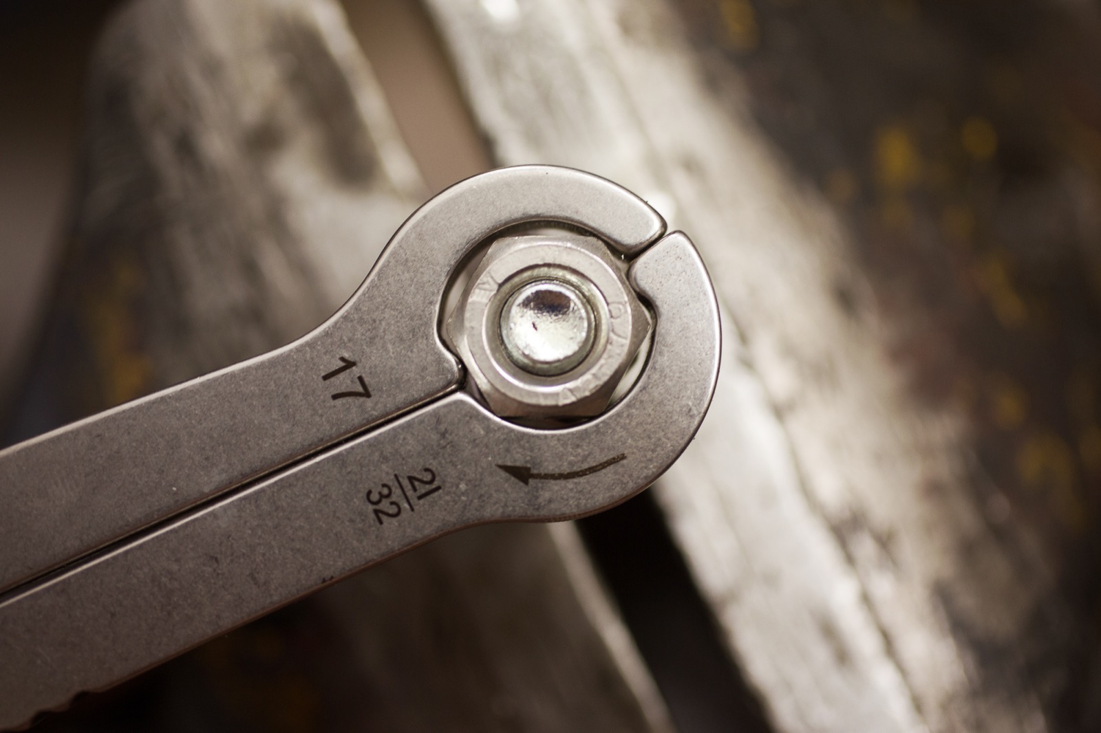

So here some advantage and dis-advantage of the diffrent socket Driver systems
Good for normal torque
Better for high torque and fu*k up bolts and nuts
A new Driver System that can handle Inch/metric and fu*k up bolts and nuts in one tool
