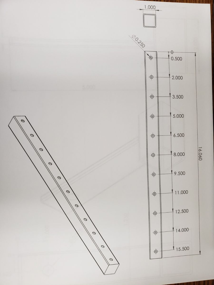

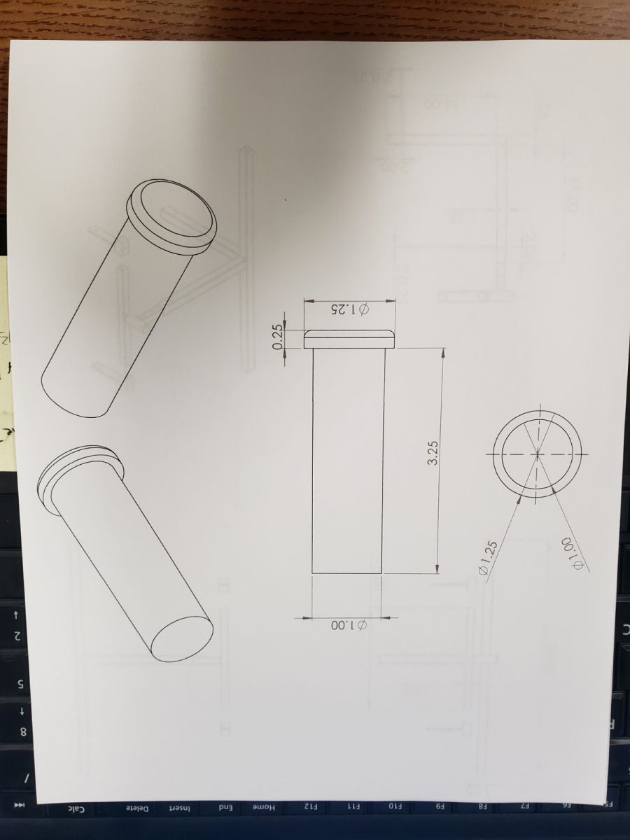

    So I did some looking around for an engine stand online and figured out a good one runs about 250 bucks. Well I'm a welder and fabricator so I said stuff that and made my own. I've attached plans and a couple pictures of my finished product. If anyone needs any more detail or has solidworks and wants them I can send the solidworks files, just pm me. I made mine fairly adjustable, should be able to adapt to any inline style engine with the long front and rear motor mounts. Goes from about knee height to waist height. If you've got the equipment and access to some square tube this is the way to go. Cost me about 75 bucks. Oh and btw I forgot to change the drawings but I bumped up all my .25 holes to ..3125 just to give them a little more surface contact when holding stuff down.

    Yeah i made my solid pin in the lathe but i don't think it'll be a problem my gap is still like .025 and the shouldn't be that much force on it to where i have to tighten it super hard. Put a handle on her too i don't need to worry about using my wrench when i want to spin it.
