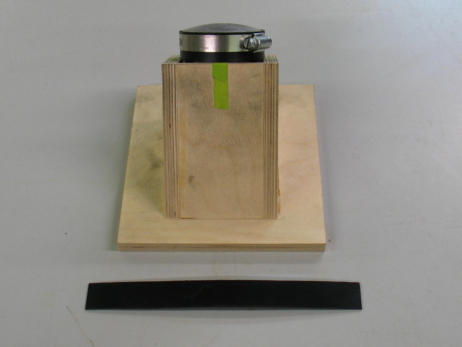

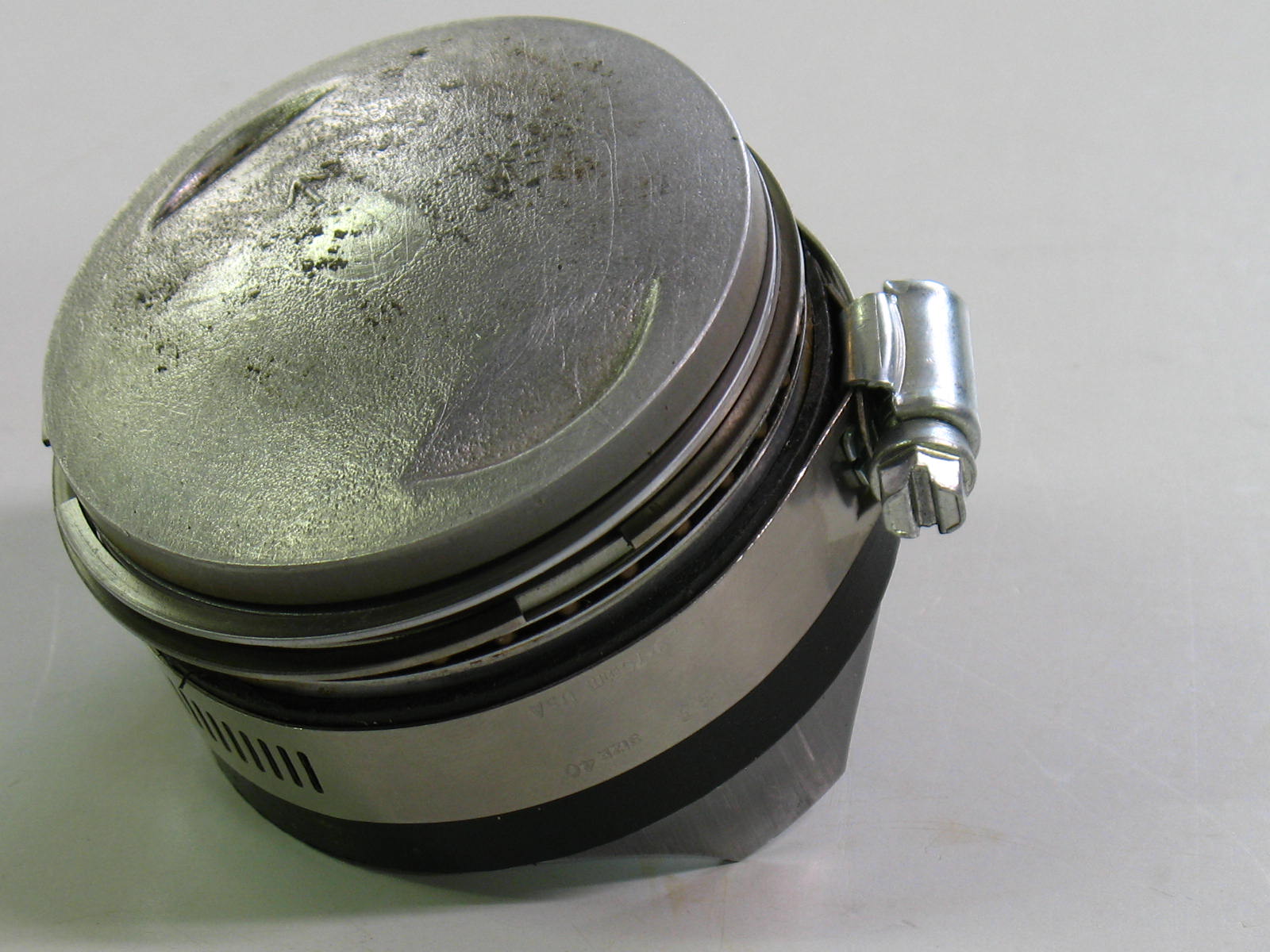

09 Feb 2016 18:14 - 09 Feb 2016 18:23missionkz wrote: so satisfying.... compared to trying to do it with all the nutty contraptions, hose clamps, beer cans, plastic wire ties (you name it) I've seen them all.
First attempt, and was a joy too. A cheap one... :lol:
The black plastic strip is slick. It gets pressed down the piston by the bottom of the cylinder sleeve as it presses on the edge of the strip. The rings pop free inside the sleeve where they should, with the gaps locked in their proper positions. You don't get that using fingers to compress the rings.

What is the plastic? What's it from/for?
