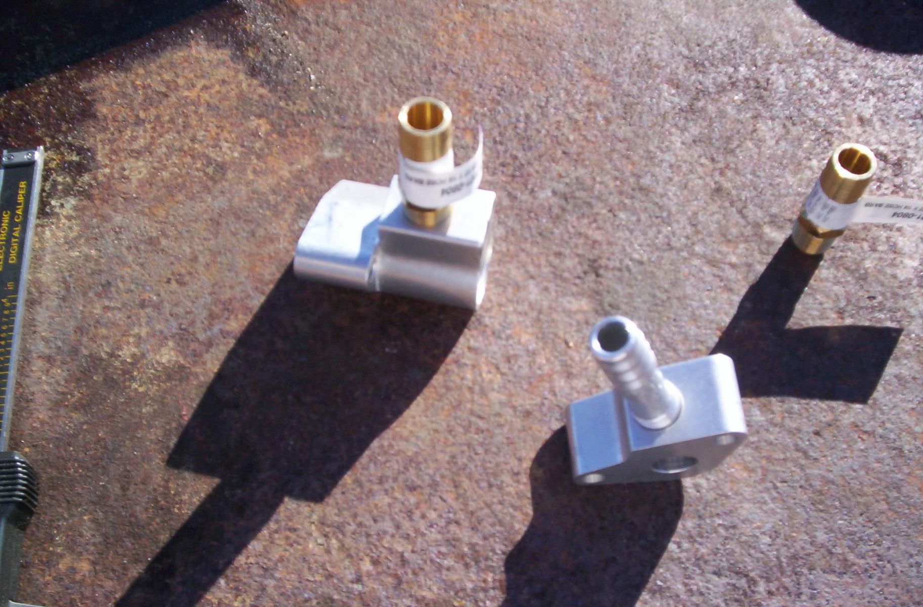

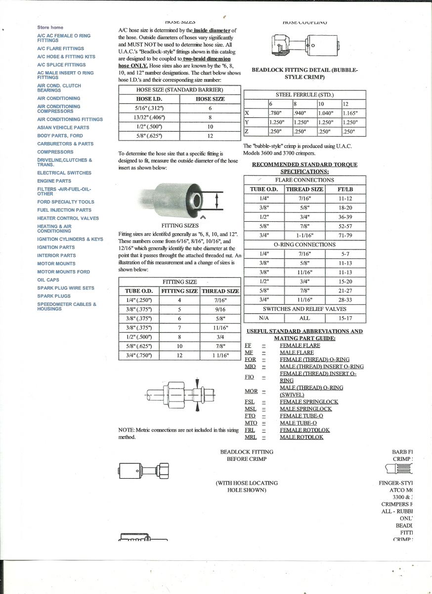

No eBay APP ID and/or Cert ID defined in Kunena configurationNo eBay APP ID and/or Cert ID defined in Kunena configurationHere's a FYI for those looking for odd ball fittings. After looking at plumbing and hydrolic fittings, I remembered A/C fittings come in different sizes and shapes. I ordered the #8 barb fitting and talked to the guy about the other ones. He told me to type in chart so I can download it. He gives them away free with the orders. Nice man. I may be able to get the REAL elbows to fit on the cooler too.

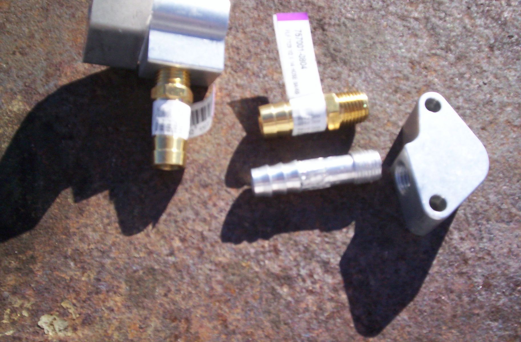

Well, I got the fitting. It's too small. I must be speaking Martian or something. The ID MUST be 1/2"/13mm. Now that the weather is cleared, I can go and chose one myself.

Well they do make 1/4 NPT X 1/2" barb fittings. Just went down the hill to the new True Value and there they were. Much better selection than those other bums. I was planning on getting a double barb, cutting it in half then threading it to fit.The #8 I got was still too small inside. Ready to hook it up. :woohoo:
