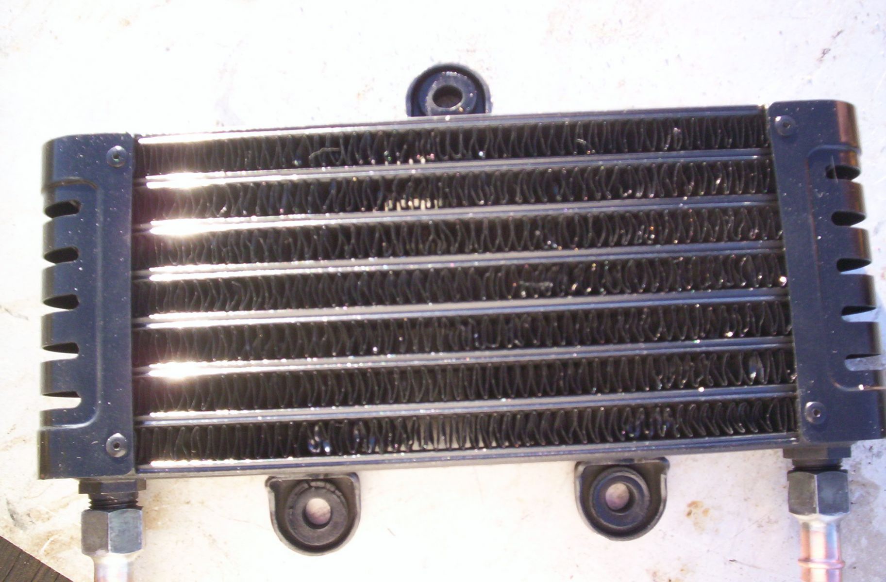

Looks good. Squirted a little paint on it. It's purdy. I may have to get some 90* barb fittings for it so the lines won't be hanging out and I can tuck them under the cooler, along the back bone, then down to the fittings.

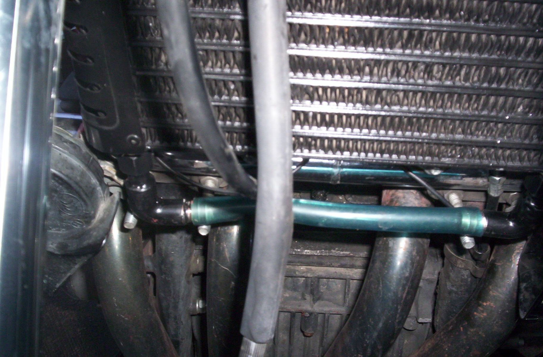

Being the fittings on the cooler are 3/8" compression and I was able to open up the inlets to 1/2" 3/8" compression/ 1/2" barb don't exist not to mention 90*. So I had to make my own. Used a copper 90* street elbow, crimped the slip side with my flaring tool in a vice, cut a double barb fitting in half and soldered them together. Had to drill out the slag inside and they should work for now.
May look a little funky but they'll work.

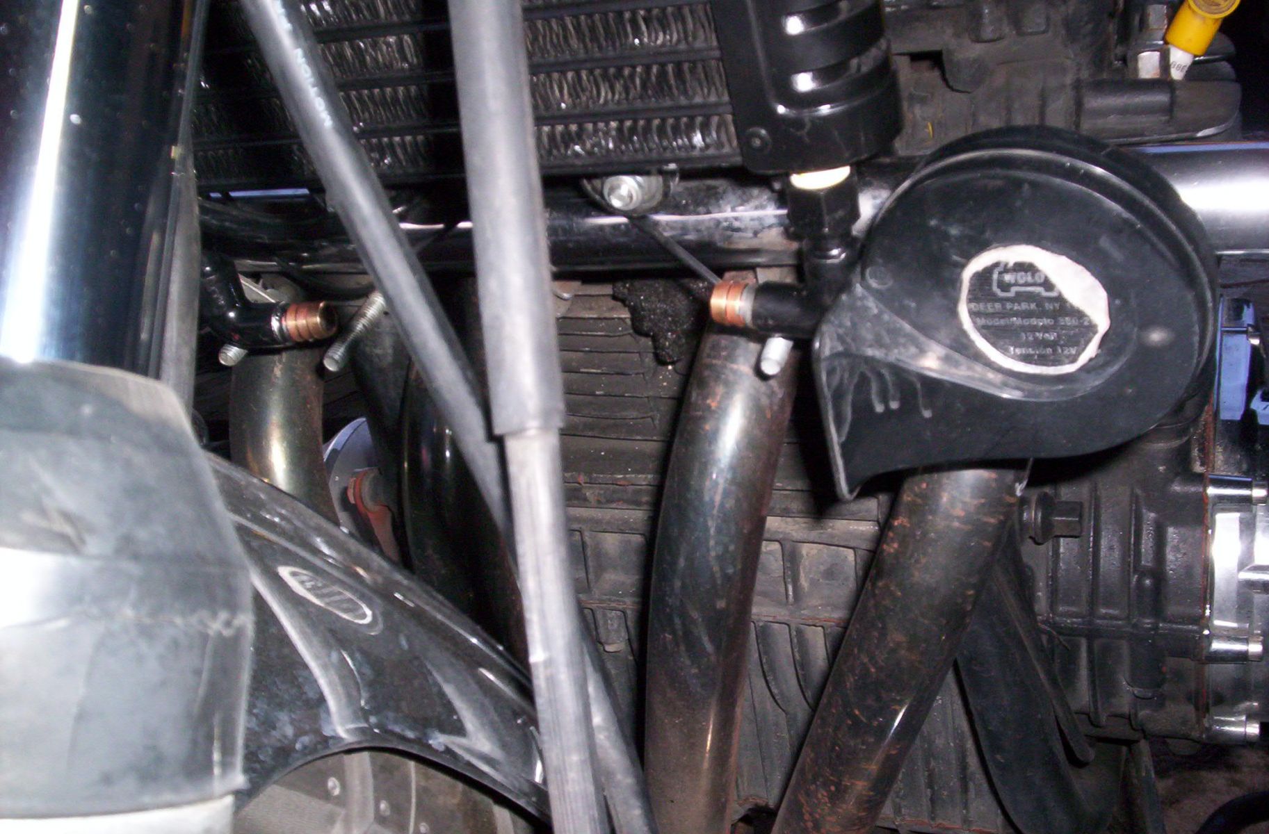

Well got them on. Had to make spacers to get the cooler away from the crash bar and let the clutch cable run where it needs to be. Used 3/8 fuel line and longer bolts. Nice and solid. Put some clear tubing on the inlets to keep dirt out while I get the rest of what I need.

Are you planning to run the lines between headers 2&3, then under the engine?

No up and over the top along the back bones, then down between 2&3 carbs. The idea is for the oil to stay in the cooler.

Cool. Would it have been easier to flip the cooler so the lines enter from above?

That was the plan. Too big and I don't want the lines showing. :whistle:
