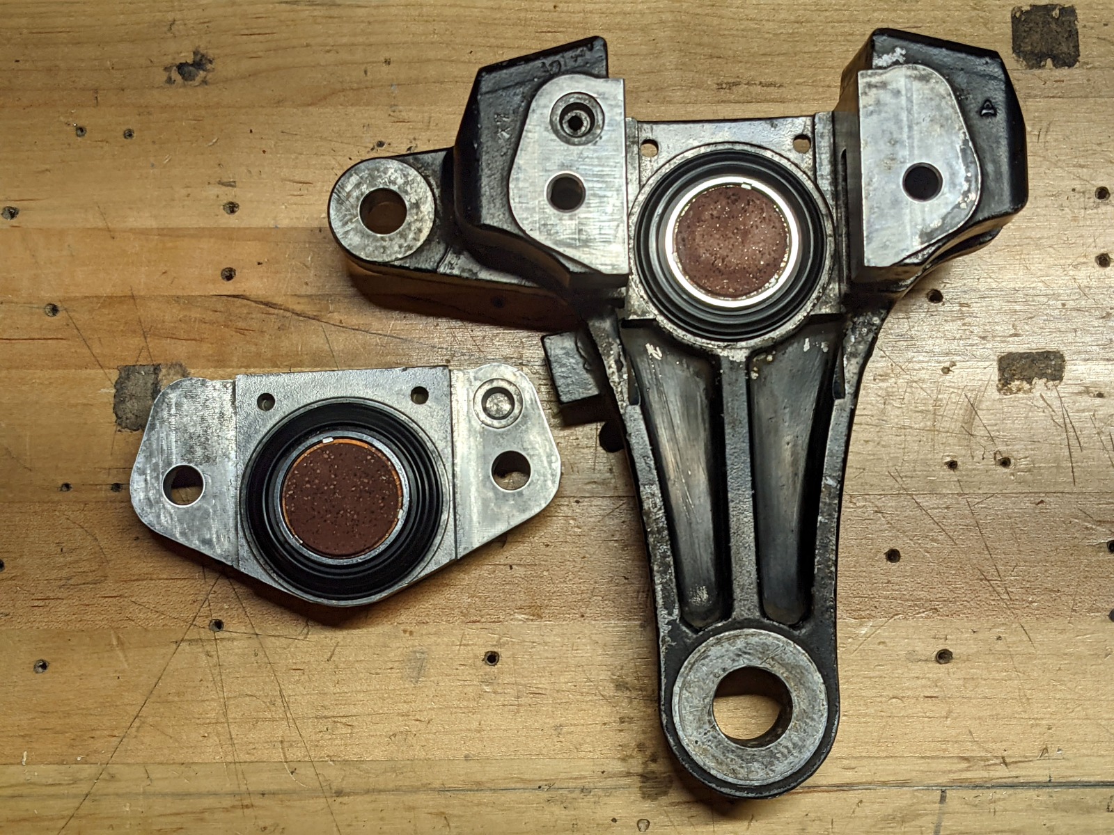

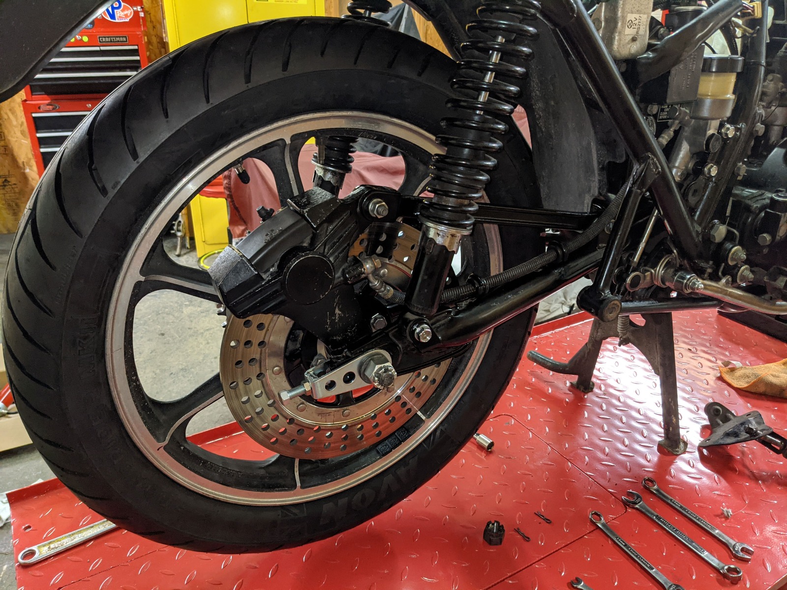

I’ve made a lot of progress. Let’s start with the brakes.
I didn’t plan to rebuild the entire brake system, but it sort of happened anyway.

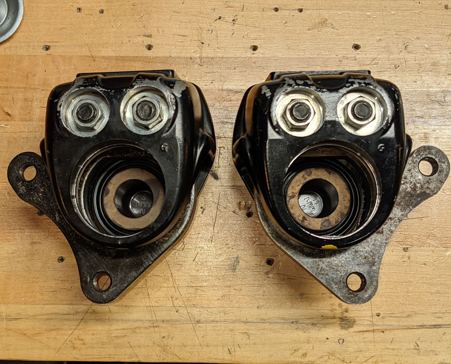

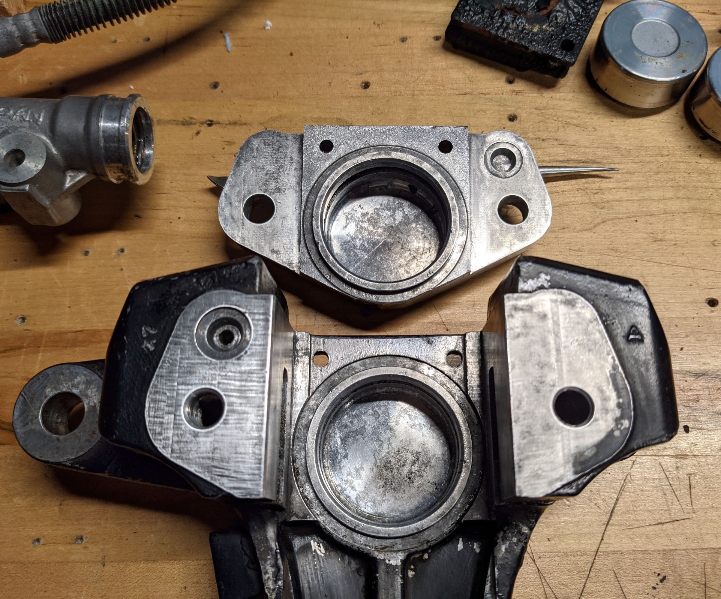

I had the rear wheel and swingarm off, so I had the idea that I would remove the rear caliper just drain to drain all the old fluid out, then put it back on and bleed it. But when I pulled it off I found two things. First, one of the two bolts that holds the caliper halves together was about half-way out. OOPS.
Second, it was clear the seals were leaking and the pads backing plates were rusty. So it all came apart.

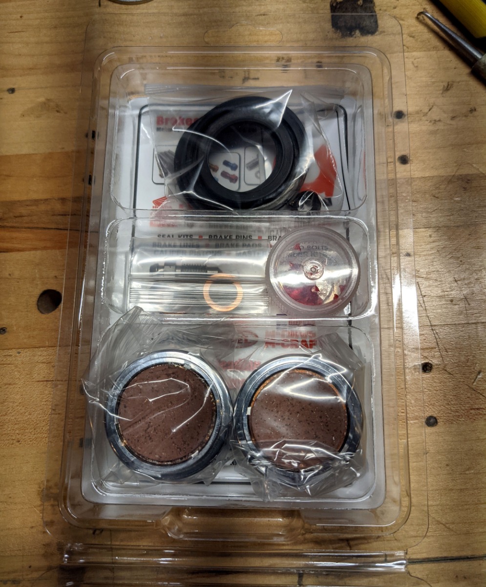

Based on recommendations here, I got a rebuild kit from Brakecrafers. I bought the later style 79-80 pistons with the insulating disk. I figured why not. I had two issues with the kit. It was missing the correct seal for the passage between the two halves, and the dust seals wouldn’t stay in place. It seemed like they were too small, and would just pop off of the lip on the body no matter what I did. I spoke with Brakecrafers and they were very eager to help sort it out. Absolutely an “A+” for customer service.
I had already ordered OE parts to replace the kit parts before I spoke with them, but he assured me that the dust seals in the Brakecrafers kit were identical to the current OE parts. This appears to be correct. The OE part I later received looked identical. I ended up cleaning and reusing the existing dust seal, which were fine and did not pop off.

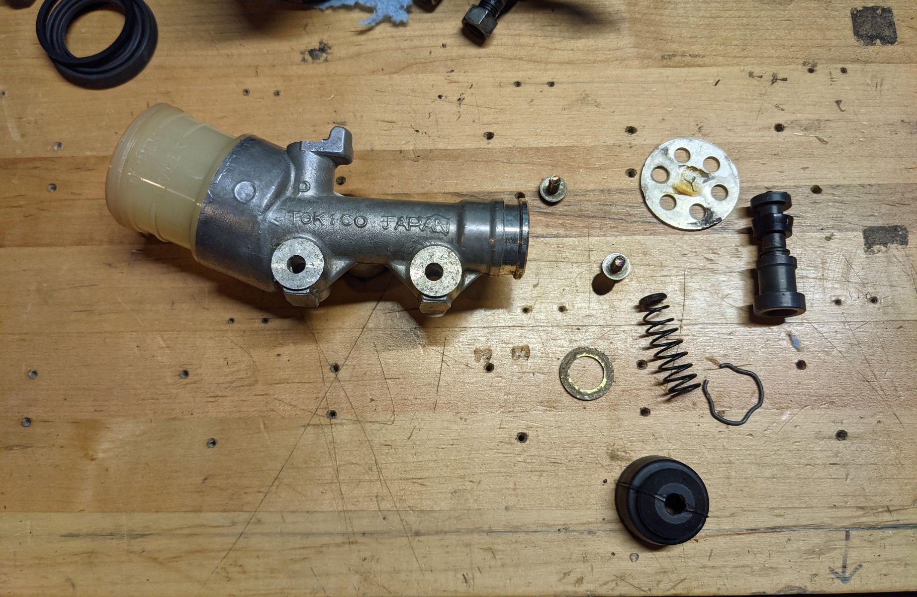

And for good measure, I also rebuilt the rear master.
I used an aftermarket kit from Z1parts.net instead of the OE parts. The piston wasn’t quite as nicely made as the OE part, but it looks like it will work fine.
z1parts.net/kawasaki-rear-brake-master-c...r-repair-kit-kz1000/

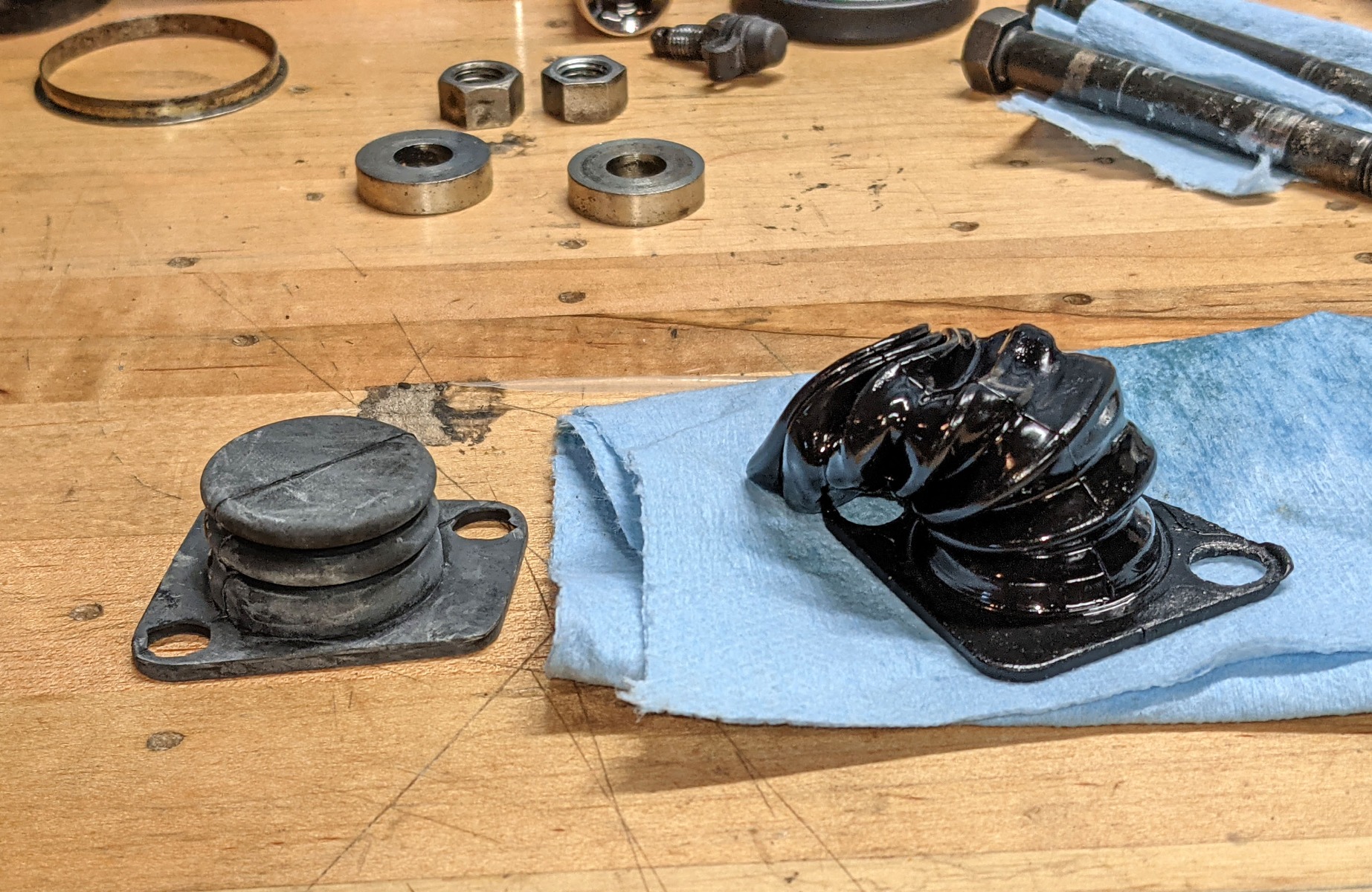

The last piece was the rubber diaphragm for the front reservoir. I was aware that this was basically useless 10 years ago, but I couldn’t find a replacement. Then a guy in Australia reproduced them.
kzrider.com/forum/5-chassis/569907-z1r-f...tute?start=12#644099
So I replaced my wet noodle with a new part. In my opinion, the reproduction is much too thick and should be more flexible. But it will at least keep the air and water vapor out of my fluid. I figure if I keep it topped off it doesn’t need to flex very much.

Nicely done! That cylinder looked terrible in the first photo. But it cleaned up pretty well.

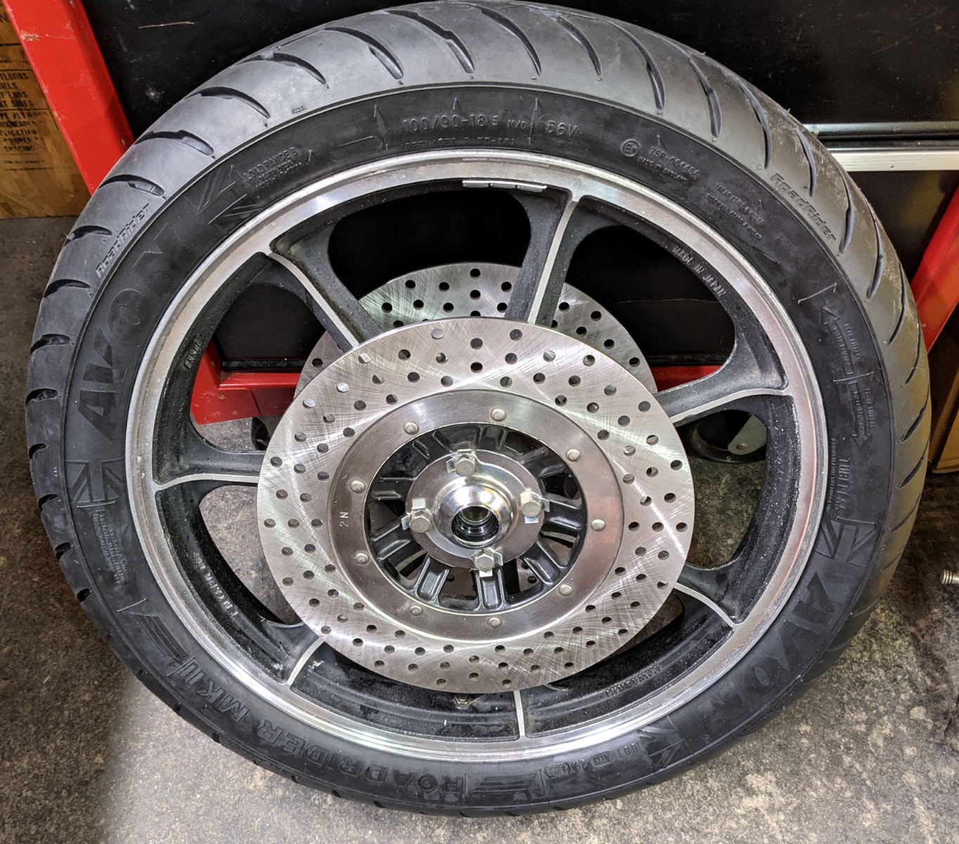

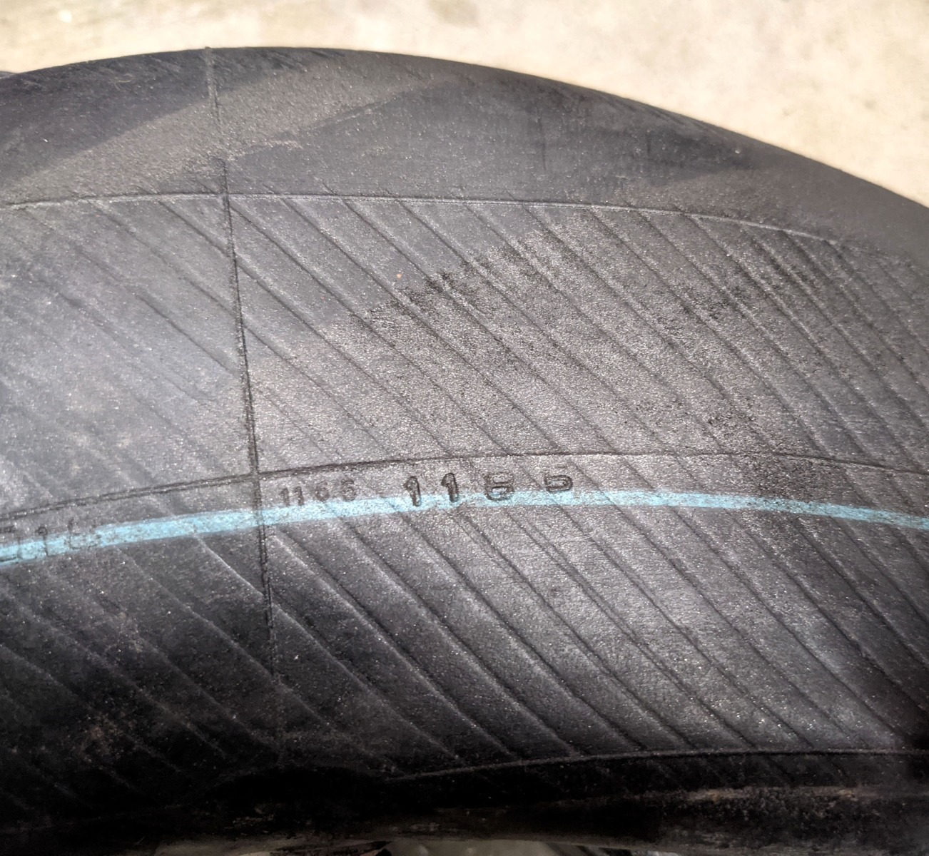

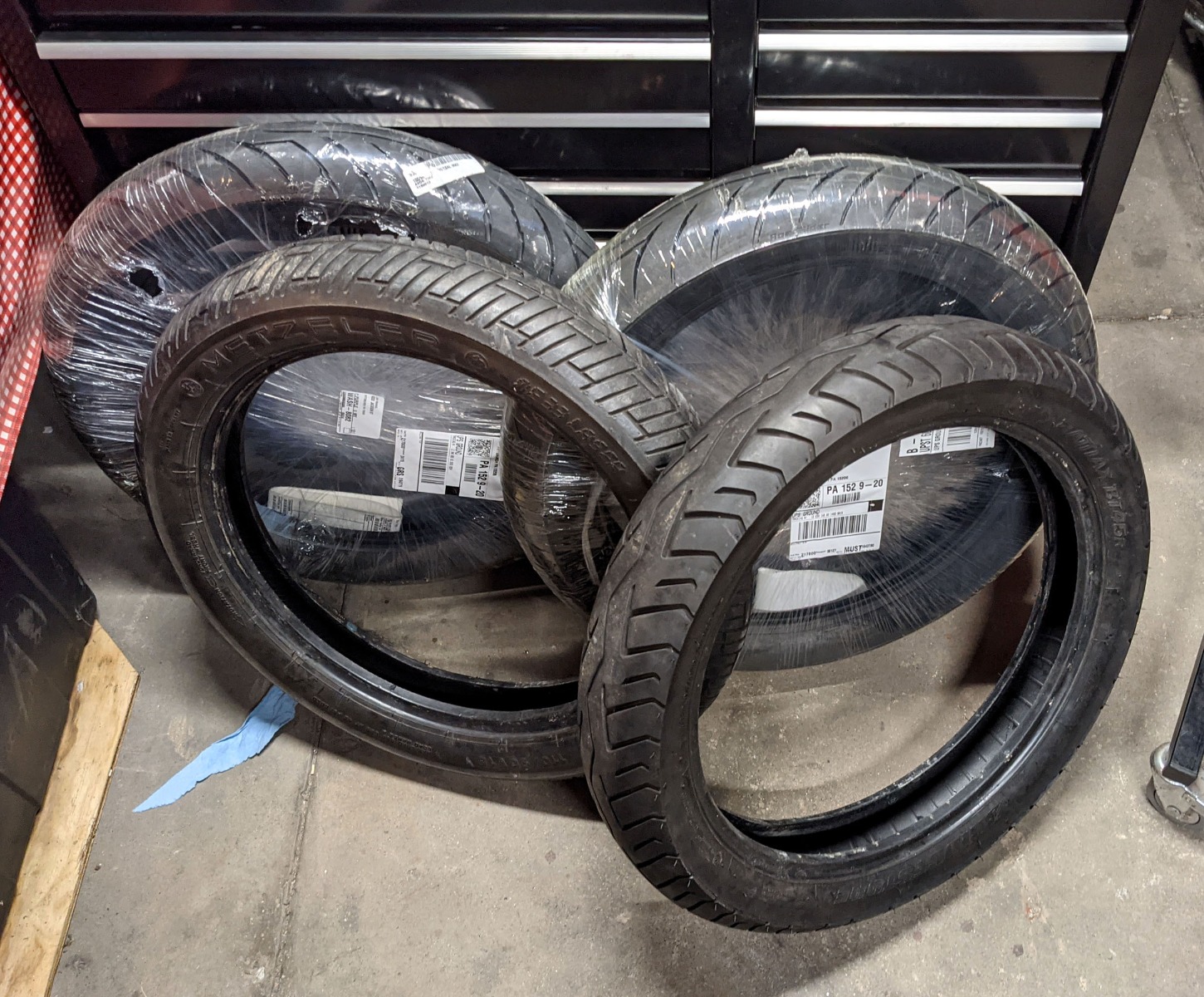

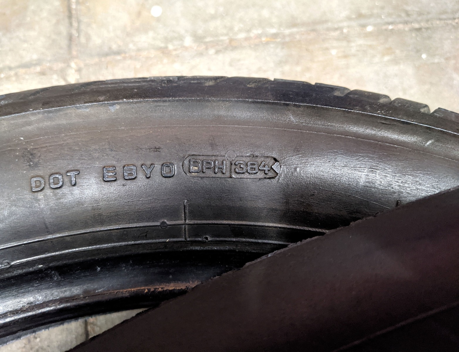

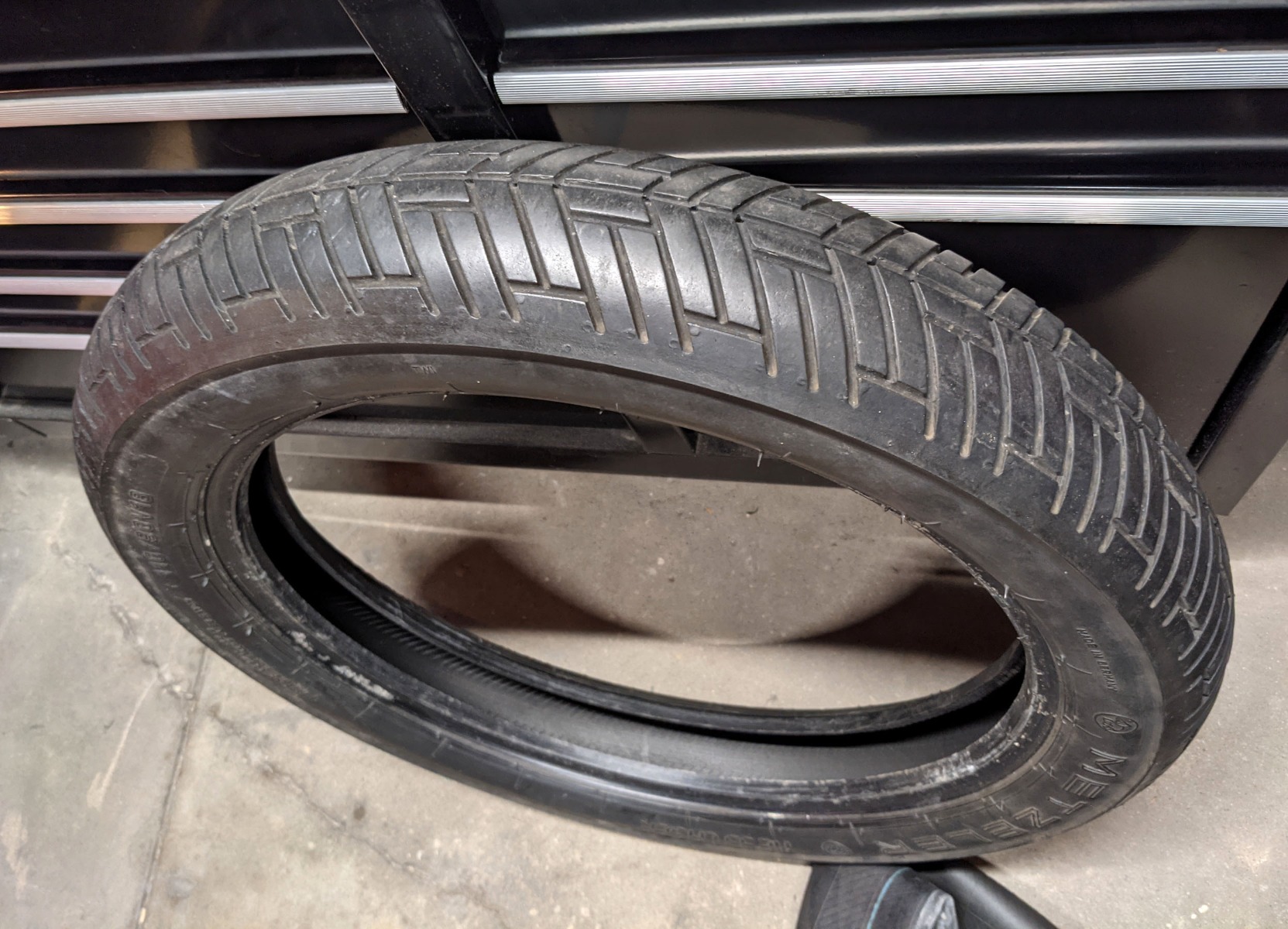

Next up is tires. I replaced the rear tire when I rebuilt the bike in 2008. Initially I used a Dunlop, maybe a k491? It was a 130 size, maybe 130/70-18. It turned out to be too wide, and rubbed a big slot right through the inside of my chain guard before I realized it was touching. That made me grumpy, so I swapped that for a Bridgestone BT45 in 120/80-18. That size fits fine. The front tire on the bike when I got it was a Metzeler ME33 Laser, which had plenty of tread on it, so I didn’t bother to do anything with it.
At that time I didn’t know anything about how tires age and get hard, or that they recommend you replace tires after 5 years. The date code on the ME33 was 384, which could be the 38th week of 1994, or 1984. The tube inside had raised numbers 1185, which might be 11th week of 1985. In any case, that tire was waaaaaay over the 5 year mark. Sometimes I’m not as careful as I’d like to be. The rear tires dates from 2008, so both of them were done. Look at how shiny the sidewall of the Laser is.
I was happy with the BT45, but many folks here recommend the Avon Roadrider so I wanted to give those a try. I was also tempted by the new BT46, so I went around in circles for a while.

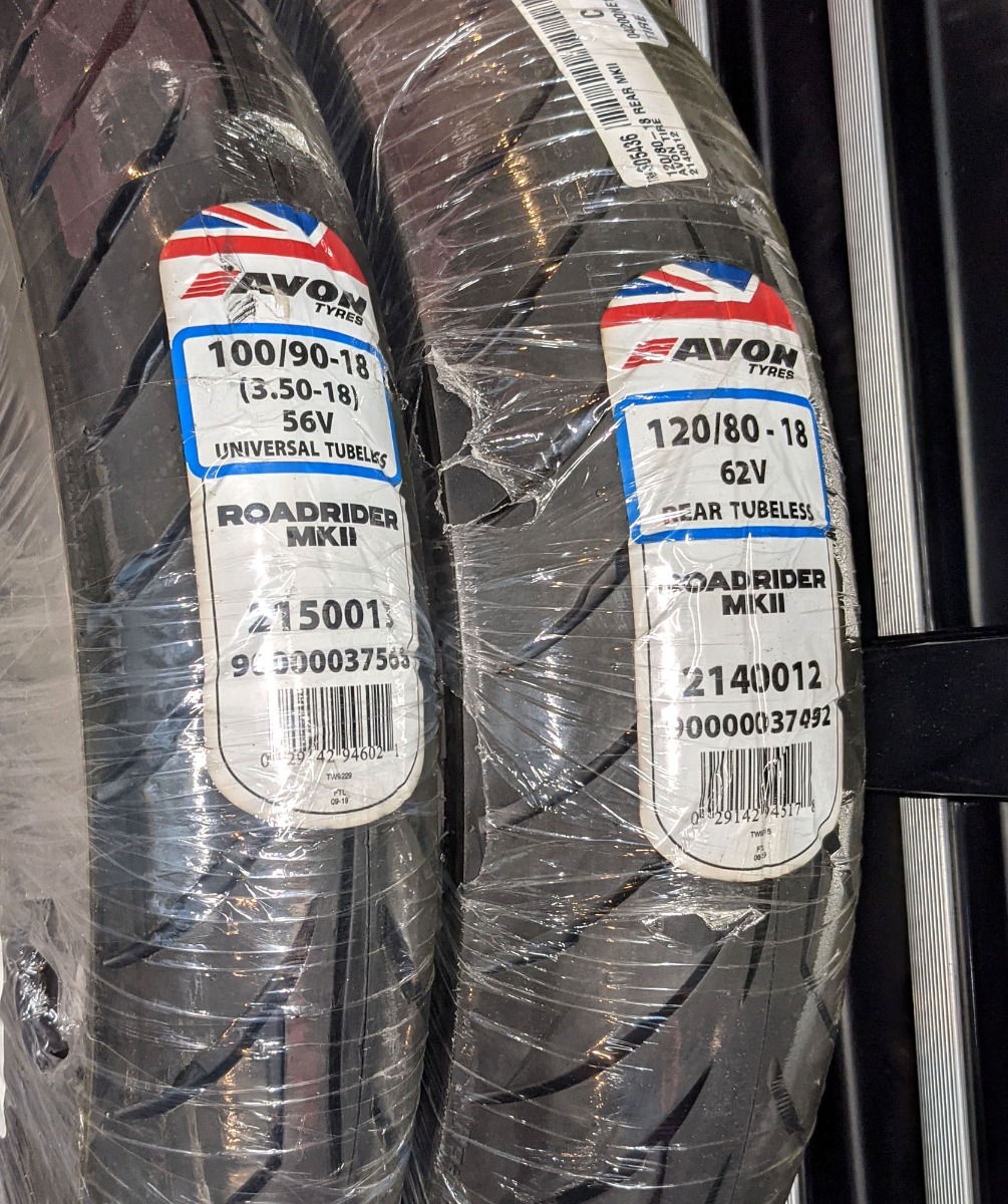

Trying to figure out the correct size is tricky. The OE tires were 3.50-18 and 4.00-18. That would translate roughly to 90/90-18 and 100/100-18. But I don’t have any vintage tire measurements to confirm that translation. If you look at modern tires, it’s clear that the relationship between the “size” and the actual measurement is only approximate, so it’s hard to guess the actual size of the OE tires.
A few manufacturers sell modern tires in those inch sizes, so I used those for as a reference for dimensions. For example, the BT45 3.50-18 is actually more like 104/97, and the BT45 4.00-18 is a 119/108. The Roadrider 4.00-18 is 116/107, so similar, but both are far away from 4” (101.6mm).
There are two reasons I spent so much time thinking about this. Ok, three: This is just how I spend my time. But the first reason was that like everyone else I want to run the widest tires that fit, but the front tire I had was very close to the fender so I was worried the wrong front tire might be too wide or tall, and in the back I already chewed up my chain guard so clearances were tight all over. The second reason was that the Z1R has less trail than any other KZ1000, and period articles were critical of the steering. I had been running a tall front tire and a short rear tire, how tall and short is hard to tell, but pretty clearly different from the OE tires. I had no issues at all with the handling of the bike, but also have no idea if that particular tire combination was helping to relax the steering angle and increase trail a bit.
Anyway, I got all balled up in this and went back and forth between various sizes of BT45, BT46, and Roadrider Mk2. In the end I got the Roadrider Mk2 in 100/90-18V and 120/80-18V. The sticker on the front tire actually says “(3.50-18)” under the metric size, which seemed like a good sign. We’ll see how it works out.
Then I needed tubes. Not much information is available for tubes. It seemed like Dennis Kirk had a good supply of the Michelin tubes, but I couldn’t find any info on the Michelin site to confirm the sizes. Avon is one of the few manufacturers that lists their tube part numbers and fitment.
www.avontyres.com/en-gb/tube-tyres/
In the end I got an Avon for the front, and a Michelin for the back.
Avon A18T325 and Michelin 39186.
www.denniskirk.com/535689.sku
www.denniskirk.com/535650.sku
I removed the old tires by hand with spoons so I could clean up the rims and the bead area, but I took them to a shop to have them put on. The tubes appear to be inside the tires now, so I’m guessing they fit.

It does seem a shame to toss tires with deep tread, but I beet that ME33 would be pretty exciting in the twisties.

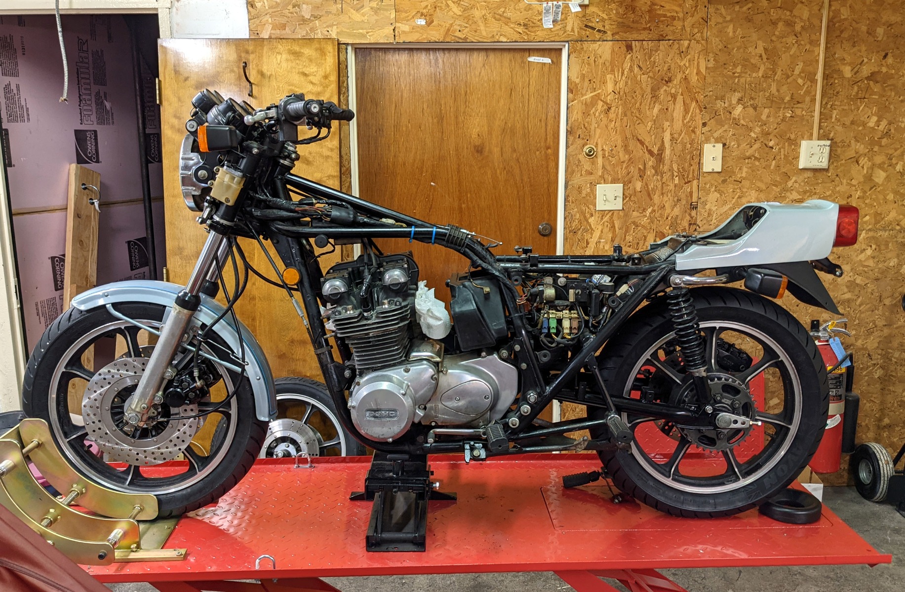

Ok. So at this point I’ll admit that I made a lot of progress and everything from here on is retroactive. It turns out my friend needs his space back, so I had a deadline of the end of July (now). So much for my really great shop space. Anyway, here are some more pics along the way.

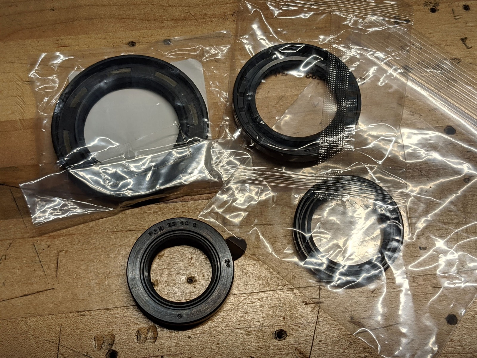

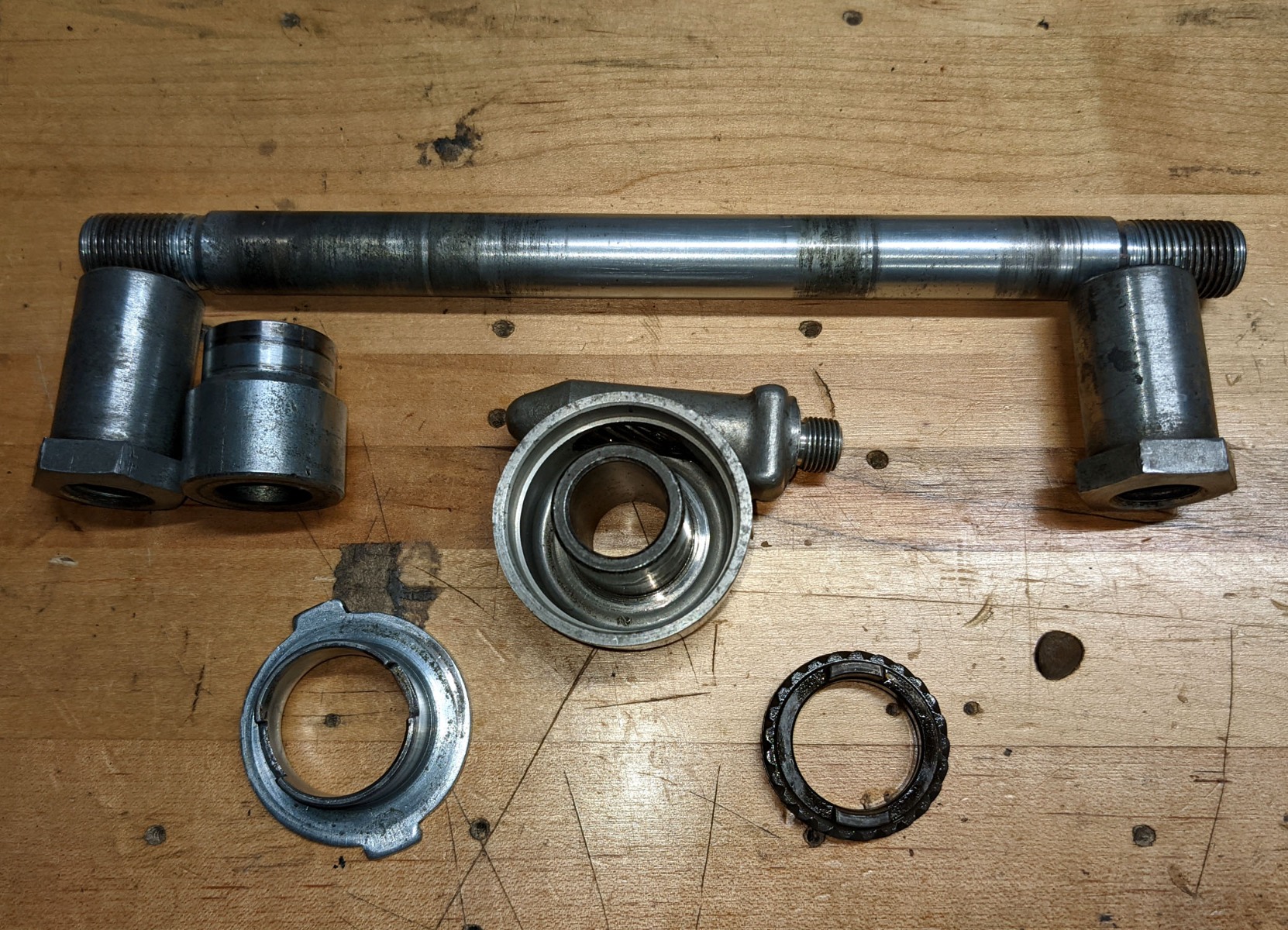

I cleaned the speedo drive and replaced all of the shaft seals on the wheels. Cleaning the speedo drive was very satisfying. It was gross in there.

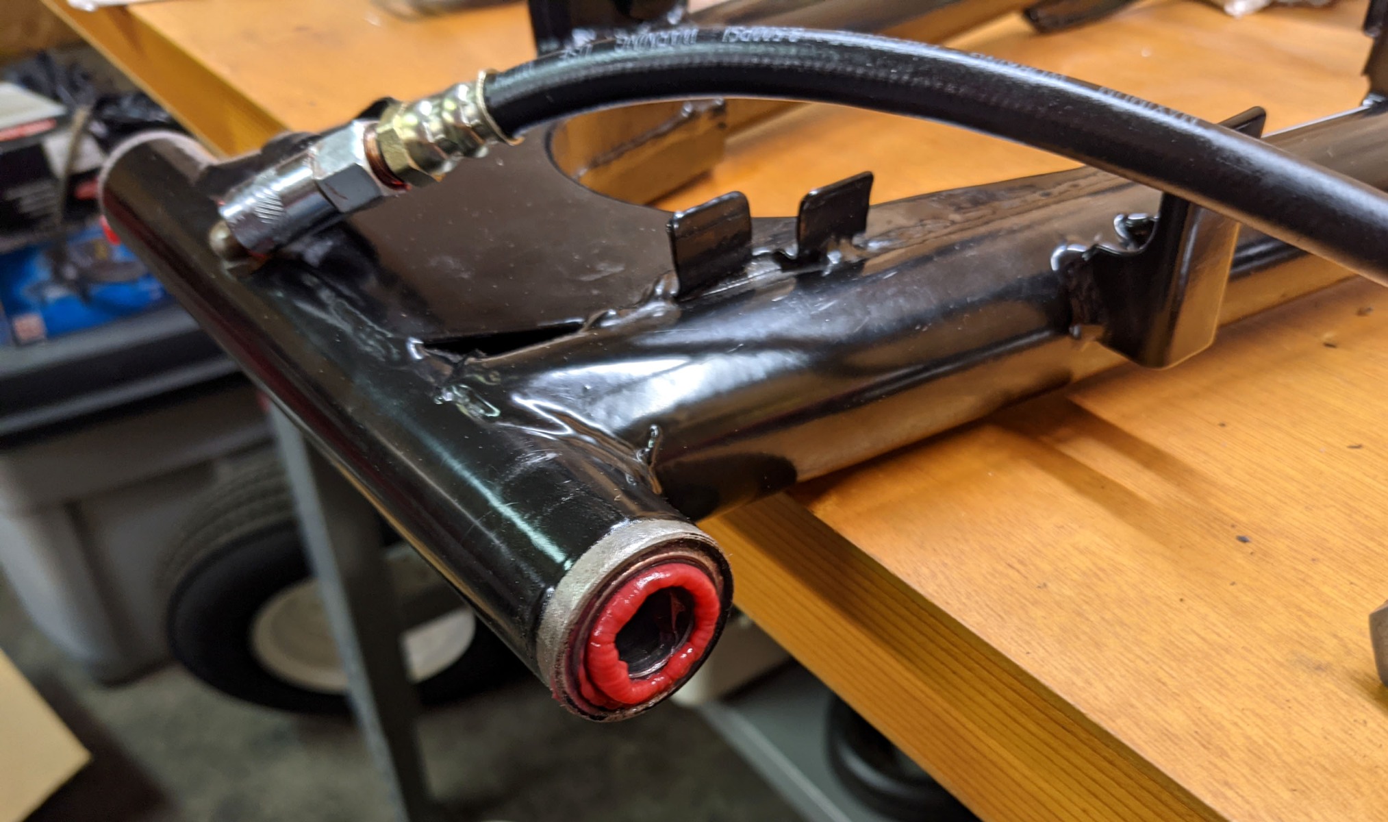

I pumped a bunch of new grease into the swignarm. Those bearings and shaft were all replaced 10 years ago. They still look nice.
Here is the whole rear wheel assembly back on.
Shiny disks on the front wheel, with new lock tabs. I also swapped the chrome dust cover for a nicer one.
Finally it has both front and back wheels, with brakes, after 2 years sitting on the lift.

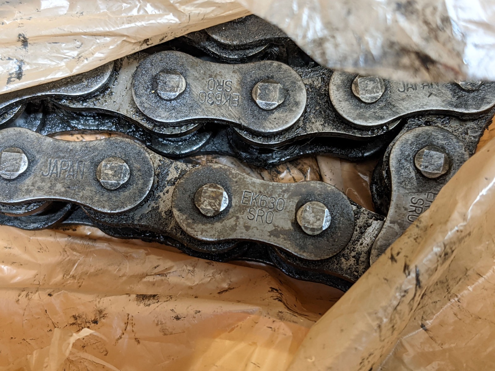

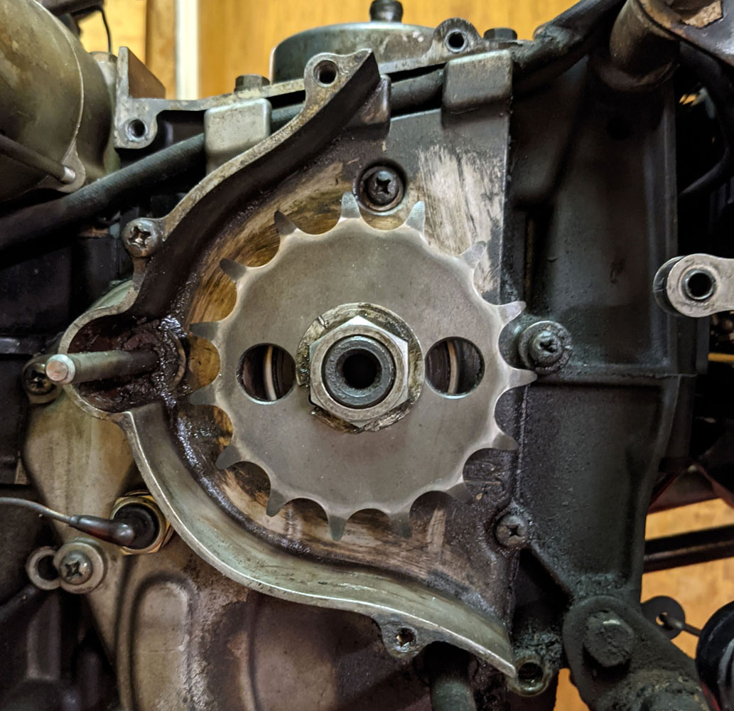

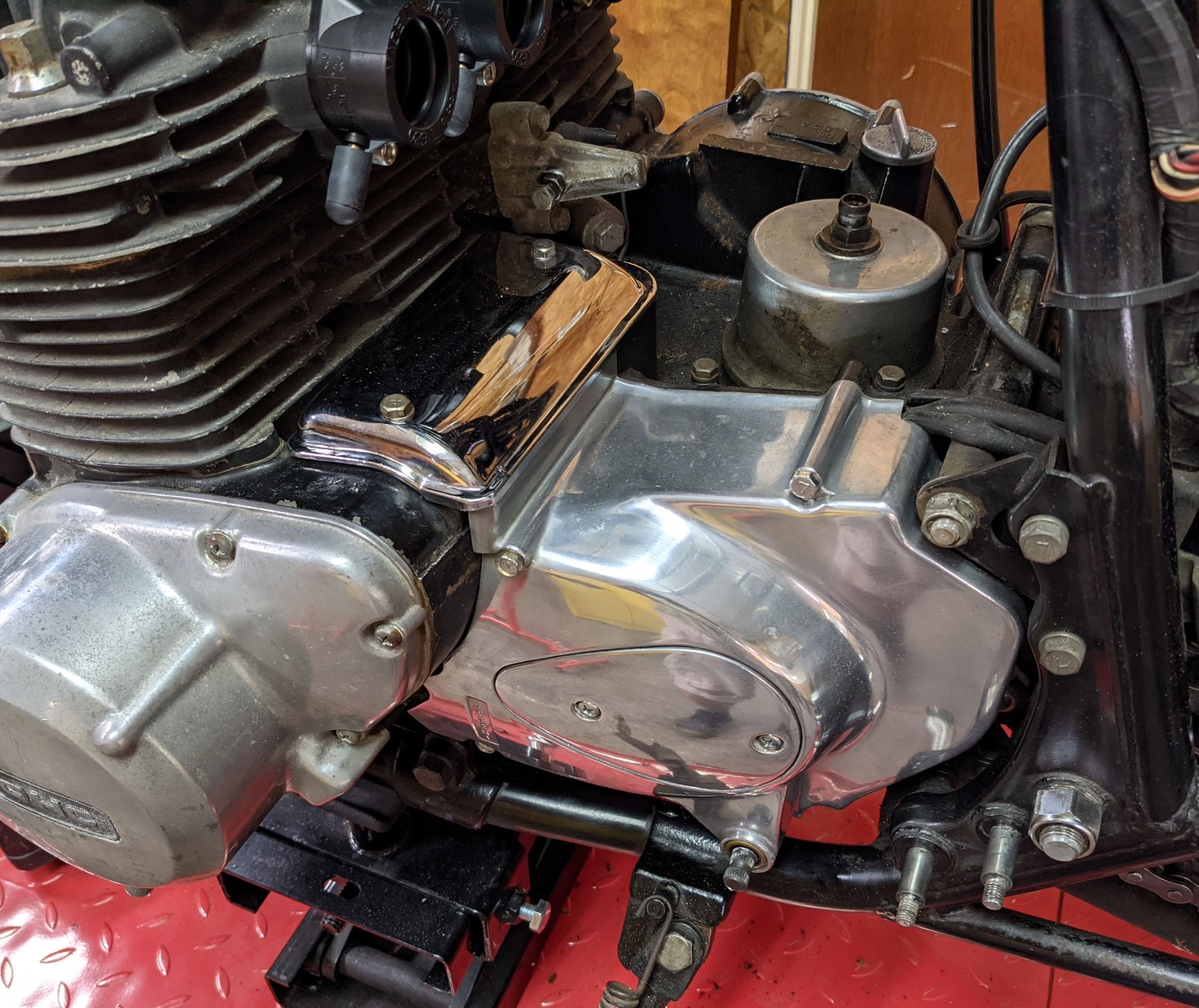

The next step was the chain. I pulled the sprocket cover and discovered my second loose fastener (the other was on the rear caliper bolt). The big nut holding the sprocket on was loose. Like wobbly loose, but the lock washer was still holding it in place. It’s not clear how the lock tab could still be in place and the nut that loose, but it doesn’t seem good.
I re-torqued the nut and re-bent the lock washer. I also noticed that the front sprocket is pretty worn.
The chain has also seen better days.
I cleaned it with chain cleaner and sprayed the heck out of it with chain lube. I used Maxima Clean-Up Chain Cleaner which is really stinky but worked really well. I also used a Simple Solutions Aluminum Grunge Brush, which also worked well. Both came from Amazon.
The chain looks much better, but it’s pretty much shot. A number of the links have a ton of play. However I was feeling pressed for time now that I had a deadline, so I figured I’d try to get a few more miles out of it. I had just but the wheels back on and I wasn’t excited about taking the rear back off to replace the rear sprocket. I did replace the master link. Maybe that helps?
I also did a quick Mothers polished on the sprocket and starter cover. There was a lot of gas varnish from gas dripping from the float bowls. Much better now.
