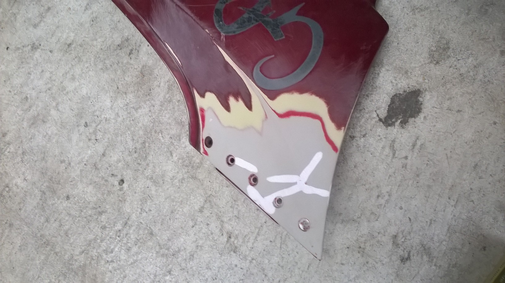

Had a few damaged fairing panels which I dropped off to the plastic welders to get sorted. Got them back today and well stoked, job is very tidy. Clever buggers.

10 Feb 2016 03:25
dang nice work!
