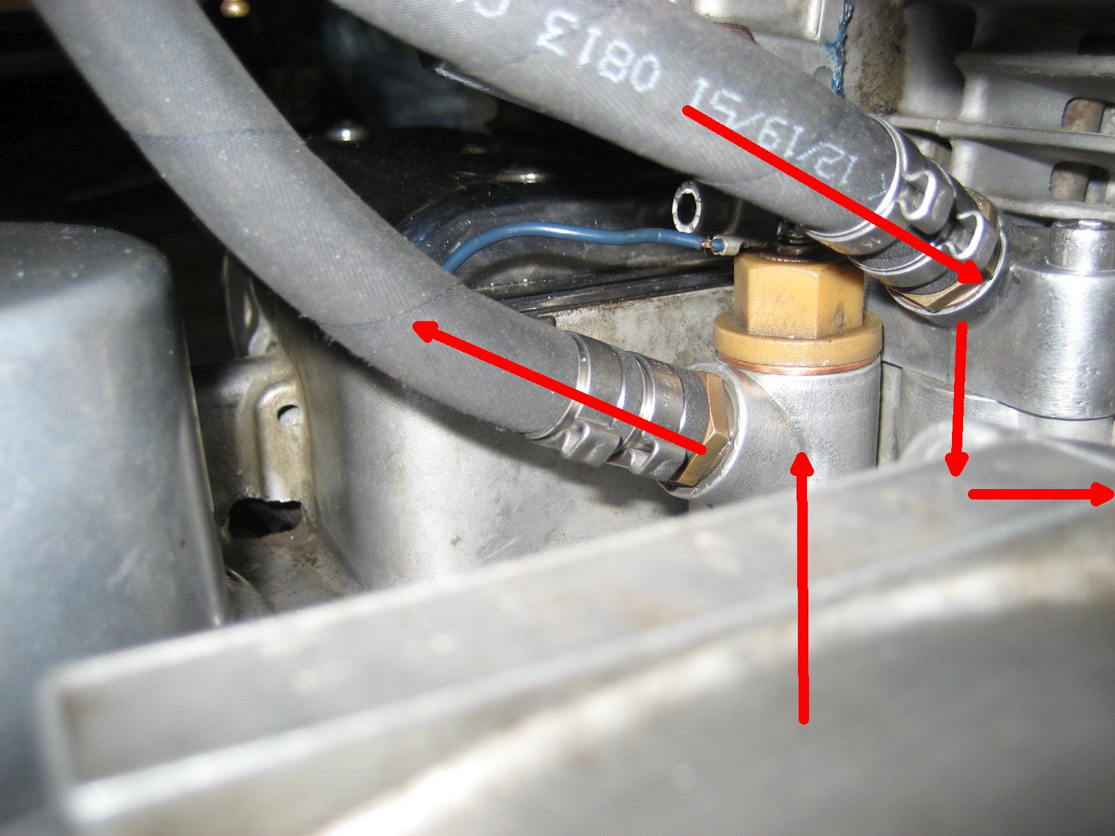

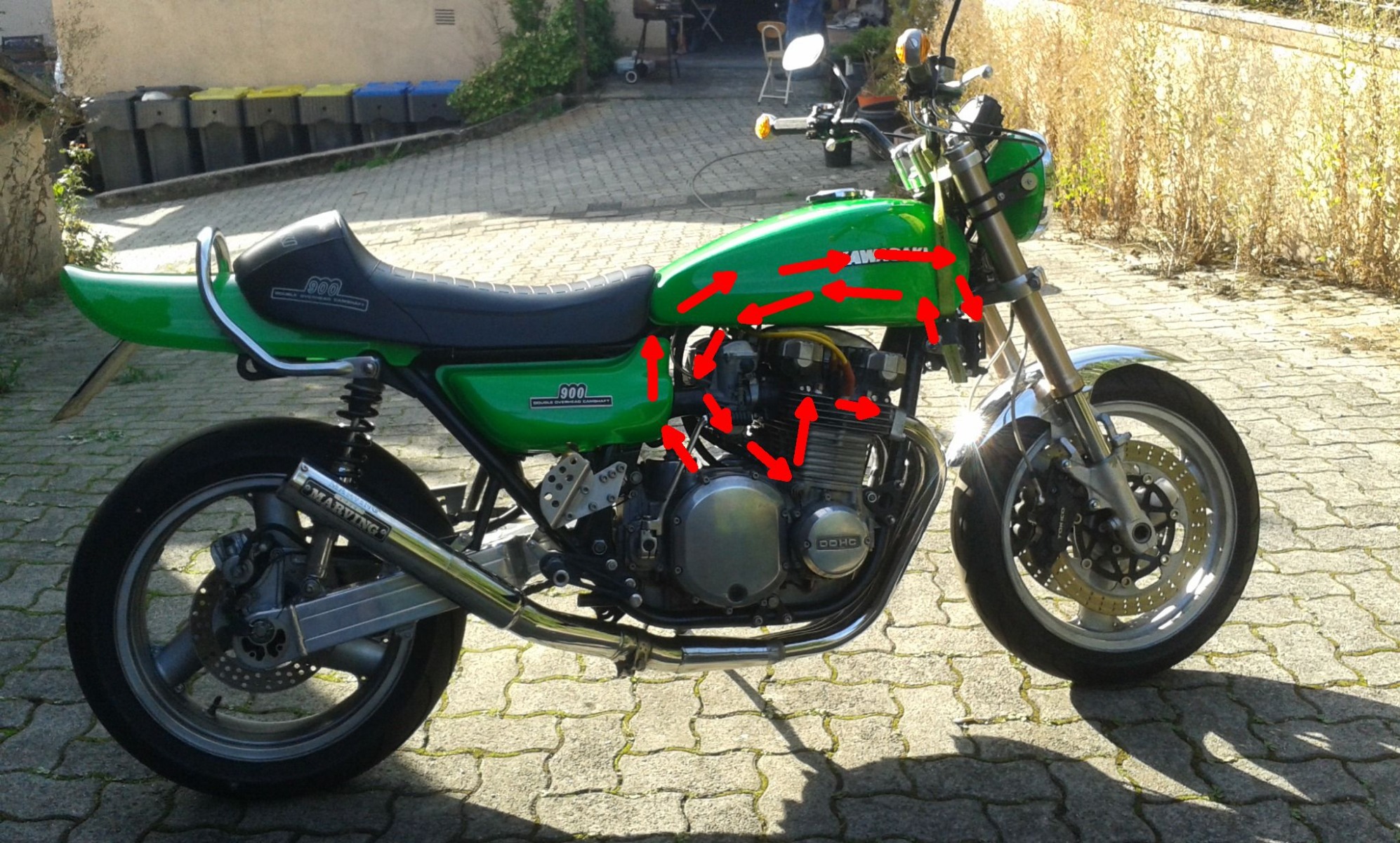

05 Apr 2023 05:29thanks I didn't know you could just add oil cooling to air cooled bikes

slmjim still has the first Z1 he bought; a late '73 build Z1-A. It has a few OEM parts on it usually associated with '73 Z1's, such as a throttle lock screw & earlier chain oil pump. He installed an oil cooler on it not long after he bought it. A problem with over-cooling during cool weather (40 ~ 50 deg. F.) rides that manifested as condensation (white glop on the sight glass) resulted in removal of the oil cooler & associated plumbing some years later. Lockhart made an oil cooler bypass / thermostat to help prevent the problem, but it added complexity to the plumbing and was just butt ugly anyway. Unless an air-icooled Z motor has been seriously breathed on or routinely run in sweltering desert conditions, oil coolers aren't really necessary anyway. At least that's our opinion.
