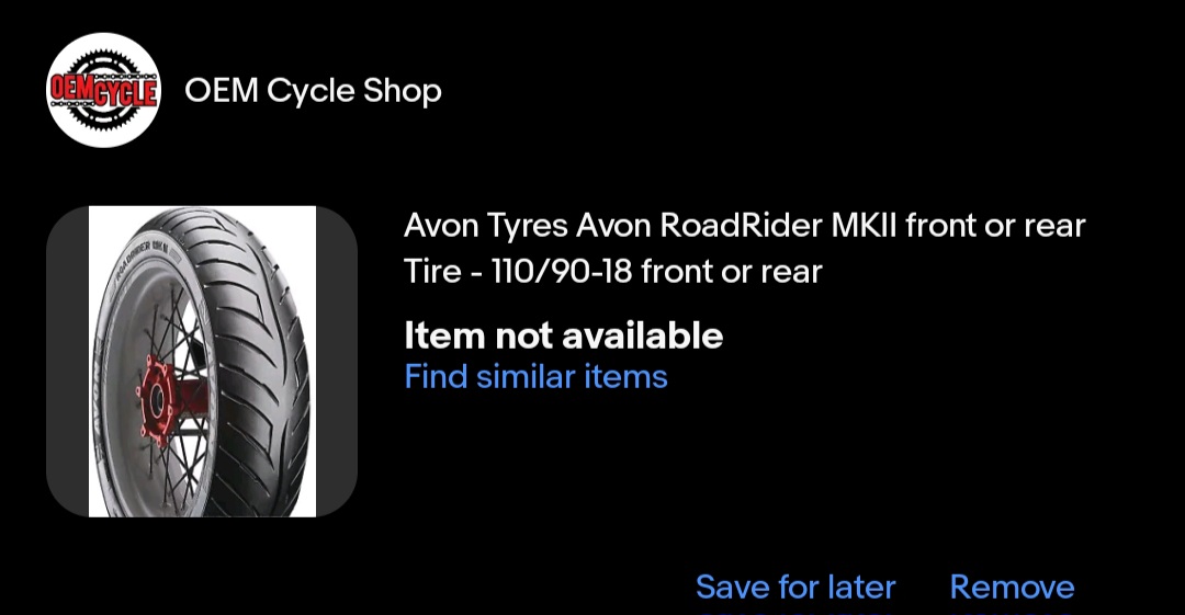

I'm planning on buying this particular tire. I know the size is correct but am unsure if it is for the front or rear - I guess I just need the size of the second tire (yes, I know I am super lame - for whatever reason I find tire size to be inordinately confusing - thanks for your patience!)

The answer is in the pic you posted. "110/90 - 18 front or rear."
If you actually have a 1974 KZ400D, I believe it came with 3.25 - 18 front and 3.50 - 18 rear tires. A 100/90 - 18 would likely be ideal, but if Avon recommends 110/90 - 18, then the mystery is solved.
