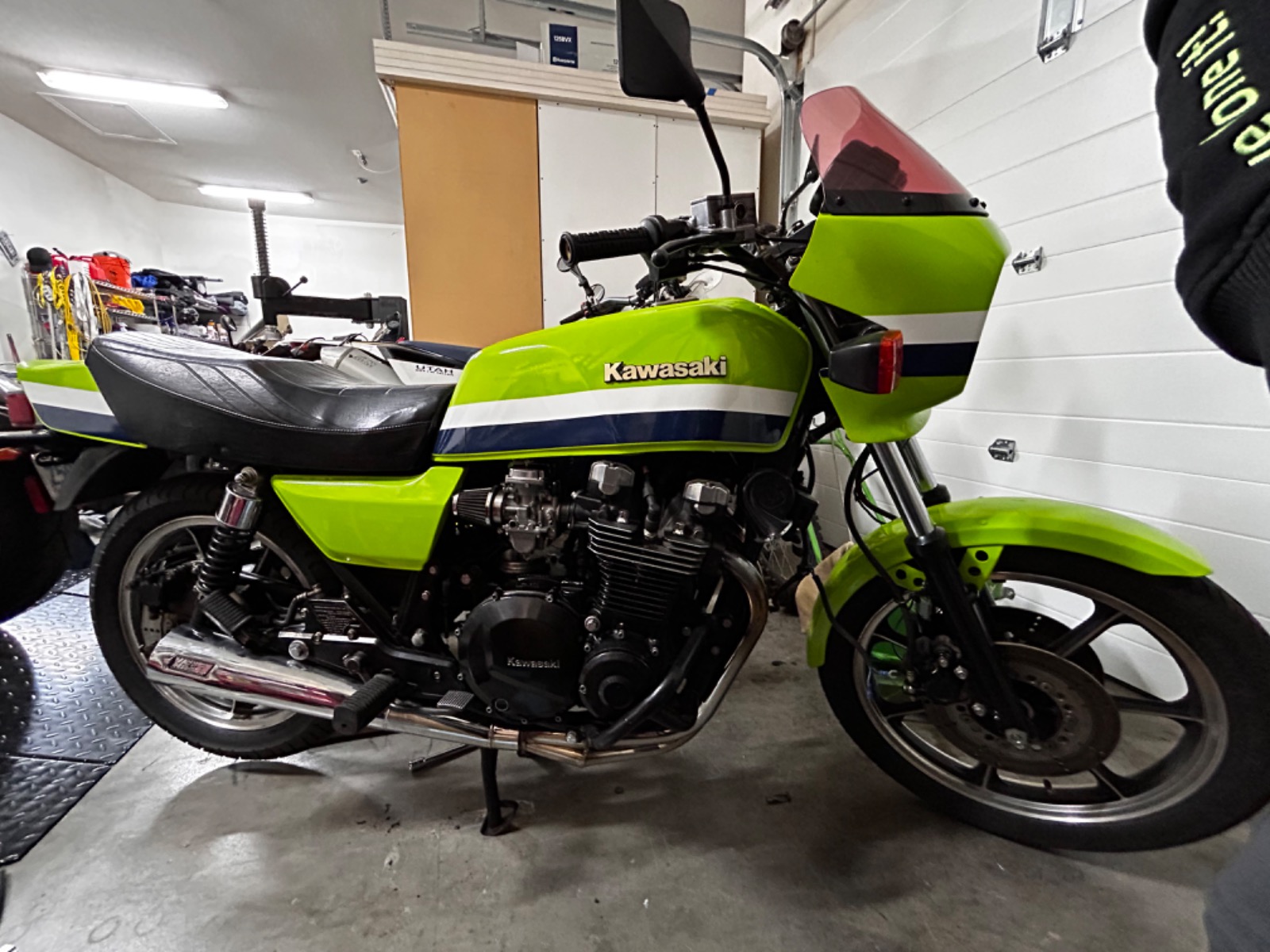

01 Mar 2026 05:59 - 12 Apr 2026 07:06Great tips, thanks!
Just starting down this road with a B1! Quite a bit of wrong previously done to it. 😜
