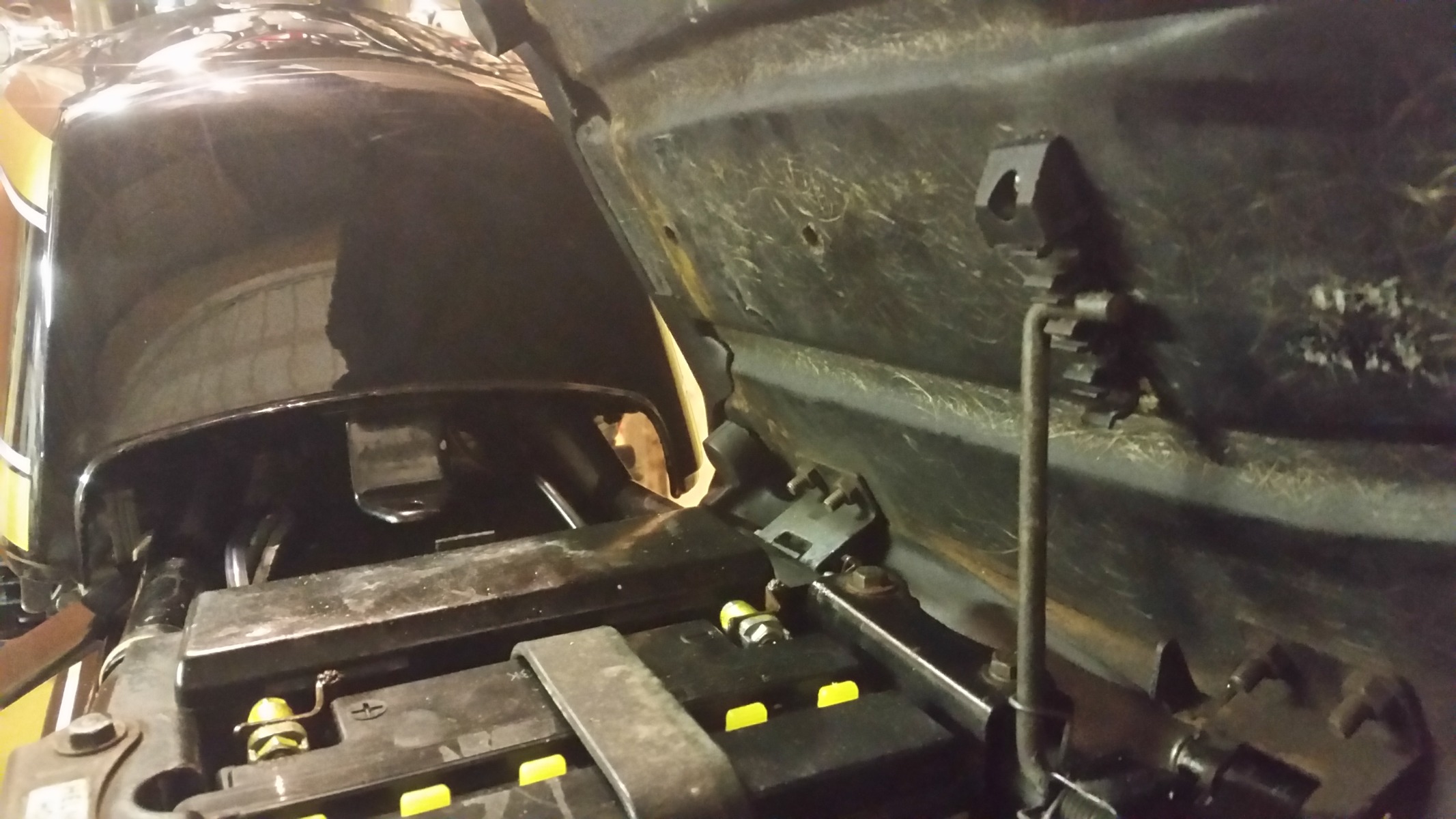

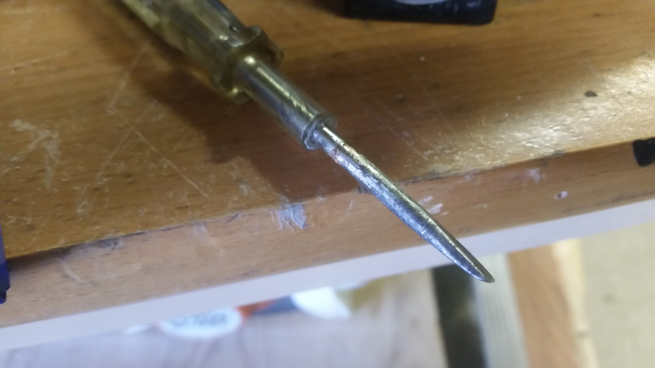

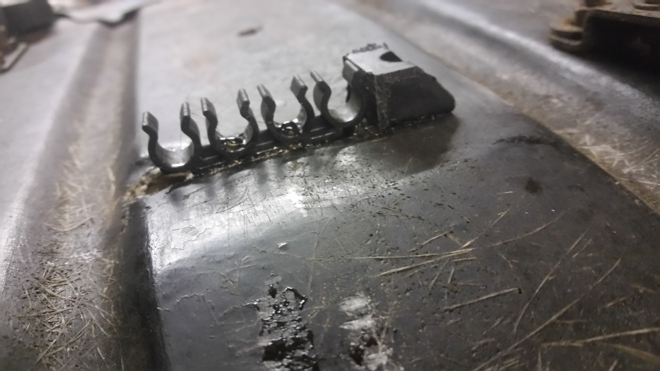

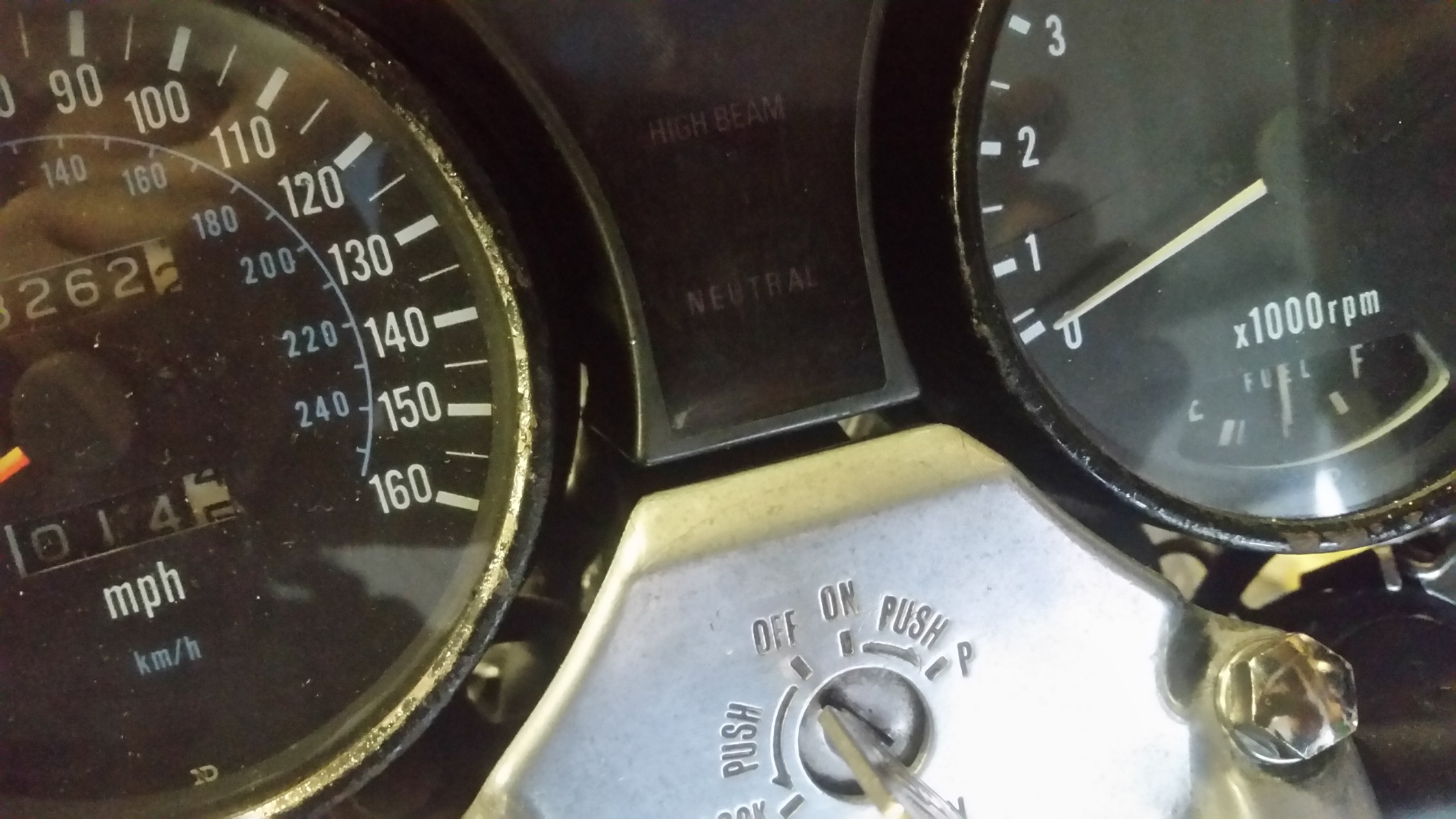

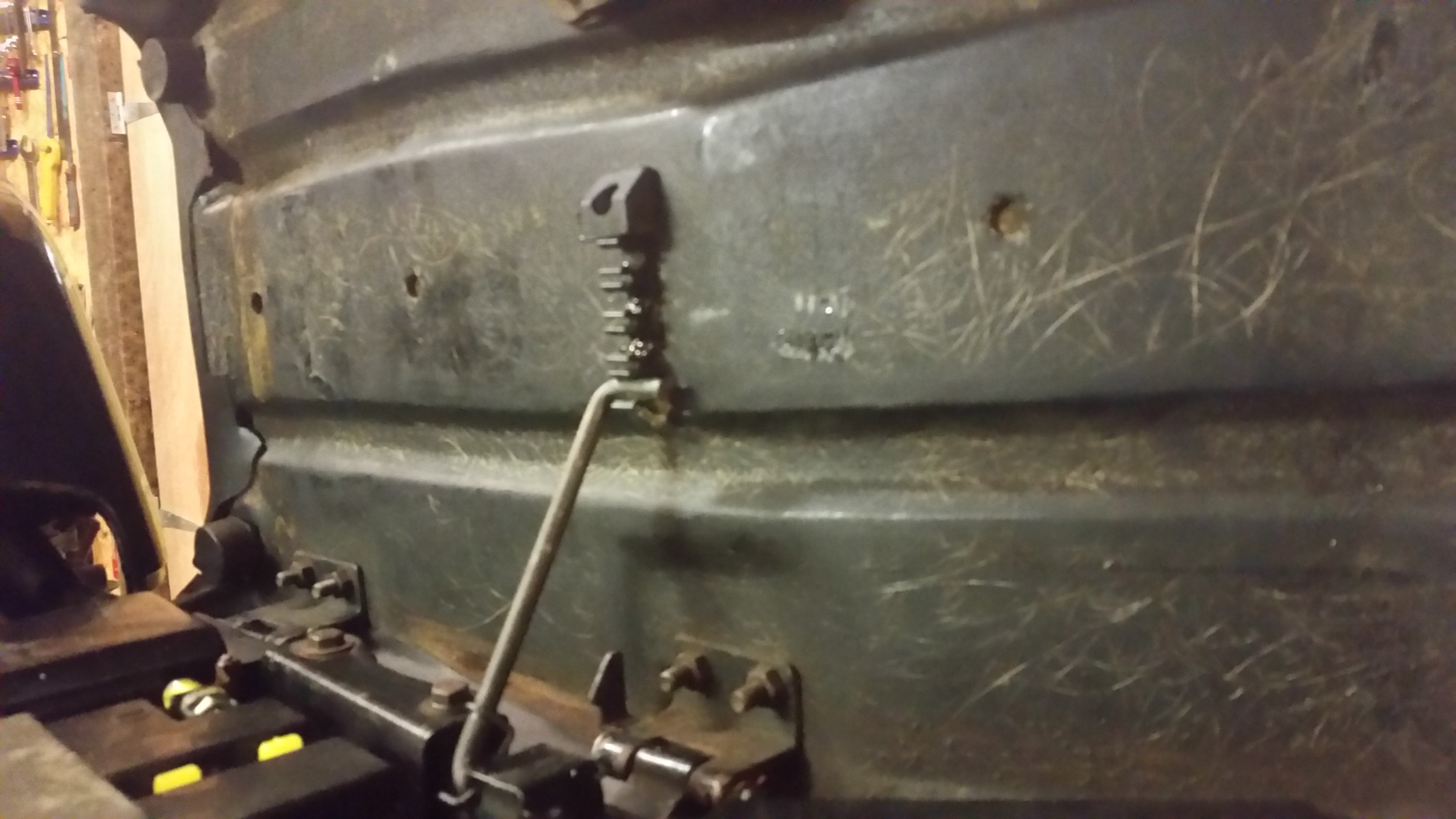

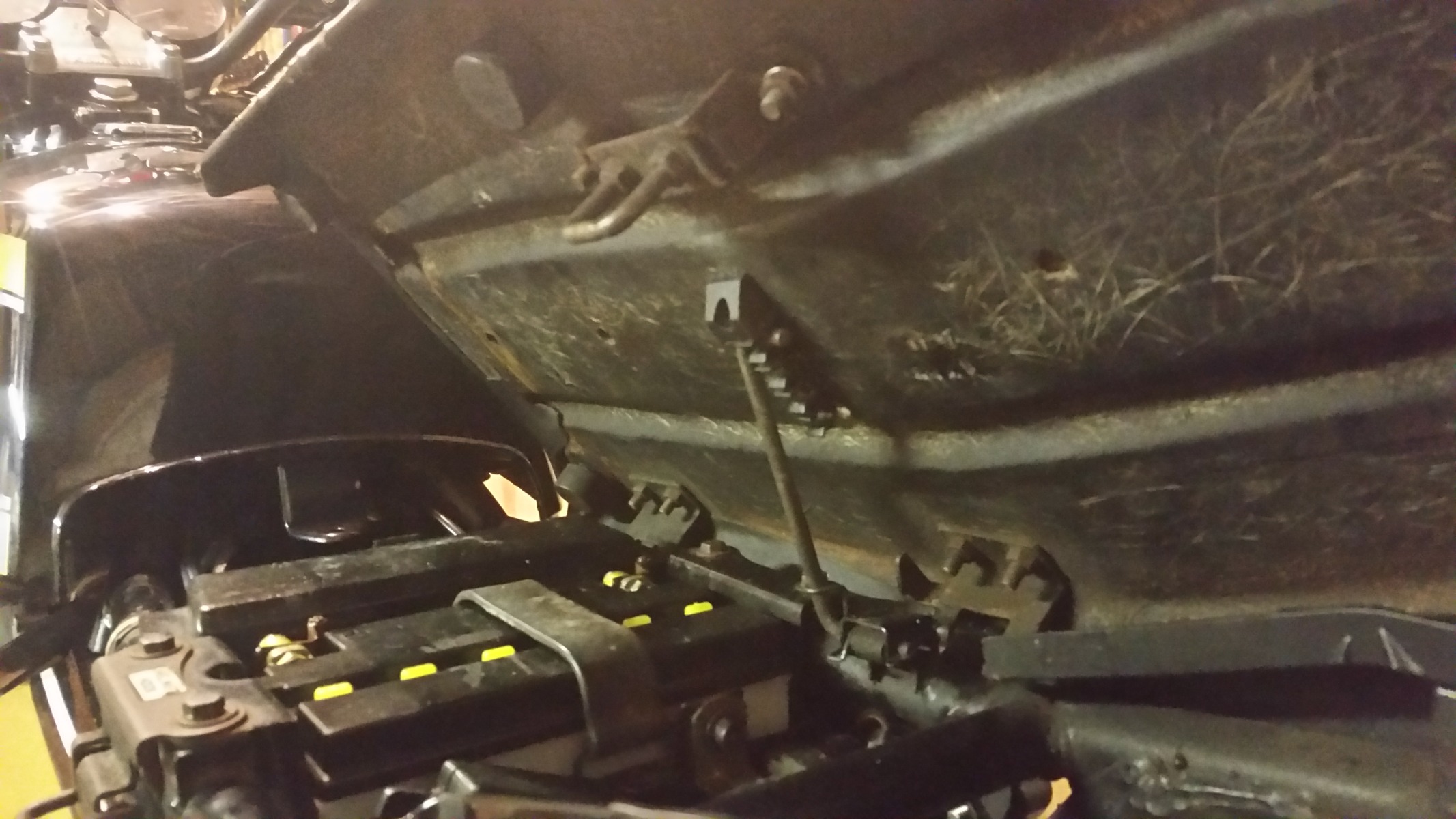

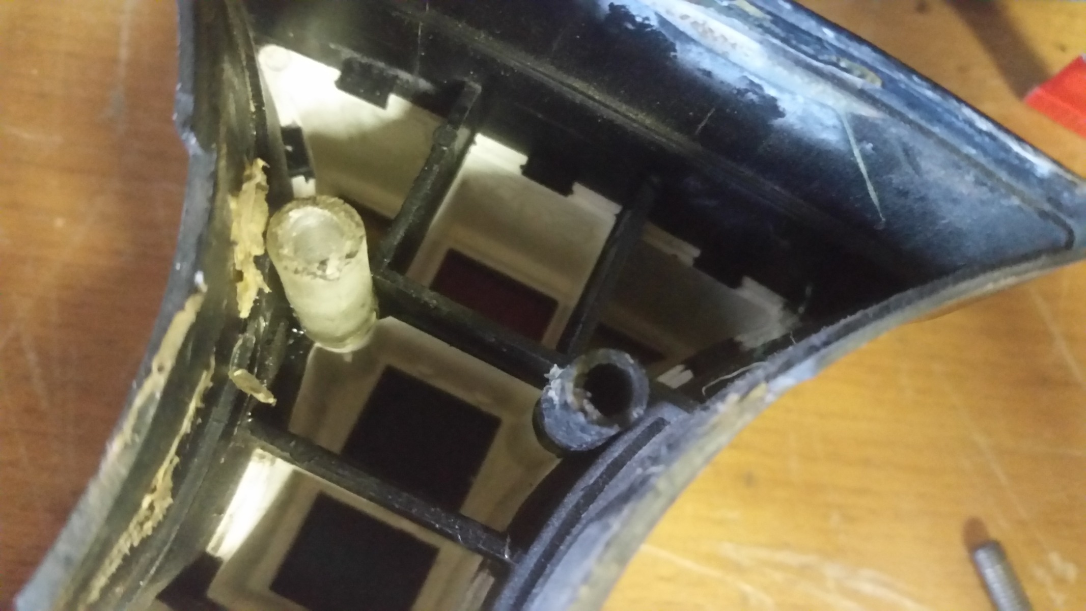

Hey everyone! Have any of you had the situation where there's little things wrong with your bike that you've ignored or just lived with for years then one random day you just say "I'm gonna fix this" ?! I've got two examples, my aftermarket seat didn't have any kind of catch for the sprung seat stay then one day I thought, that stay looks kind of H.T lead size so I raided my plastic clips box and pulled out an old Audi 80 lead clip ,and now I have an adjustable seat! And yesterday I decided to look at my loose warning light cluster that's always rested on the handlebar clamp, it's left hand bolt just went round and round, once I took it to bits I found one of its black plastic tapped tubes missing! So I took an inch off an old electric screwdriver, tapped it and glued it in place, now finally the warning lights are solid and sit right!!
I don't know about you guys but I find these little problem solving jobs SO satisfying! :laugh:
