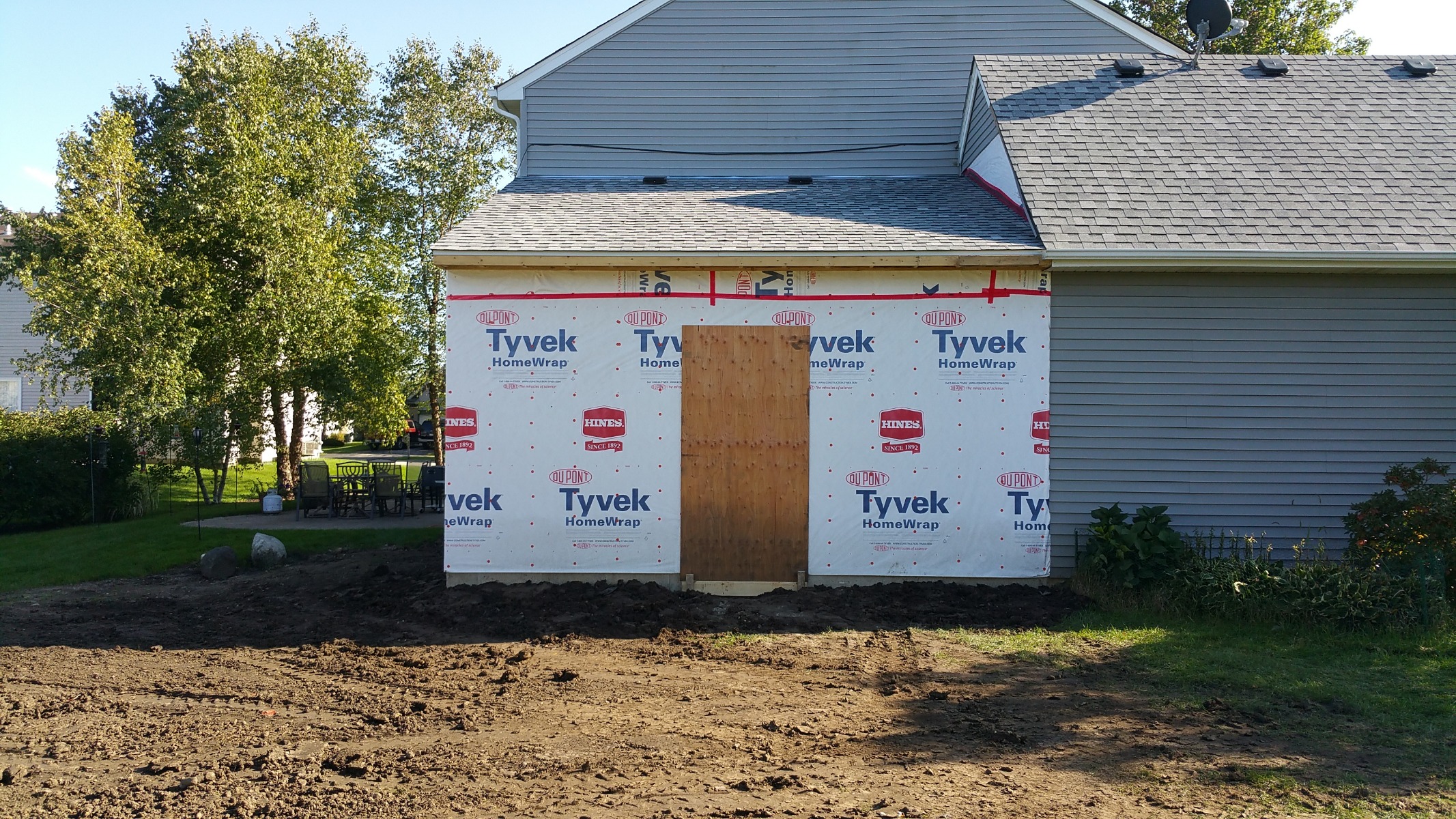

Today my foundation guy did the following:

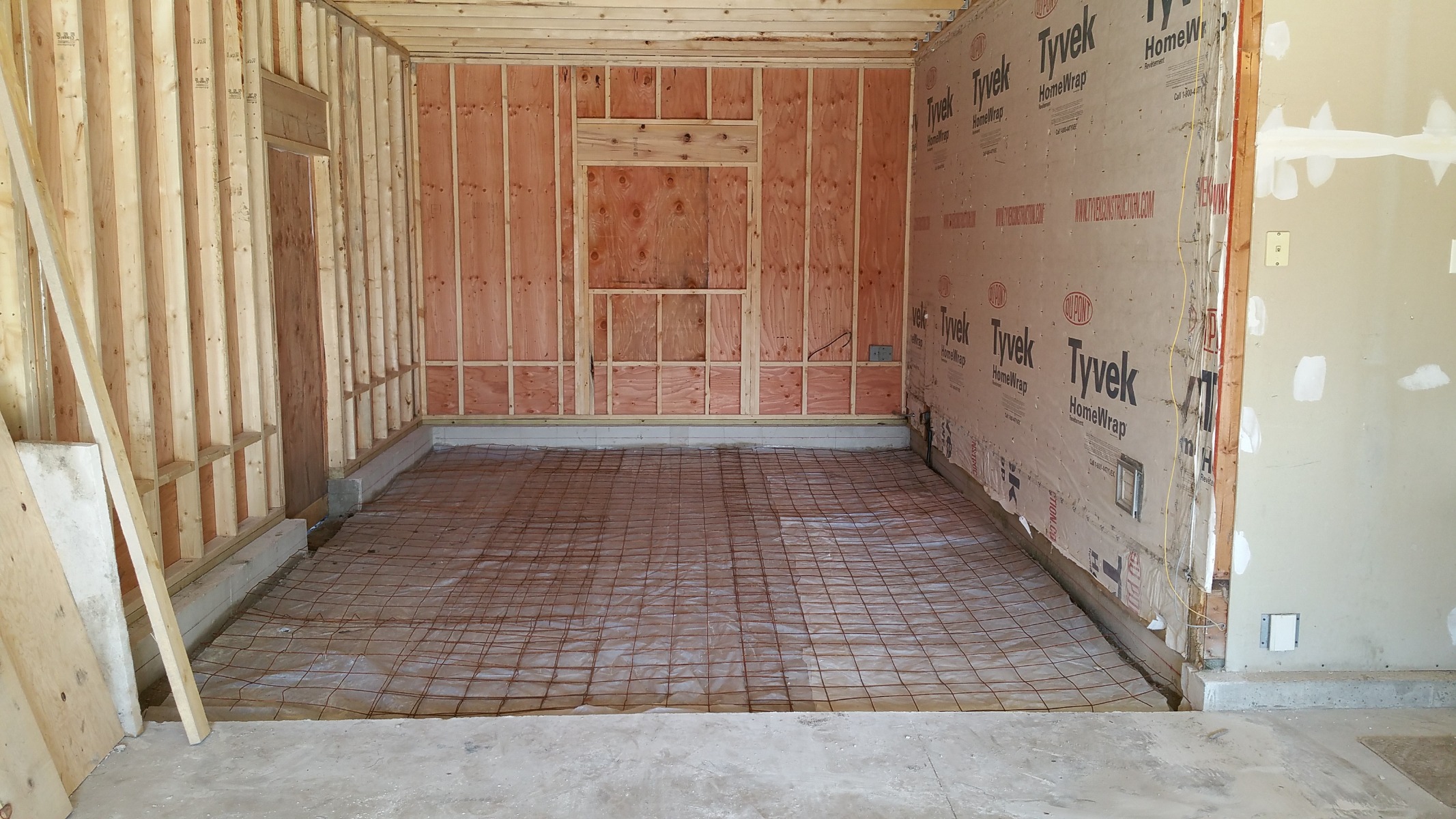

Cut out the gas curb to make one continous floor with pre existing . He leveled the substrate, put plastic down and then steel mesh. Tomorrow is the floor pour!
Here is the exterior with the shingles on roof.
Also used some of the left over soil spoils to level a low spot in the yard.

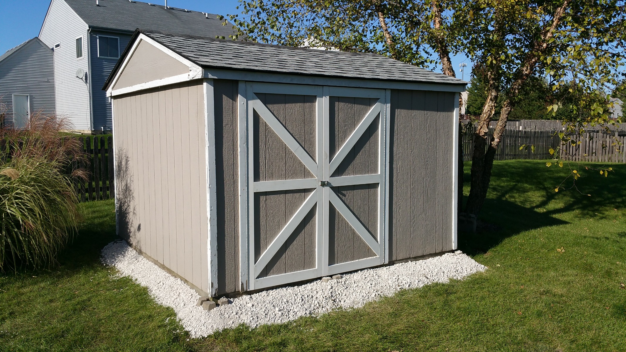

This shed was in the location where the addition is going in. Did not want to give up the storage space of this 10' x 10' shed. Moved it out into my yard.

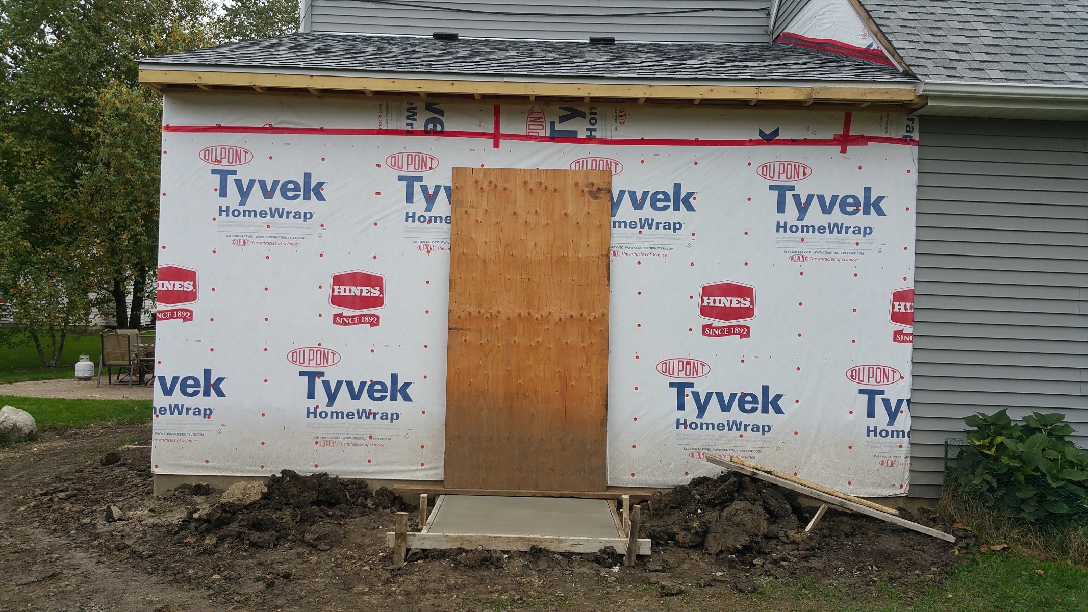

Yup, re using as much siding as possible. More siding needed, believe it or not! Carpenter is going to finish when he comes back for the soffit, gutter, drop down ladder etc.. He has ordered more siding. It will go where the color match is least noticeable.... hopefully. Foundation guy did put in rebar as well as mesh for the floor. Building inspector did his thing and approved the main floor area but forgot to have a concrete pad put in for the side door. Village requires a proportionate concrete pad consisting of 4-6" of stone with 4" of concrete. This for just a 36" X 36" door pad. Foundation may not get poured until next week. I am asking for this week. I want to coat the new and existing garage floor before moving everything in. The concrete needs to cure for 30 days according to the coating guy. I sure hope I can get my equipment and bikes in before the snow flies! :pinch: :whistle:

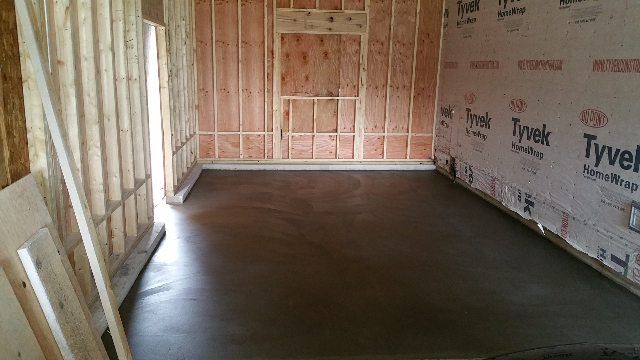

Floor poured and smoothed yesterday.
Side door pad poured withe light texture for grip.

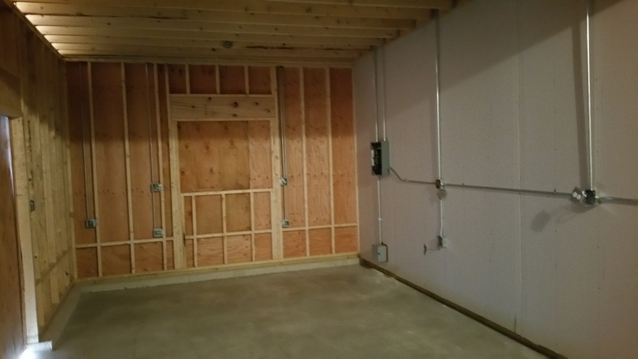

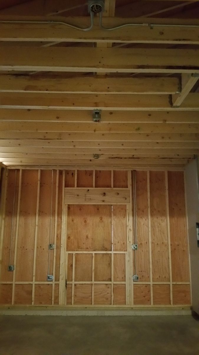

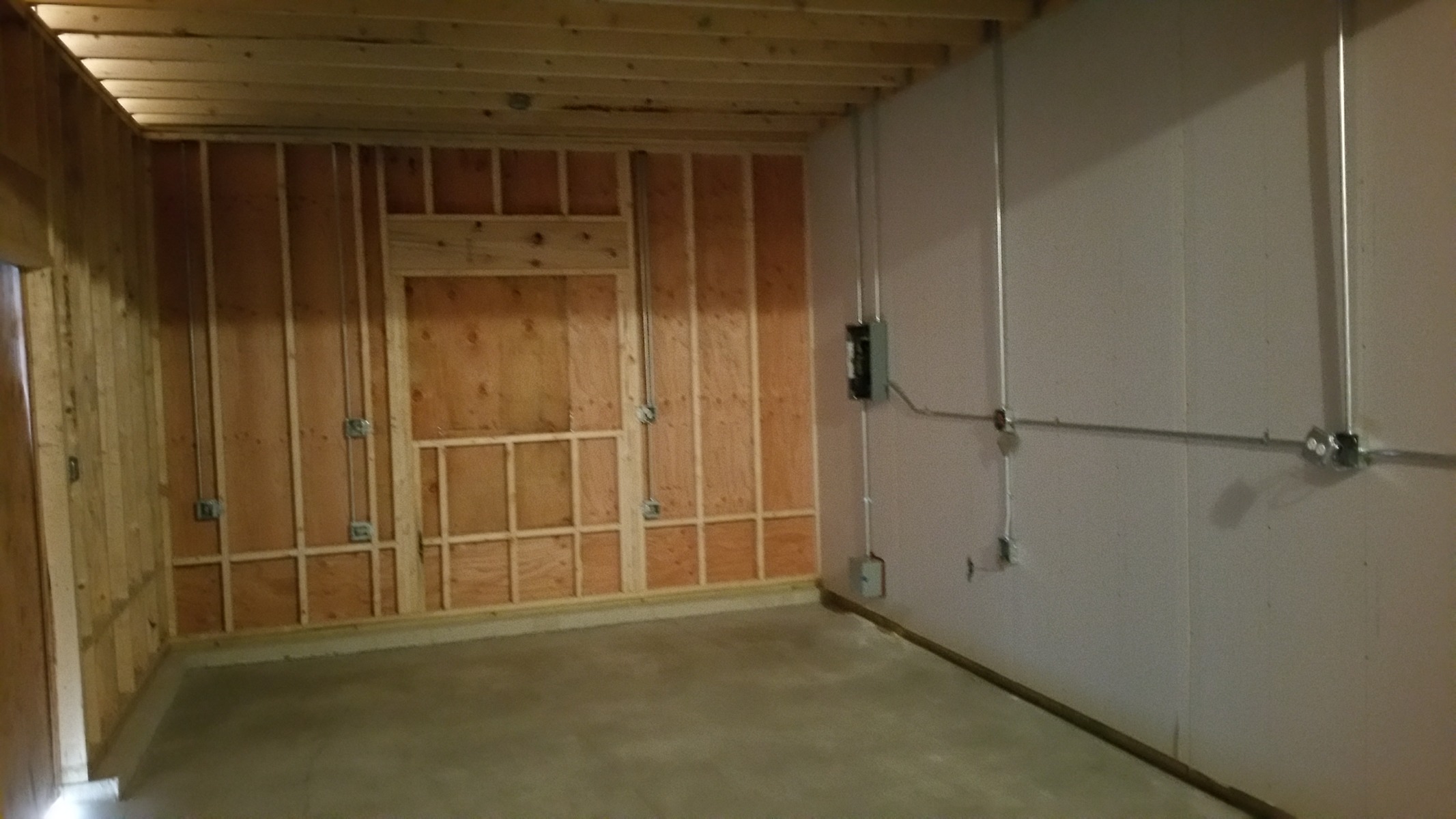

This week the electrician roughed-in the electrical. A buddy and I had to put the fire rated drywall up on the common wall to the house. Needed to do this due to electric lines and outlets need to be surface mounted. The other two walls and ceiling will be recessed electric lines and went in before drywall. Notice the box on the wall? That is a subpanel with dedicated 20 amp breakers. Also, had an outlet wired for 240 volt. Will run the air compressor on that one.
Electrician missed running conduit and outlet for gas heater. It will be suspended in upper left corner. They will be back before drywall. Ceiling will be getting three 8' light fixtures. Also, got outlet roughed-in for outlet in ceiling for drop down power reel. Plenty of counter height and floor power outlets. Carpenter is behind schedule. Drywall contractor bids next week!
