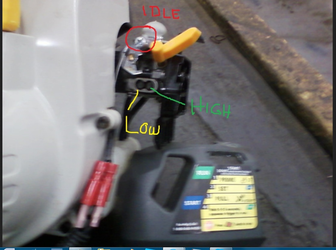

Here's an example of the high and low speed screws on a (Poulan?) leaf blower:
www.amazon.com/s/ref=nb_sb_noss?url=sear...ords=carburetor+tool
