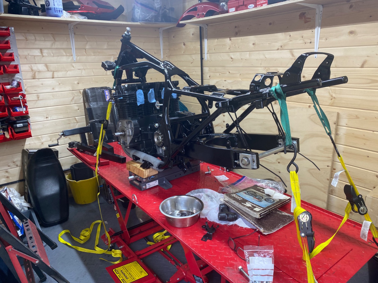

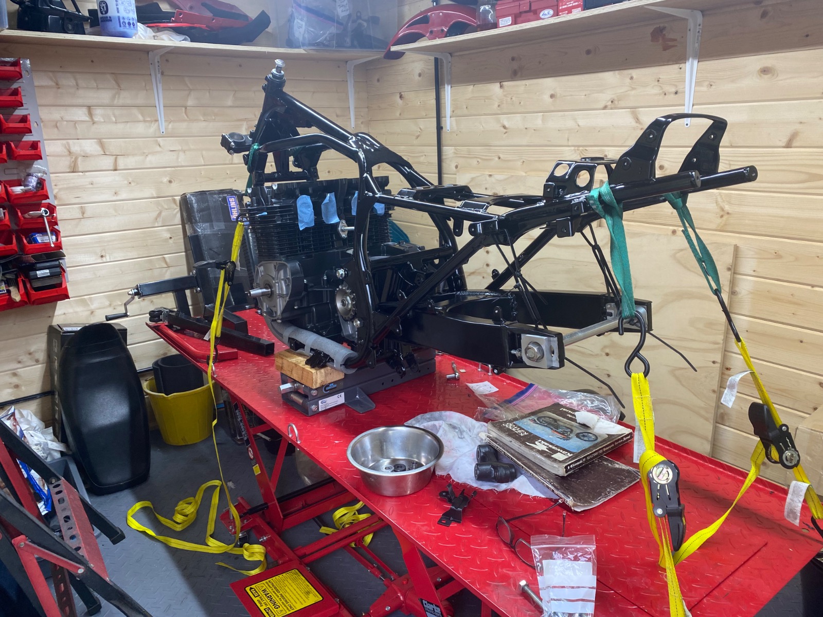

I have all my frames powder coated gloss black.
I have to say though that the PJ1 paint is garbage since they changed the formula 15 years or more ago .
I now use Sperex/Simoniz Tough Black which is as good as the PJ1 used to be.
I use the satin on my engines and it is heat and fuel proof once baked on..
