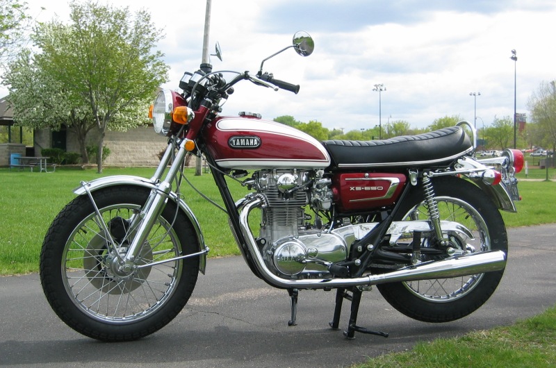

In general I would not to coat a tank. But some need it. I have an XS2 650 Yamaha with Por 15 that was done about 13 years ago with no problems. it has done done correctly of course.
