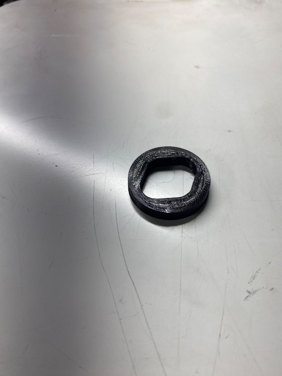

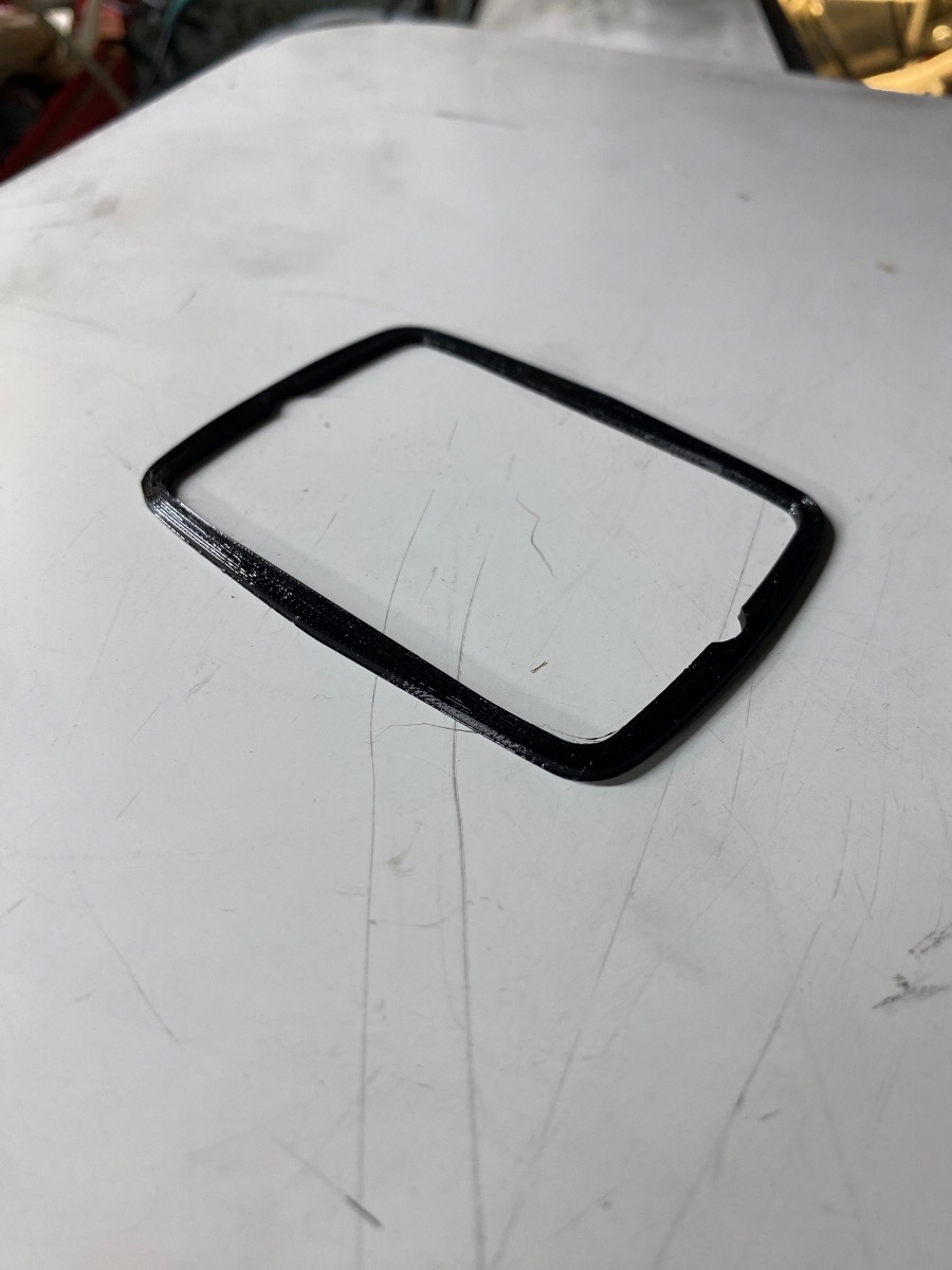

Well folks, I’ve been at it again.
Whether it be from being impatient or frugal, or both… I’ve got some more 3D files if folks want them.
back story: when I got my kz700, it had (the same thing as) no rear turn signals. So I fabricobbled some together from some steel tubing and trailer indicators. While browsing eBay, I came across some rear signals that were chromed for a different model. But the size and shape were identical. The chrome was flaking and peeling so I didn’t feel too bad. Paid $32 for a pair of rear signals. Now, my bike uses a rubber insert that the signals go into. Same Diamond shape, but smaller cross section. I found that removing the insert, there’s a larger diamond hole. And a perfect match for the indicators I got. I did not have the spacer with the Diamond cutout for the washer to hold the base tight. So I 3D printed one from TPU. It works perfect. Then, upon cleaning up the signals for painting, I found that one lens gasket was toast. It shattered into 12 pieces when I pulled it from the back of the lens. So I printed one of those, too. Perfect fit.
If anyone wants one or both files, I’m happy to share them. No charge.

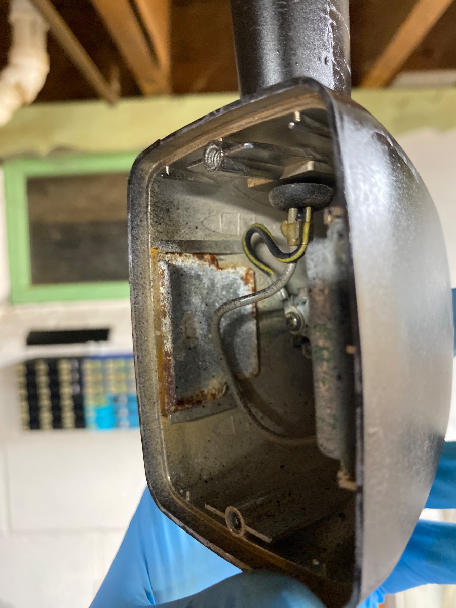

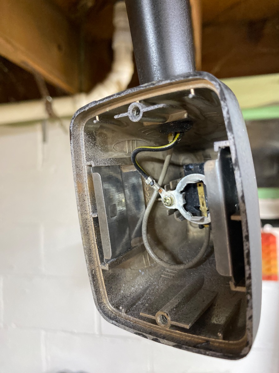

I also re-plated the metal reflectors(?) inside the turn signal bodies with zinc. I can do a write up on that if anyone is interested. Only using stuff from local big box store. With a little patience and a fair amount of concern for safety/health, I think anyone could do it.

I am interested in your zinc process, if you have the time to write it up.

For the clips on my turn signals, those were one at a time. About 10 minutes of plating. They come out looking a dull gray. I was running at about 5v, limited to 300 milliamps.
When you want to check your progress, remove power from either side, positive or negative. Then pull the steel piece out, and rinse in a LOT of water, or swish around in some white vinegar.
After it dries, you can gently use a softer bristled wire brush to reveal the shiny zinc plating under the dull gray.
