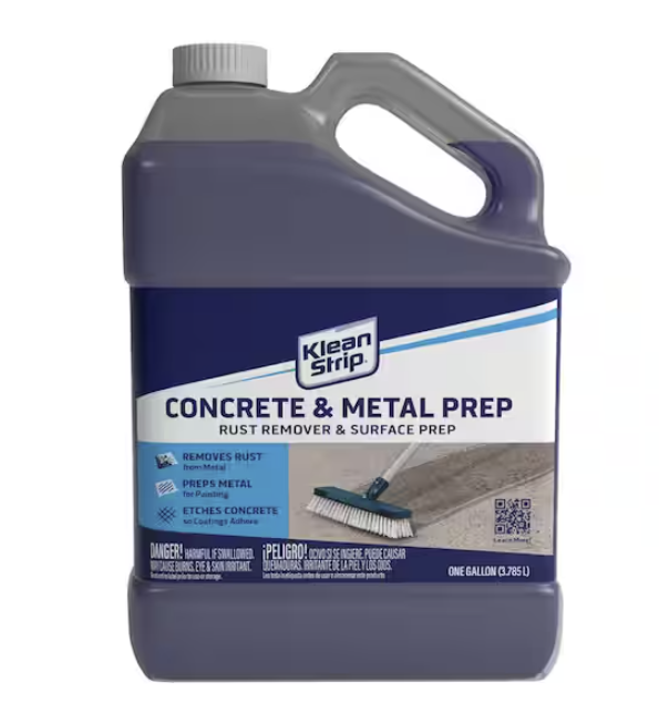

If the vinegar didn't remove all the rust, then get some phosphoric acid. Kleen Strip like this. Before any derusting, regardless of what you use, you must remove the petcock, cap, and sending unit if your bike has one. Do not leave the petcock in place, or use the cap, because the acid will eat the metal. Fabricate plugs for the tank openings. The Kleen Strip should be diluted by about 3:1. It's pretty safe, though. Again, just be ready with the IA and WD-40, otherwise you will get flash rust.

30 Oct 2025 08:36If the metal is sound, not rusted through or thinned out by rust, then you would be better off with another round of derusting compared to using a liner. Get the phosphoric acid stuff suggested earlier. It will eat the rust, and leave the metal with a passive film that reduces, but doesn't eliminate, flash rusting.@Nessism Thanks for the help! Your method work but my tank has some pure rust spots inside.... debating on putting a liner inside
