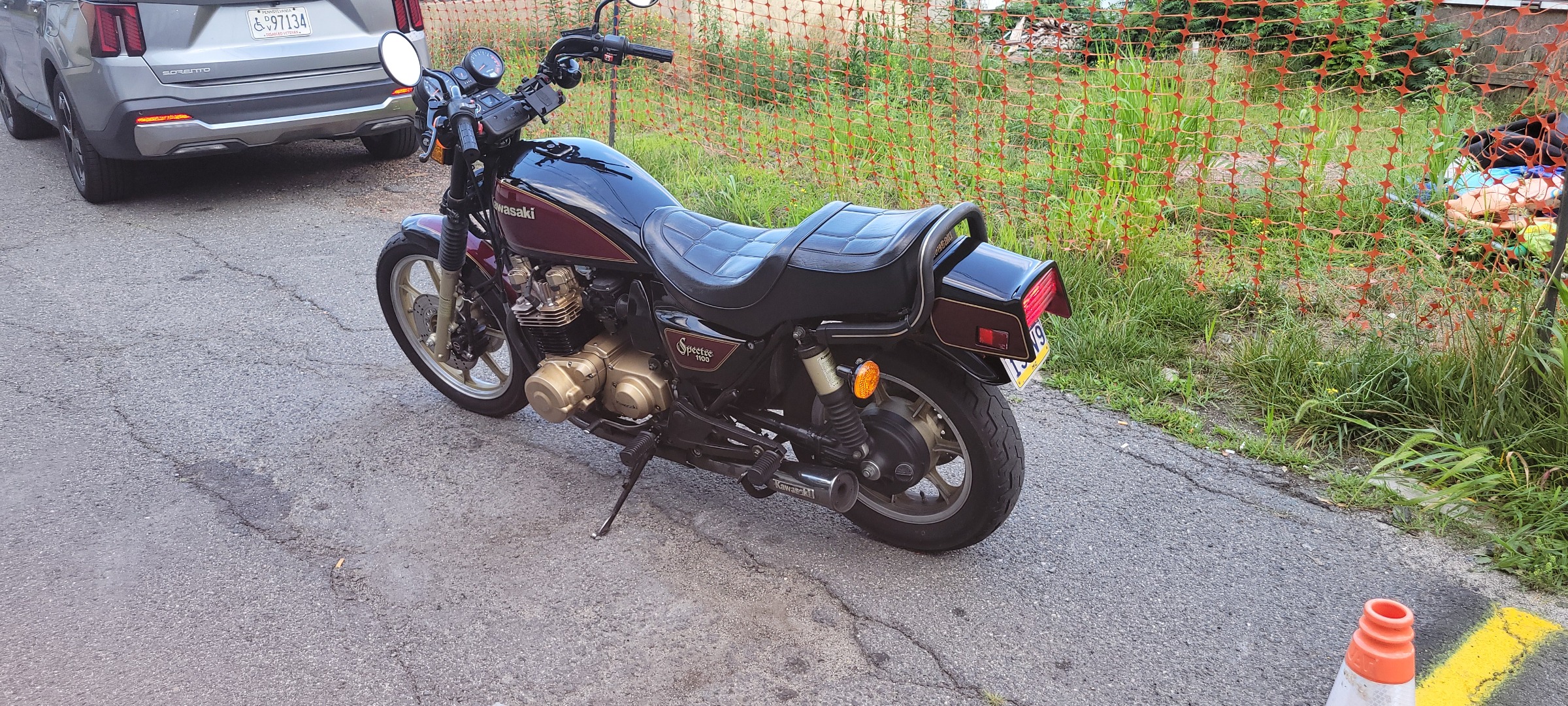

Well I just had a 1980 KZ1000 ducktail painted and detailed to match my 82 1100 specter I had to cut out a little bit and fill in where the old seat went and ended then I wrapped the cup part with door edging and I velcroed the back tail to the light and heavy duty zip tied it and I'm going to attach a picture
I think it looks great and this was just now finished on August 15th 2025
