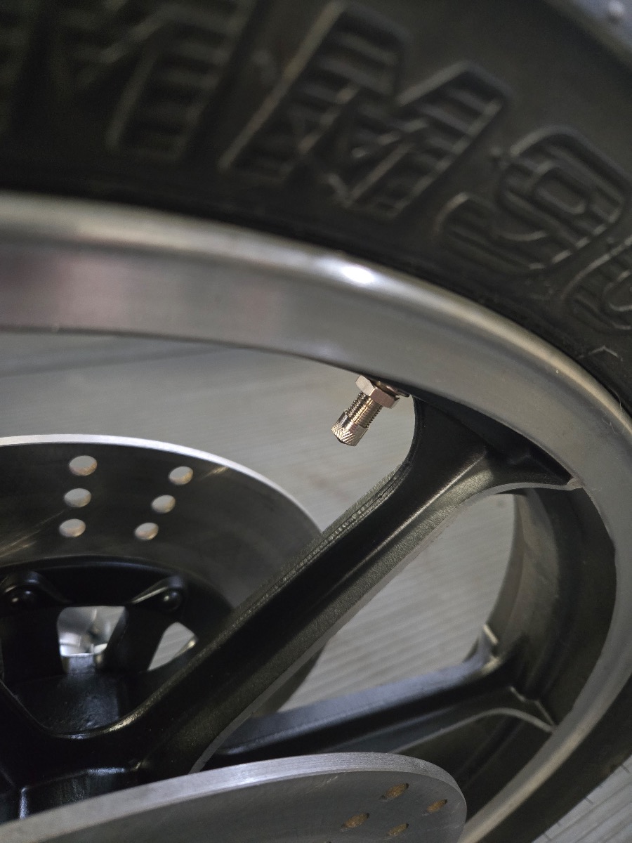

I dont think they were full gloss either but more satin. Whatever it was it sure was thin and blasts off easy.
Not the best photo but these are wheels I did a few months back on the franken bike

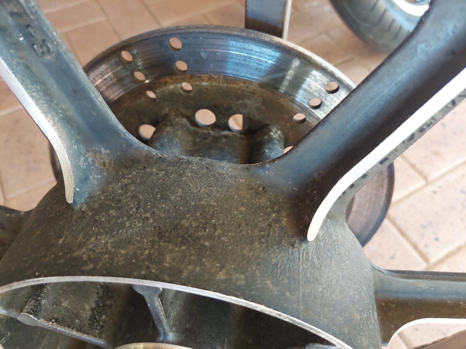

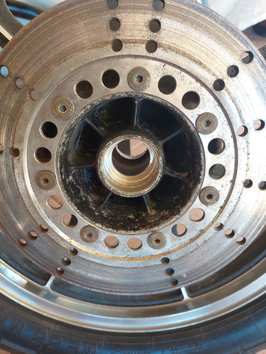

Here's my starting point:

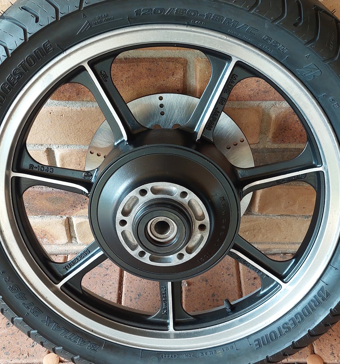

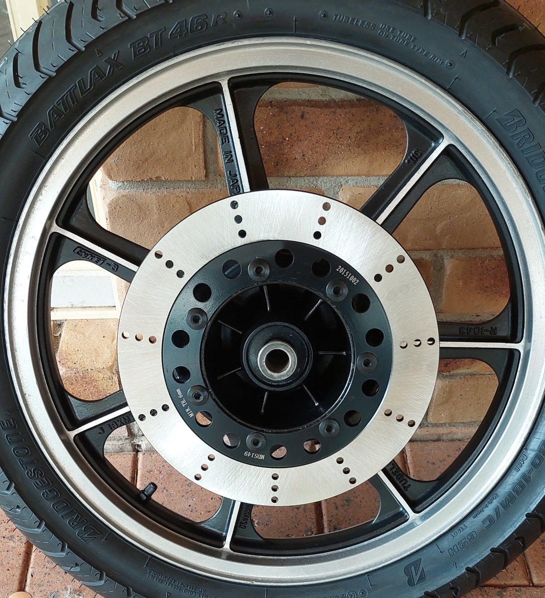

Rear wheel done in Satin, they'd been polished in the not too distant past, I had a quick go with some Autosol before I masked it up.
The brake disc wasn't going to pass a roadworthy so I bought a new one.
