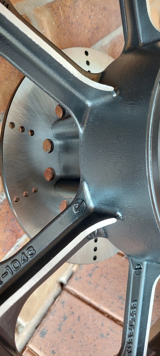

I dont think they were full gloss either but more satin. Whatever it was it sure was thin and blasts off easy.
Not the best photo but these are wheels I did a few months back on the franken bike

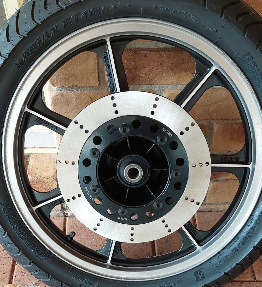

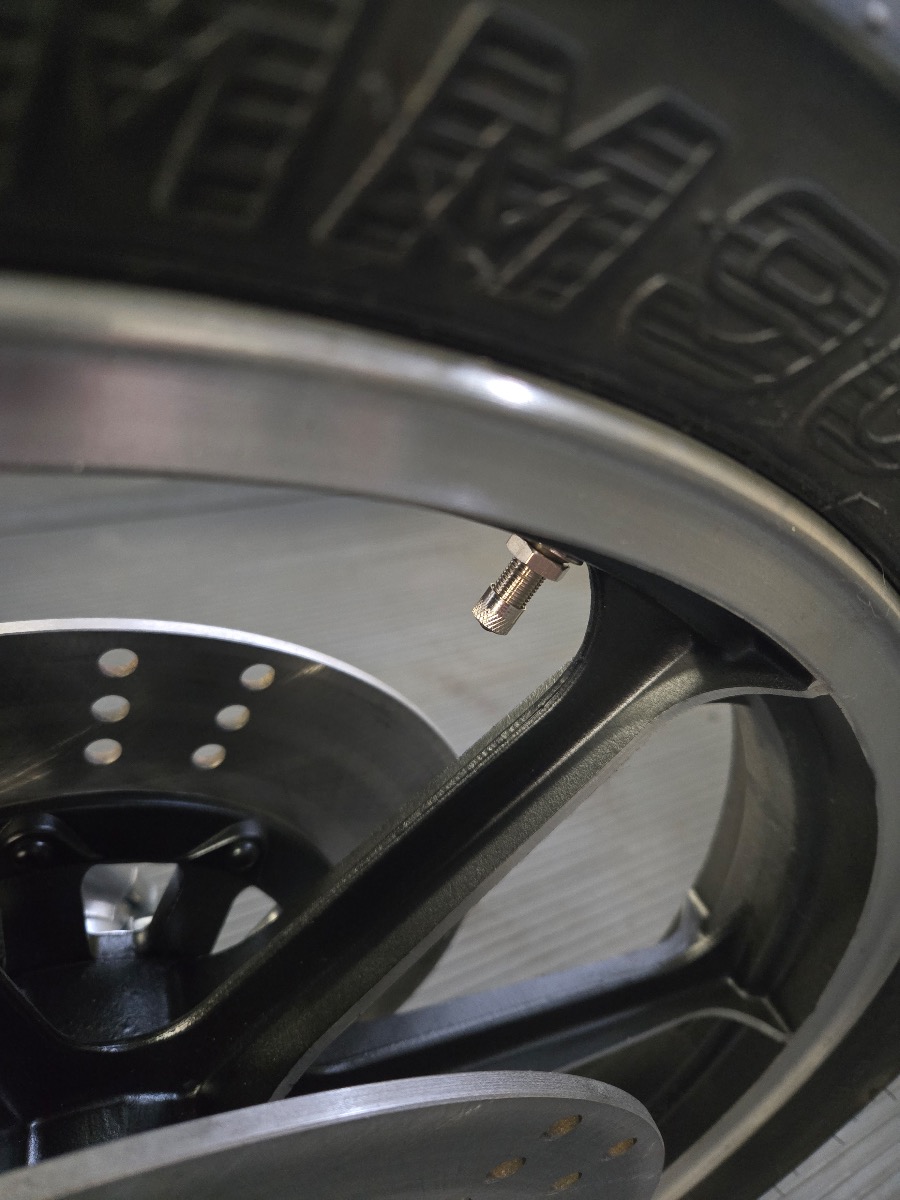

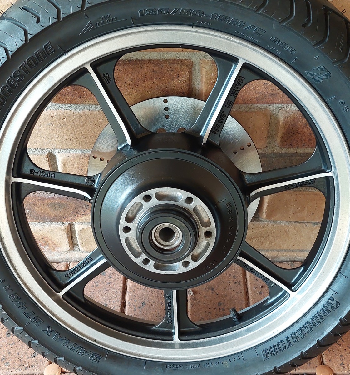

Rear wheel done in Satin, they'd been polished in the not too distant past, I had a quick go with some Autosol before I masked it up.
The brake disc wasn't going to pass a roadworthy so I bought a new one.

Groovy Job Glenn!! NICE and Crisp masking! Those Y-6 Jet holders. I haven't gotten your address? Did you email it to me? I'msoochallenged when comes to my phones functions!

Thanks everyone, I'm very happy with how it turned out, now to repeat the effort on the front.

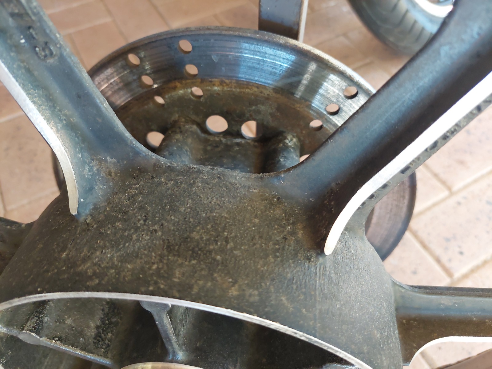

21 Mar 2025 06:28Rear wheel done in Satin, they'd been polished in the not too distant past, I had a quick go with some Autosol before I masked it up.
That looks fantastic. What process did you use to clean and prep the wheel before you painted? What did you use for paint (can or gun)?

1st I degreased with kerosene and a nylon scourer, then truck wash detergent again with a nylon scourer then I blasted it with a high pressure water blaster, just used a rattle can of Caliper paint.
