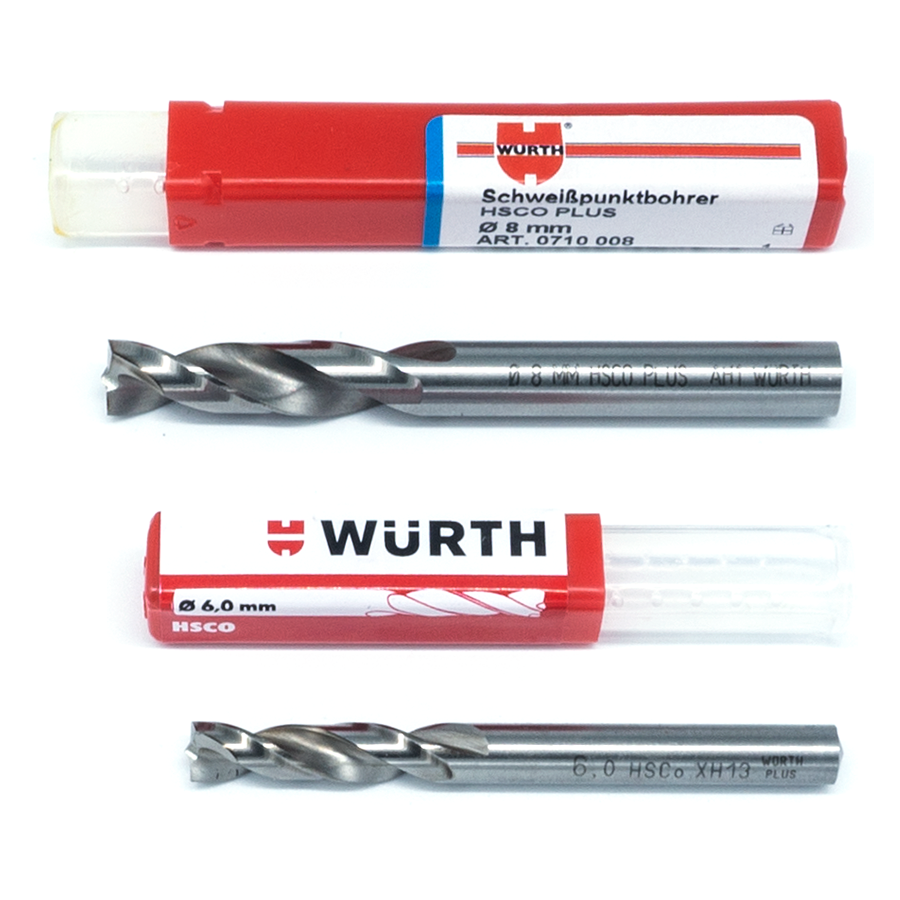

08 Mar 2025 11:14Hi, the mounting screw plate usually has a couple of small spot welds, best to use a small grinder or spot weld drill. Caution using the drill as you don’t want to puncture the tank!!! The grinder has more control. Sometimes the plate is fairly loose and pulls off.

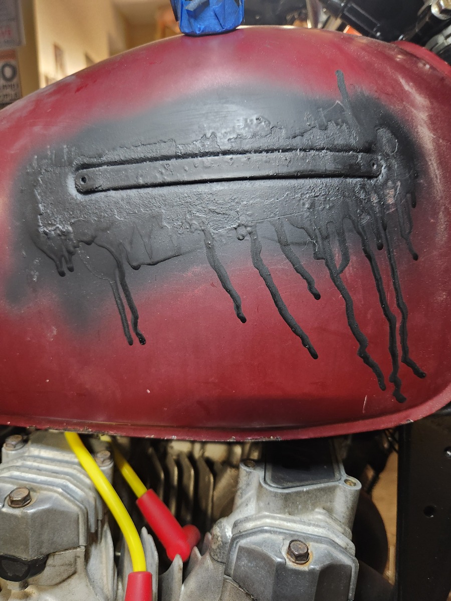

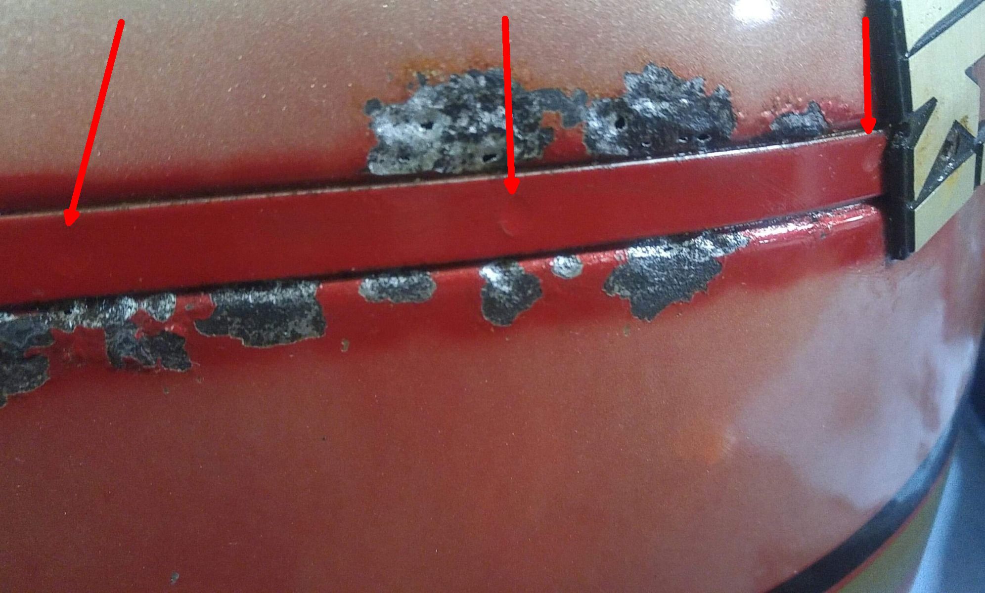

08 Mar 2025 11:50Hi, yes I agree that the plate can be filled over should you want to revert back to original in the future, but even doing that, the surface needs to be rust free and these plates often cover rust which cannot be removed with the plate in place. From the photo, there is a rust issue which can be seen. If you want to revert back to standard in the future and to do this job properly, the plate will still need to be removed, the area cleaned and treated to remove rust and refitted.The tank badge mount plate sits lower than the tank surface so you can bondo over it without issue. It'll also allow to revert back should you decide to do so at some point in the future as the bondo is easy to remove with a heat gun and a wire brush.
A lot of money goes into the paint and you really don’t want rust to start blistering your nice new paint job.

Thanks! As you can see, I have already hosed it down with converter. I do prefer to paint with clean metal. so the brackets gotta go. I will end up using a grinder to remove the spot welds. I have pulled them off before on a CB750 but i also have had to weld up the holes that causes and, I dont want to do that again. LOL!

I use a special drill to remove the dot welds. Any good car body shop can help.

Count me in the camp of removing the bars. There is going to be all kinds of corrosion underneath. My last time doing this, resulted in breaking through to the tank. I took the opportunity to fill in the bar grooves with brazing filler metal. All part of the process...
