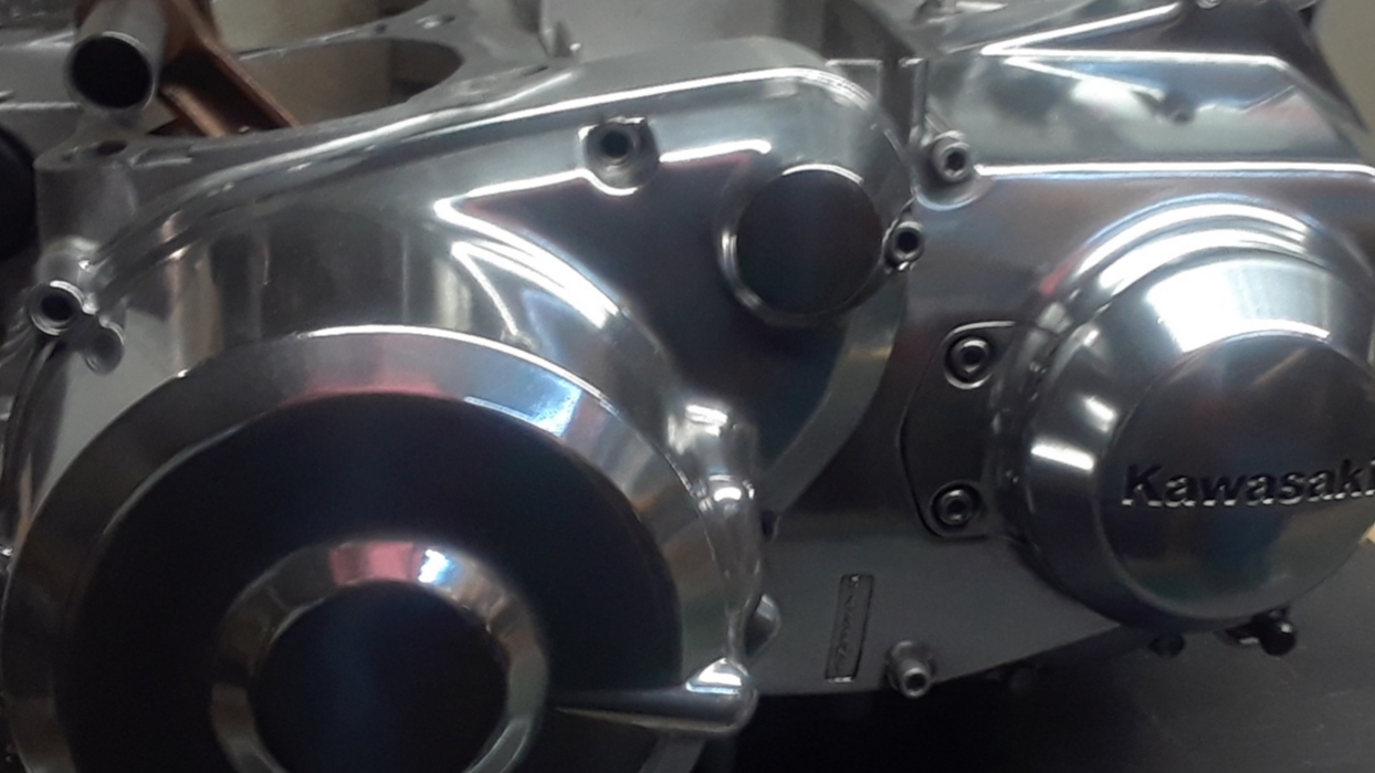

I have a couple NOS engine covers with the original factory applied protective finish on them.
Like to approximate that finish on several other J-motor covers that have no finish.
Anyone suggest a durable, fuel-resistant spray-can gloss finish for use on raw aluminum?
Satin luster polished finish:
