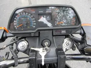

what shape is the 700's glass? the glass shops here in a large city couldn't even cut a round piece of glass right. they didn't have the right thickness anyway.

They look like this (not my pic). My local shop can make them for approx $100 out of tempered glass.
