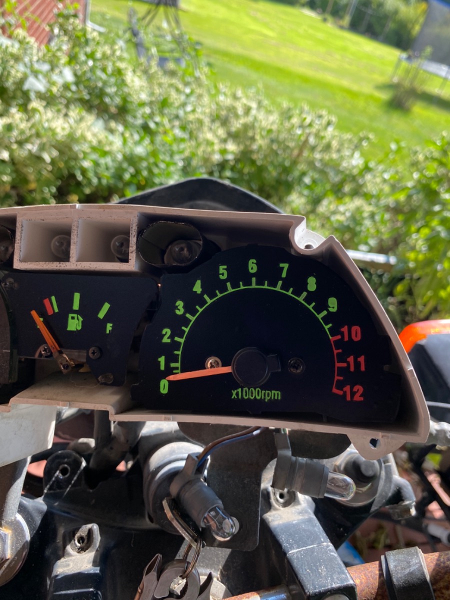

Sweet. Are you going to use some adhesive to attach them?

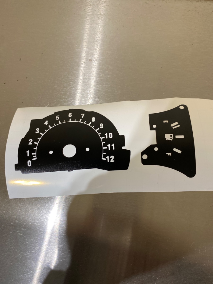

It’s already adhesive backed.
im getting some transparent lime green vinyl from Amazon. Probably red, too. So plastic gauge face backing (acrylic?), green/red, black from pics.
might try to find some clear that will block UV from getting down to the colored layers.

Very Innovative!! Nice work, new technology for the hobbyist. I do my share of gauges and always try to avoid the "decals" but sometimes one has no choice. Keep up the Great Work!!

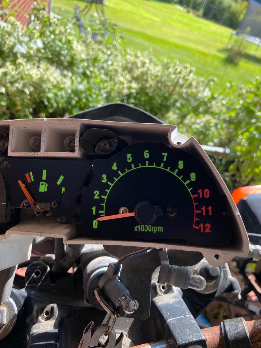

Also replaced the 3 electrolytic capacitors on the tachometer PCB. Very easy to do, and now they'll last another 40 years.
Very easy to do. And likely needed replaced anyways. Electrolytic capacitors have a finite lifespan.
The values were: 6.3V 470uf, 16v 47uf, and 50v 2.2uf. I'm *assuming* that they were the stock capacitors.

Thats awesome! Worked out really well. Nice job
How does the software work? Do you start with a photo or copy or freehand. Curious as I want to tackle my tachs faceplate and was thinking scan and try MS Paint or similar to clean it up and print.

The software I used was gimp (photo editor, free), fusion 360 (optional), and the cricut design software.
absolutely use a flatbed scanner. And the existing gauge face has to be touching the scanner. This is all to make sure that it’s scaled properly.
in the photo editor, you have to remove everything that isn’t the color you want. It has to be a single color. That means anywhere a white region borders a black region, you have to choose exactly what to keep. Aim to have a strictly black and white gauge face to load into the cricut software.
