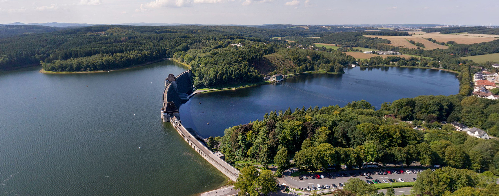

Operation "Züchtigung" the destroying of the Möhne dam with a bounzing bomb by the RAF.
than
and now

Scirocco, thanks for sharing the before and after photos of the Mohne dam. When in high school (50 years ago) a history teacher sparked my interest in WWII Europe. Since then I've read and viewed all I could find about the conflict, strategies, people, etc. Around that same time I was able to visit the invasion beaches and cemeteries in Normandy which reinforced the history lessons.

30 May 2024 01:18Scirocco my wife is from Heringen (near Hamm) so I have been there a few times, it is stunning. I have to say as an Englishman I felt quite uncomfortable the first time looking at the memorial plaque with pictures of the Lancaster that dropped the bomb and knowing the devastation it caused to the towns and people on the lower level, but I guess "that's war"I am located in a town in NRW (North Rhine Westfalen) called Plettenberg. It´s agra county side and industial automotive industry area.We have a lot of curvy hill and forest roads like the famous "Tail of dragon, america’s number one motorcycle and sports car road" and dozent of biker meeting points around the water resource dams and lakes like Möhne, Bigge, Sorpe dam. It´a biker paradise of some kind of wanna be race driver from the local area from theRuhrgebiet (Bochum, Essen, Dortmund) aka "Kohlenpott" and the Netherlands, Belgium, Luxembourg, that let off steam on the roads.
