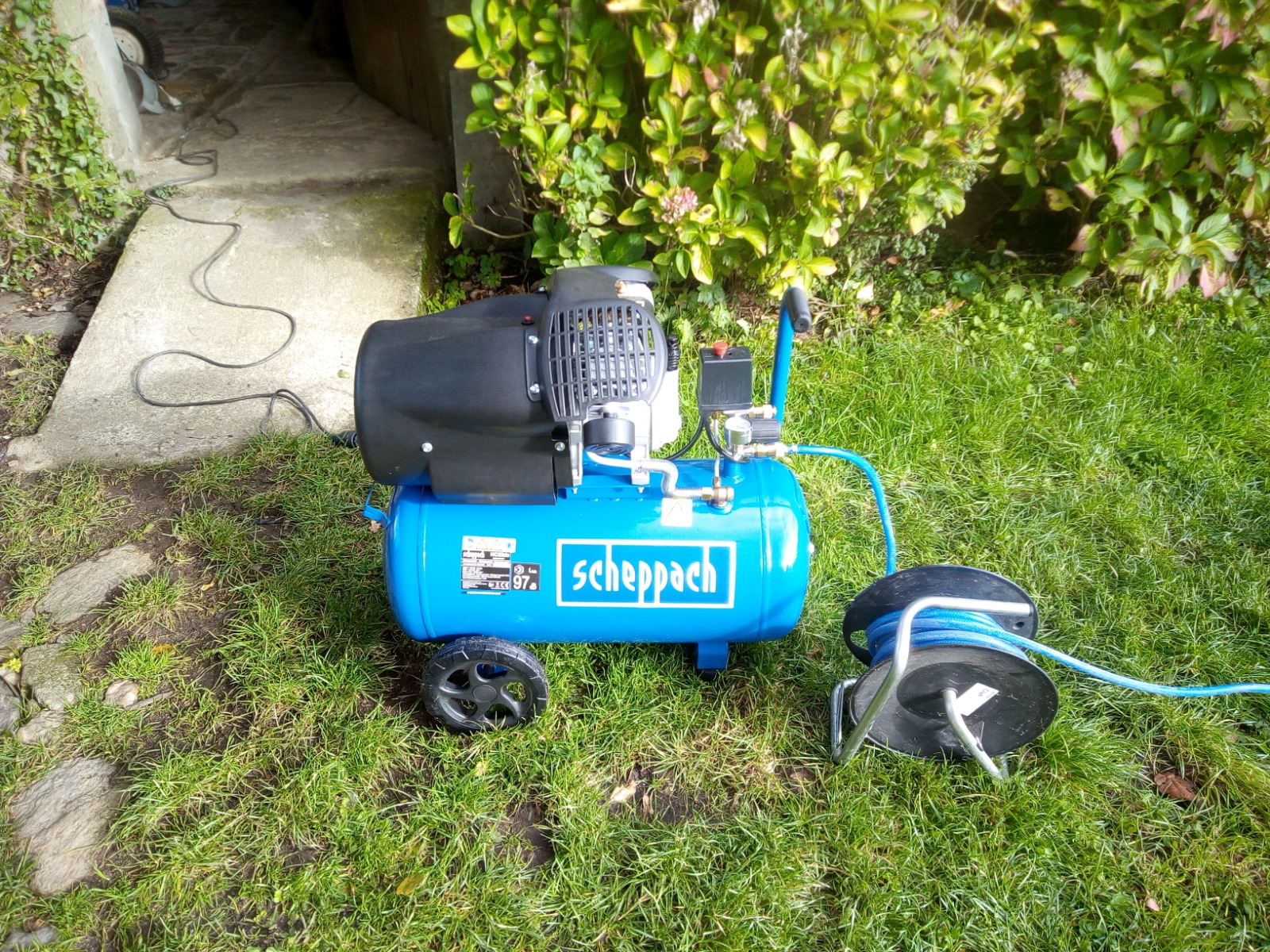

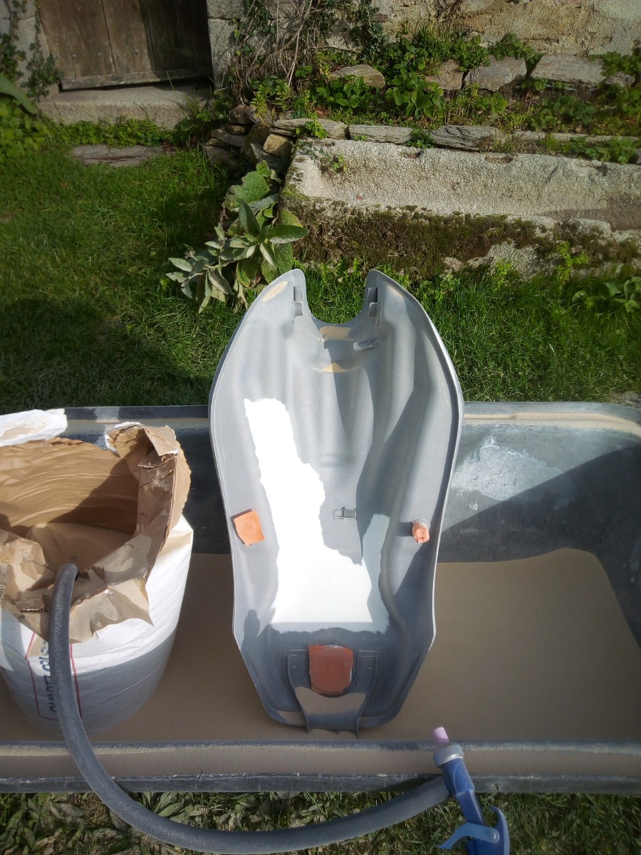

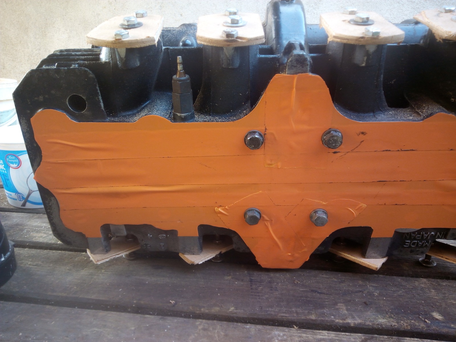

I have this setup
Silica sand No. 1 grade. With the 3hp compreesor I get about 40 secs / min of blasting before I have to leave it to recharge
With the set up it's quite slow but also not too aggressive so ports can be masked with builders tape.
Whatever route you decide thorough cleansing afterwards is more important than anything else. With the sand I use warm very soapy water, rinse, repeat several times, airline then repeat.
