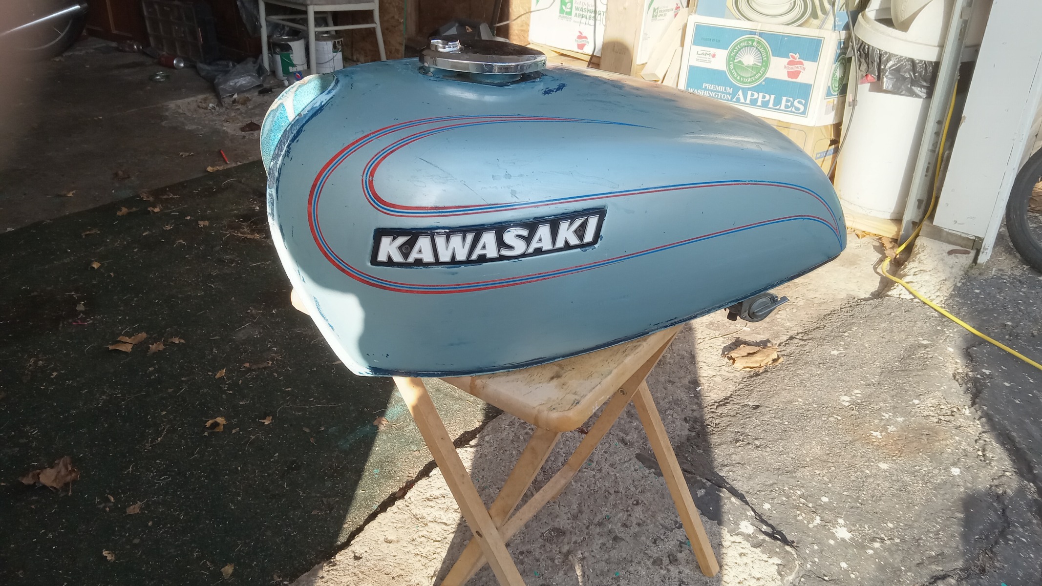

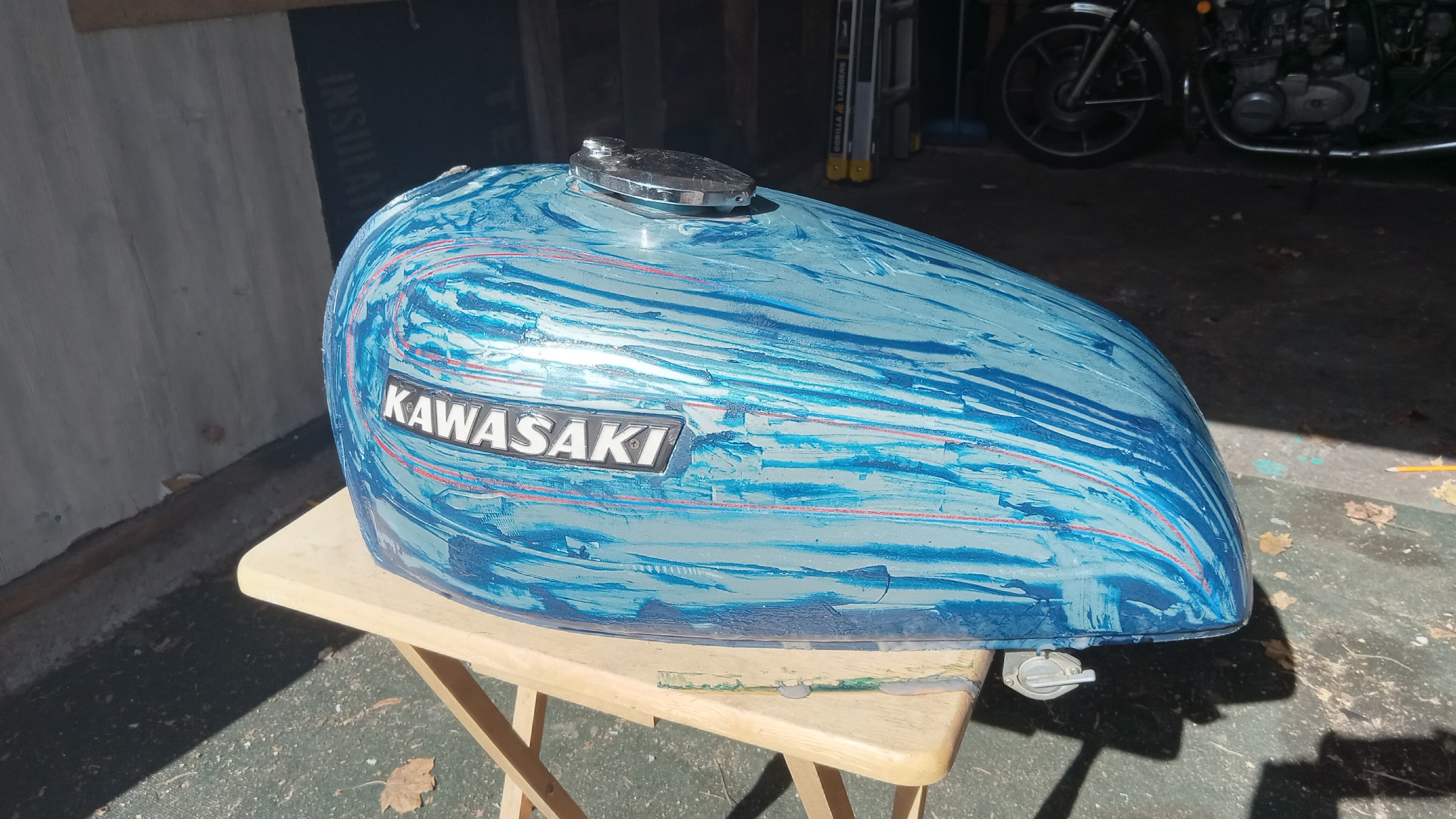

Hey all, with these crazy warm Temps here in Michigan, I got motivated to start getting the bike ready for paint. I did a Citristrip round and was blown away by what I found underneath.
Original Silver (?) Paint job with intact decals on the tank - under what ever the blue paint was.
I'm so happy, the paint looks to be in really good shape on the tank I did one side cover too and it wasn't in as good shape.
Anybody ever freshen up the decals with paint? Is this color rare or anything?

Those side badges will come off easily. They are held on with two screws. Then you can properly strip that area.
Re: Silver paint job hidden under blue!
25 Feb 2024 08:02
That is standard color, Metallic stardust silver, used on the “C” model. They were built from 1977-1979.

That specific tank color and decal were only on the 1978 C2 model. The model year before and after are different, the 1978 stardust color is the hardest to paint match. That color is similar to the same year Z1R (probably slightly different again)
You can find 650 model info here :
www.jarlef.no/Kawasaki/Series/Z/650/Z650C.htm
