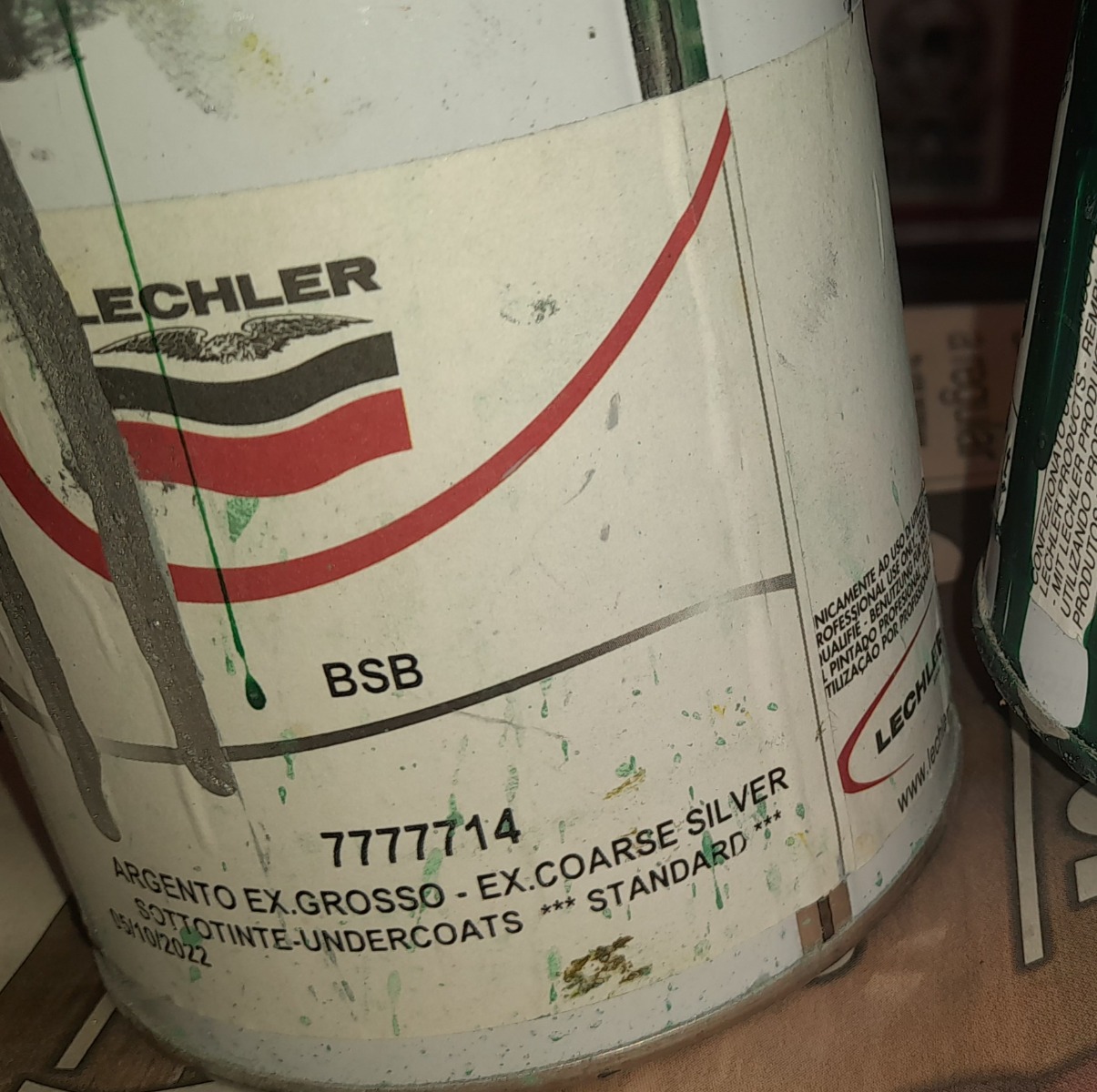

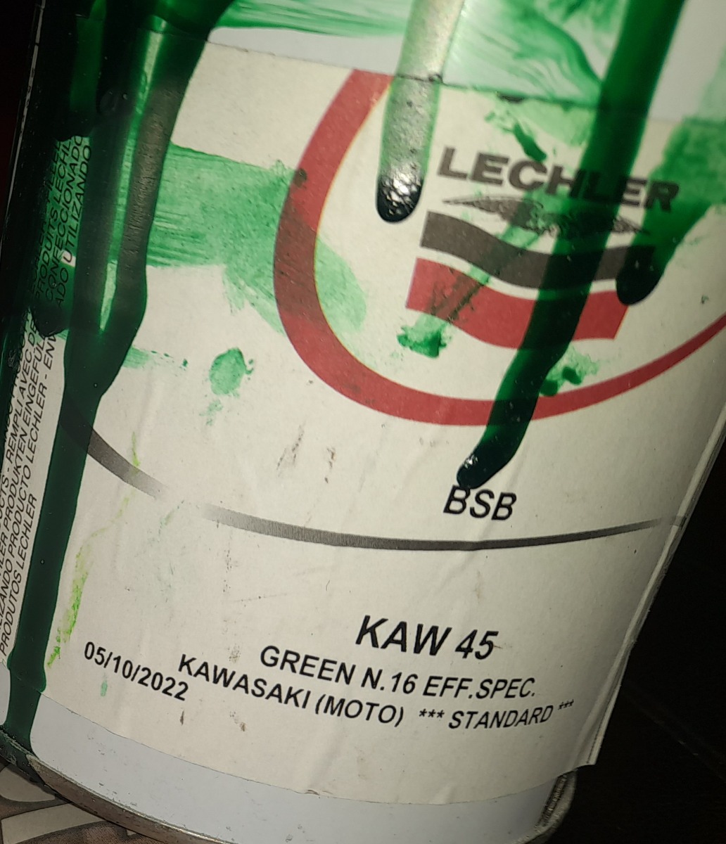

Re: Need paint source KZ650-B1 Green
19 Dec 2023 01:40
#892880
Primer,
Silver base,
Green tint,
Clear,
Vinyls,
Clear.
