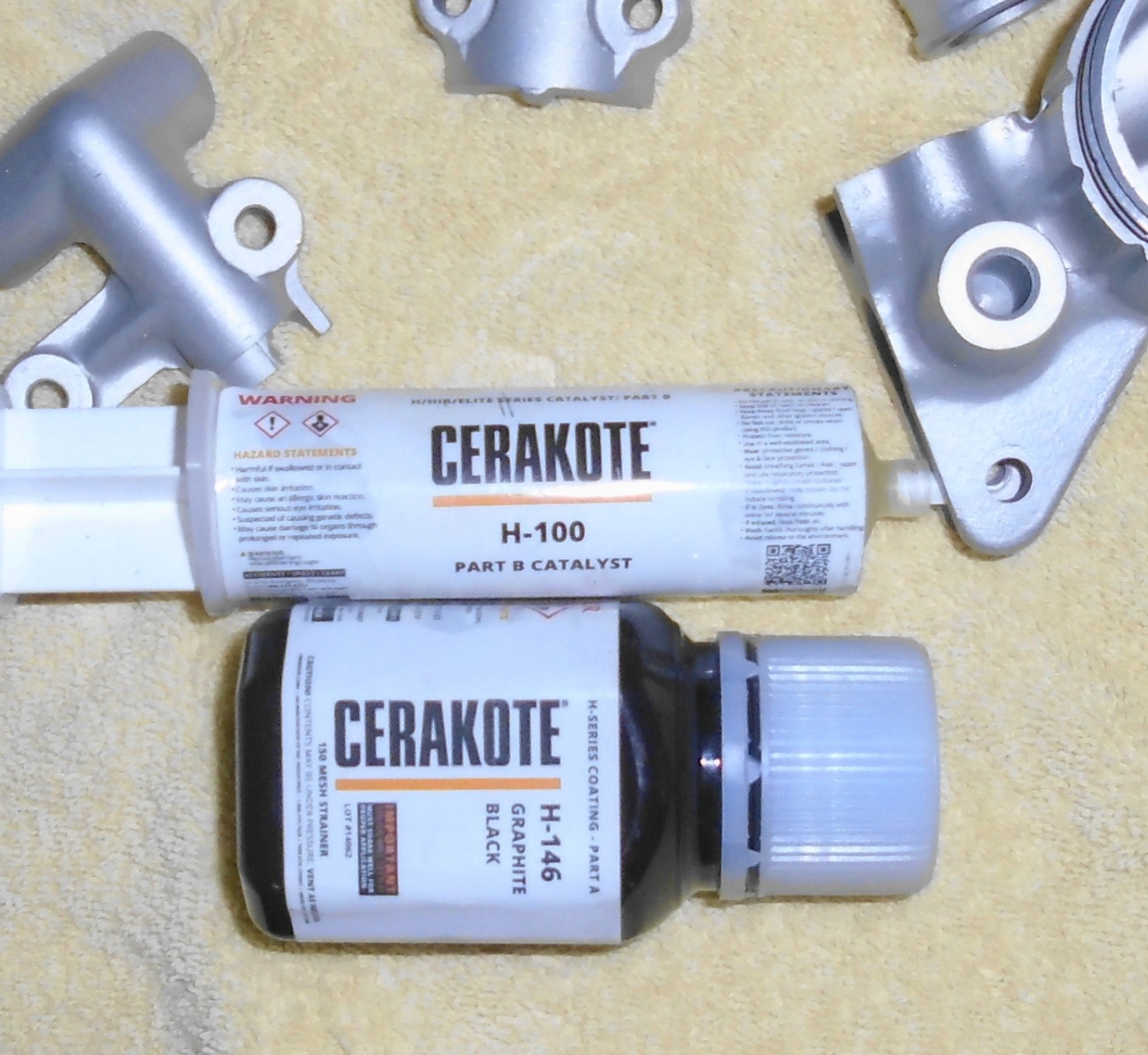

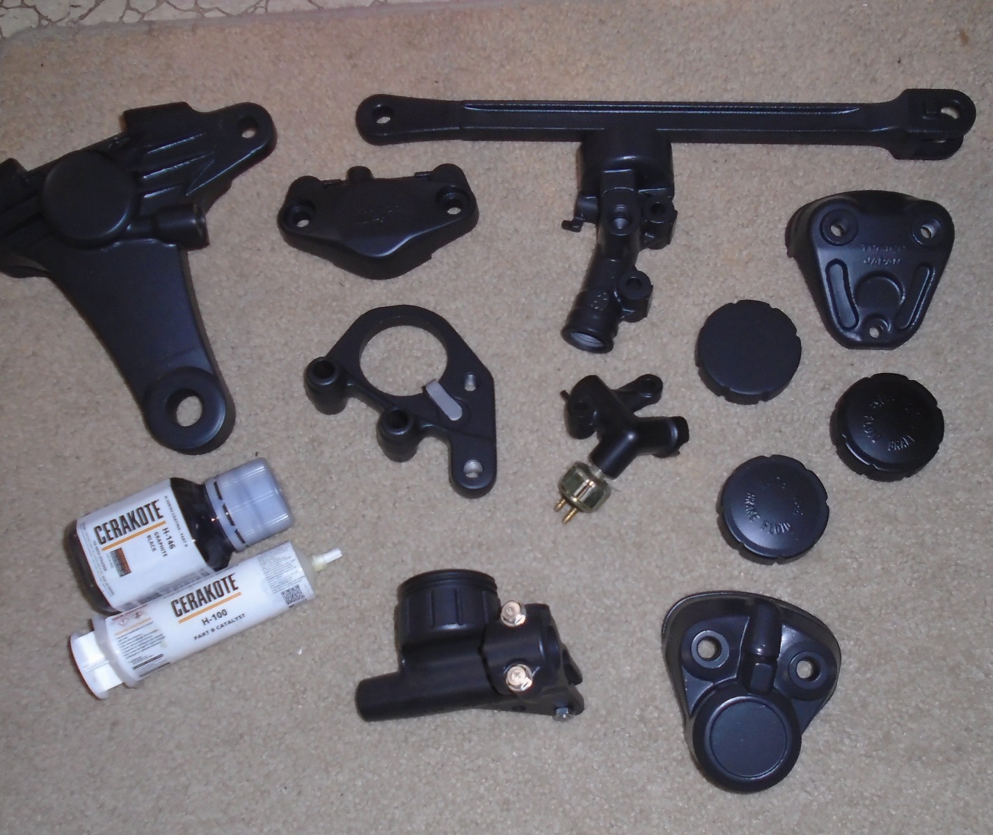

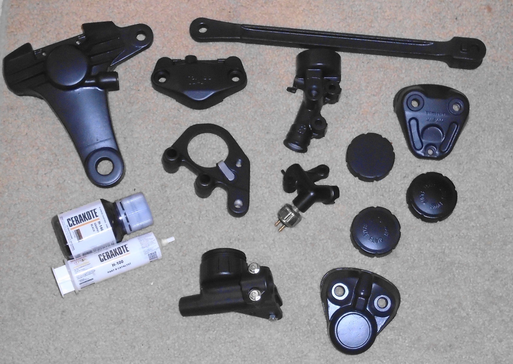

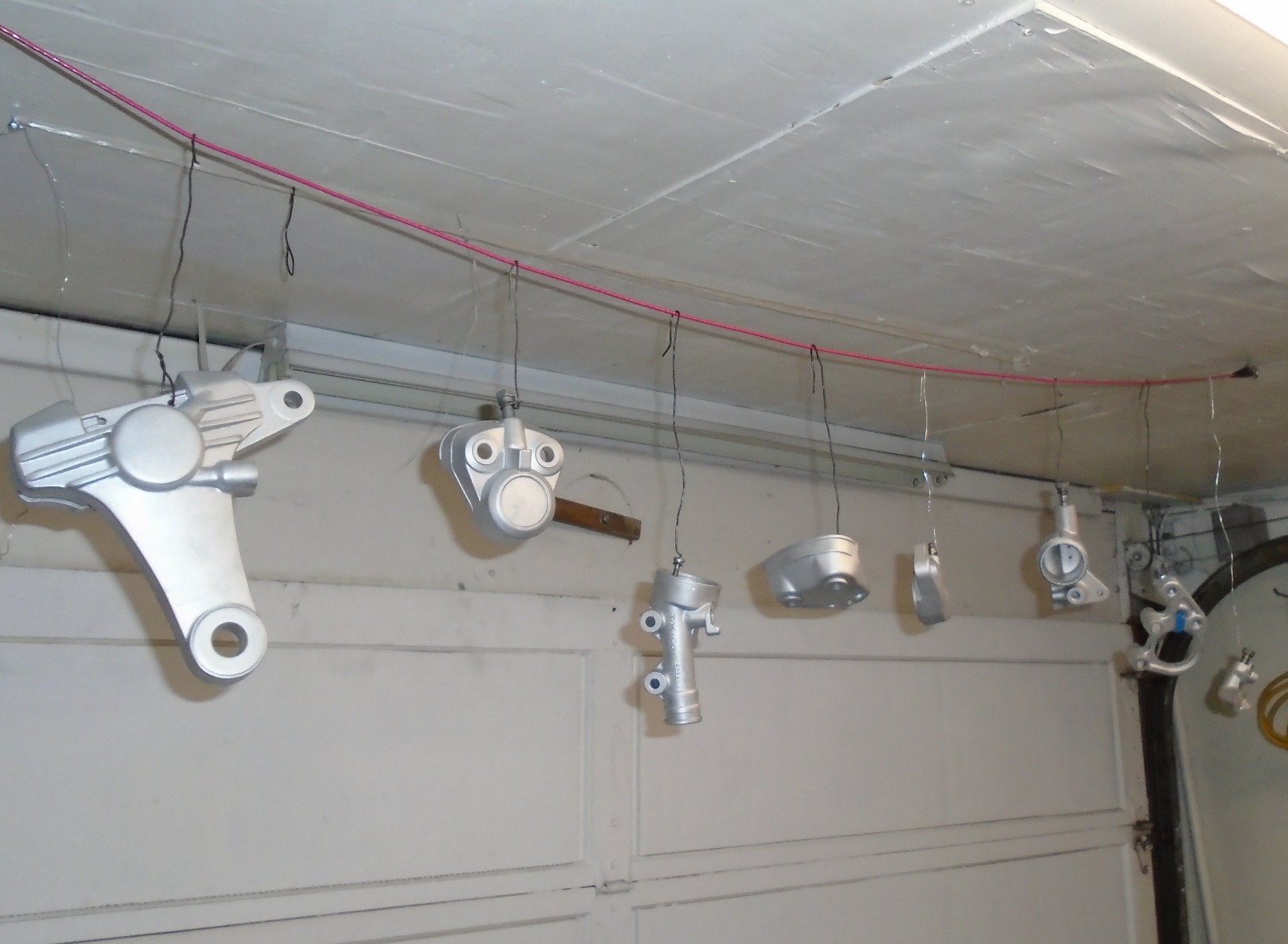

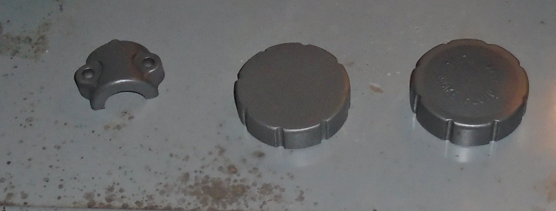

WOW! EXCELLENT! I WISH I STARTED THIS SOONER!!
FOLLOWED DIRECTIONS OF COURSE!
4 OUNCES @ $39 DOLLARS!
COVERED IT ALL!
IT IS A LITTLE DARKER TO THE EYE! LOOKS SATIN BLACK
I GOT 2 PROJECTS! Z1 FRONT BRAKE TOP & BOTTOM.
REAR 78 KZ1000.
THANKS TO WOOKIE!! FOR THE INCENTIVE!!
AFTER HOLIDAYS! I NEED A BREAK!
MARTY IN BUFFALO

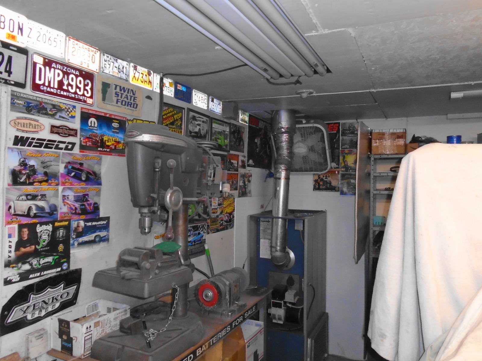

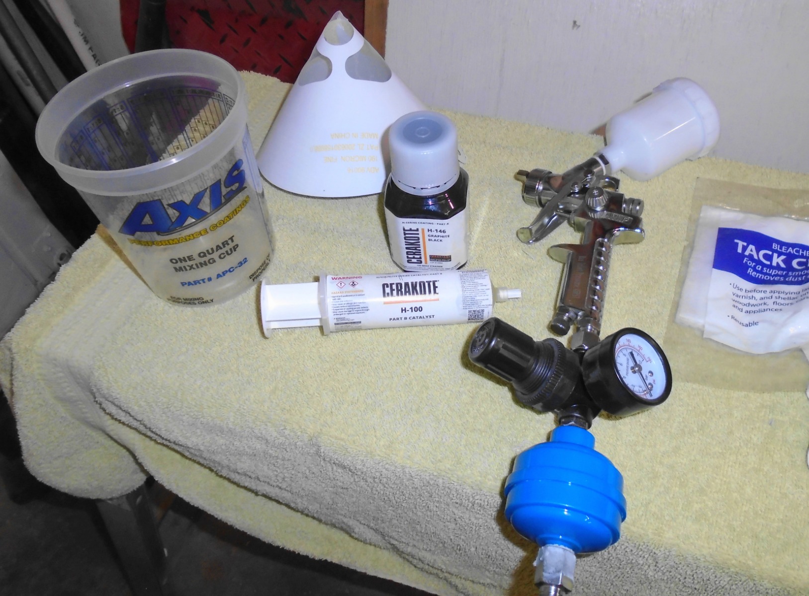

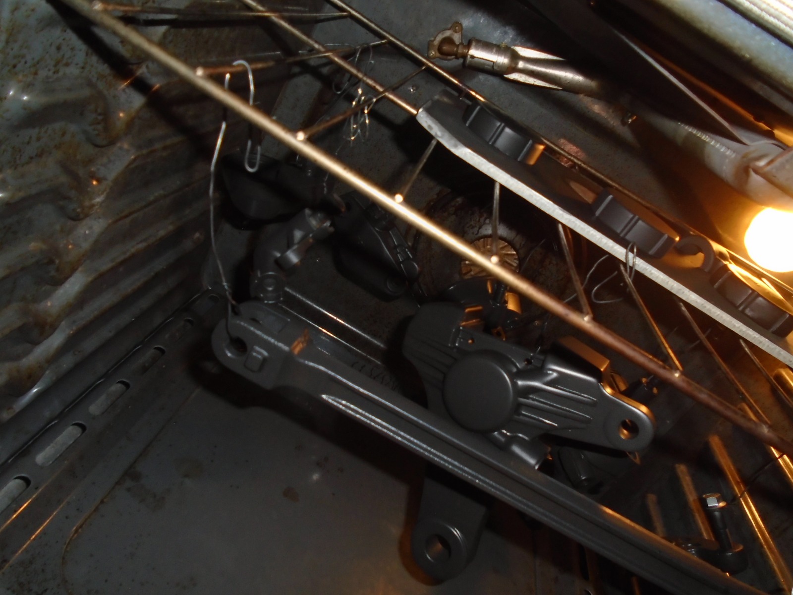

Stuff Worked Great! Had Heat in my small shop! Then baked in oven "The H" product!"H - 146 GRAPHITE BLACK" 2 part catalyst system.Small detail gun with .08 fluid nozzle.I'm a PRO!
Don't let this stuff scare you! Simple as spraying clear coat!
