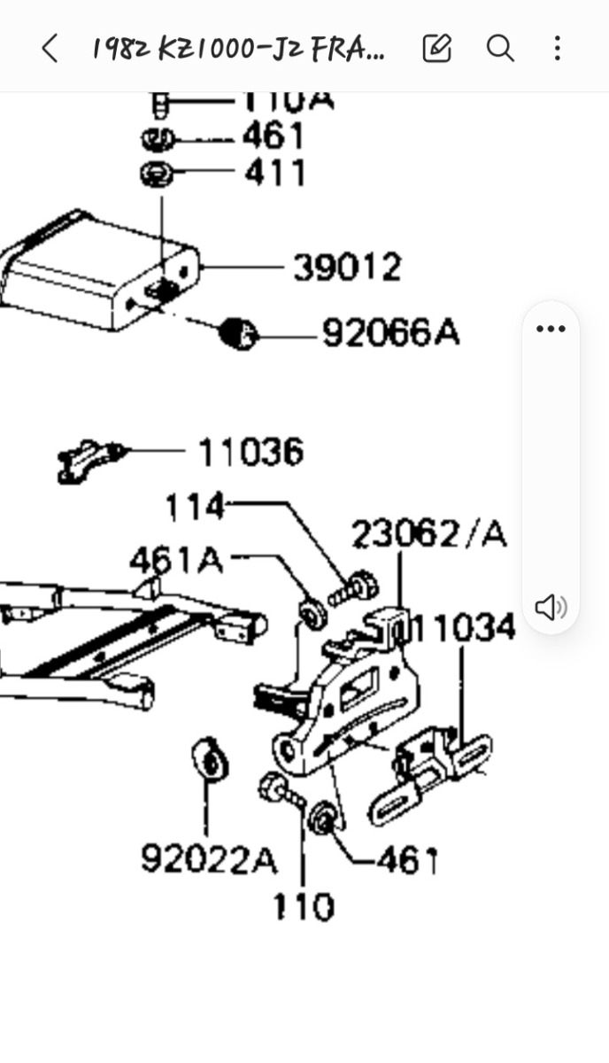

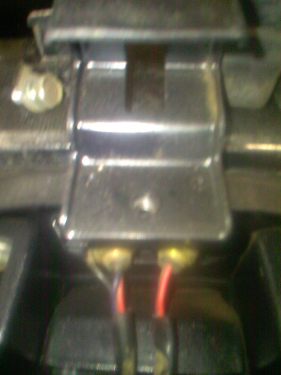

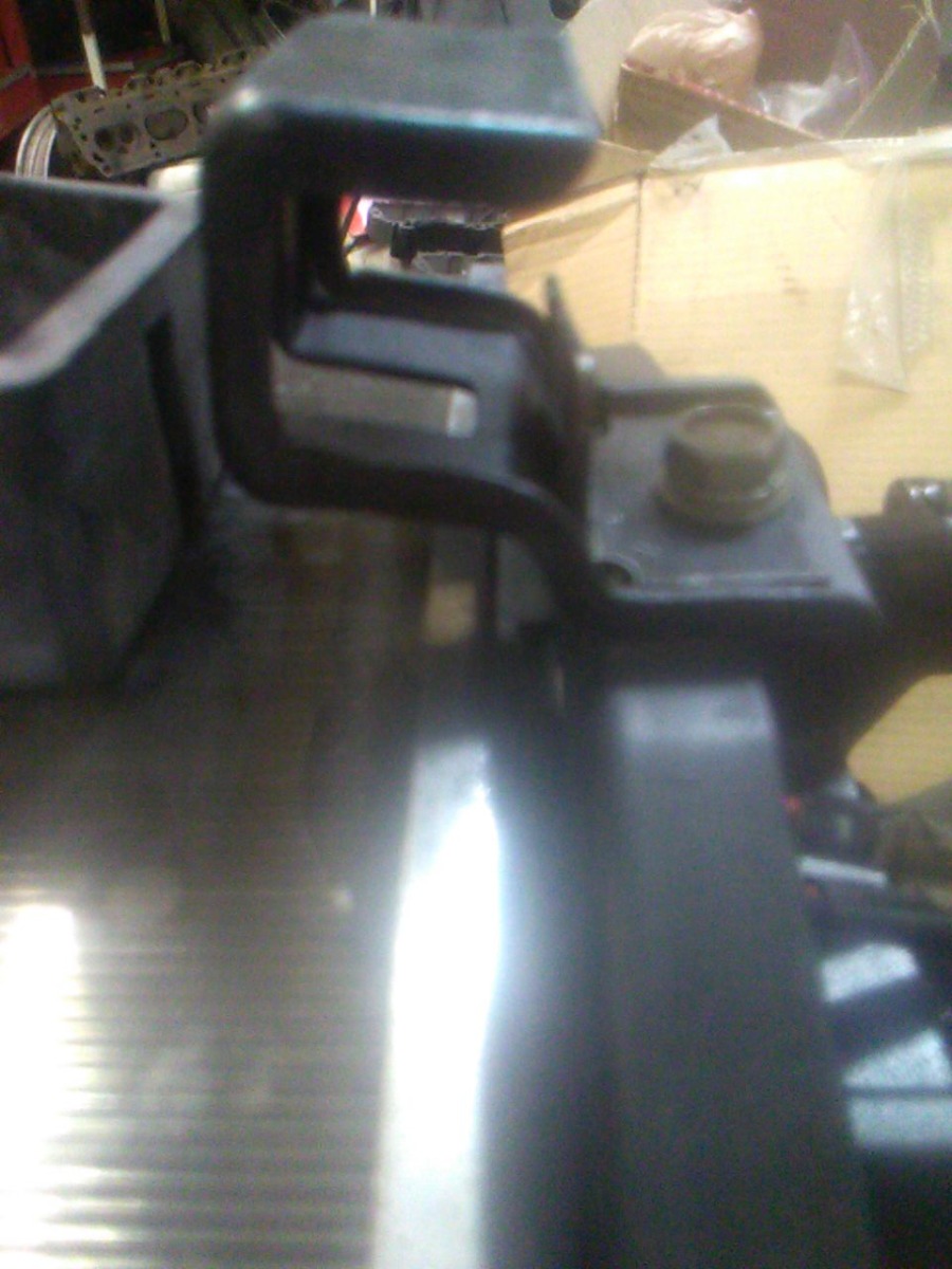

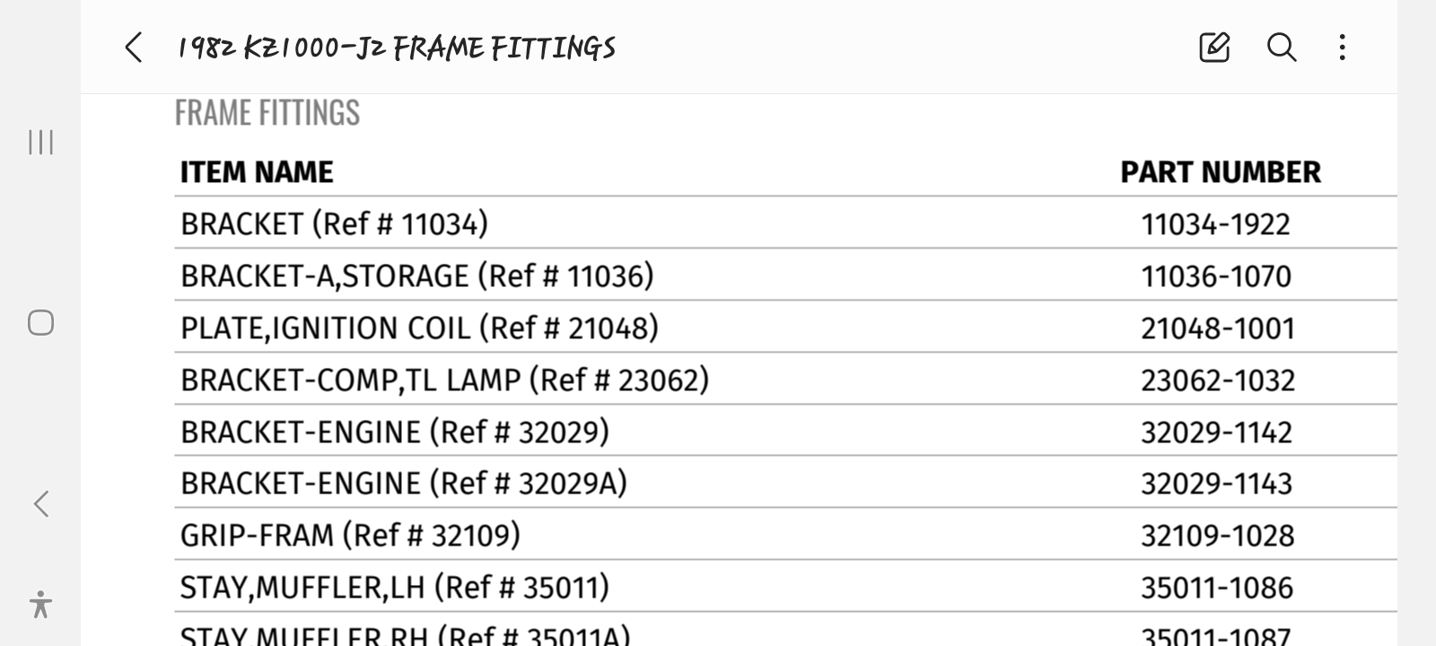

Hi all, the metal mount on top of the tail light bracket that mounts the rubber damper for the ducktail / cowl;
is that piece available separate from the complete tailight bracket? I'm thinking it was spot welded on originally.
Pic shows mine, it was deleted when previous owner modified the main brackets to tuck the twilight into the cowl. He siliconed the cowl to the tallight lens for mounting. Worked okay I guess but I'm keen to get away from that and use a rubber damper.
Will probably have to have something made as the bracket has moved forward. if someone could post a detailed photo of the factory damper mount it would be much appreciated.

Spot on, thank for the photos, that is the missing link.
