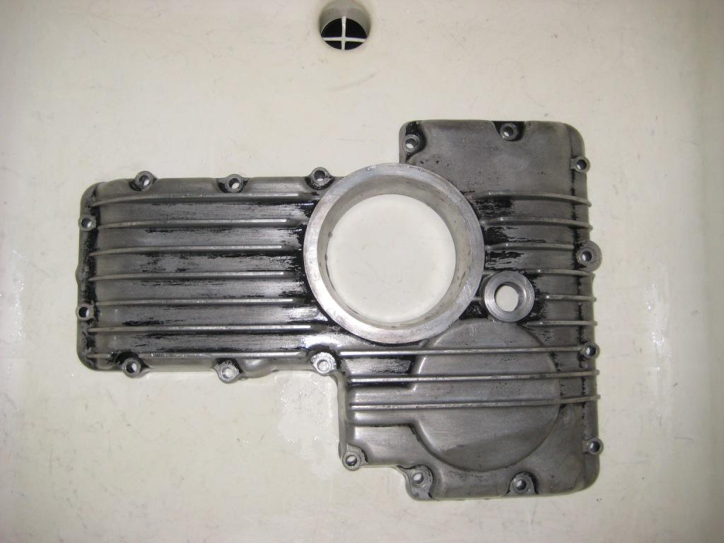

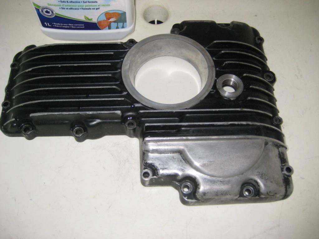

KZ1000 oil pan - PO sprayed it black, at least two coats of who knows what. This is after two hours of just reapplying it every 30 mins open to the air, scrubbed off with warm water and a nylon brush.

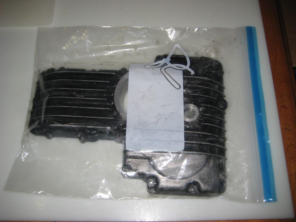

Next I took the same part and brushed the gel over every spot of paint left. Then I put it in a big zip lock bag and left it for 24 hours.
Here is the result of the oil pan soak after 24 hrs in the bag and some scrubbing with a SS pad under warm water...
There is just some stuff remaining on the base between the fins and in the bolt recesses. There is no paint on the fins at all.
Overall I am happy with that result as it was minimal work compared to previous methods.
I eventually got all the paint off with some spray carb cleaner and a shop rag which took about 10 minutes.

I tried brake fluid on this pan, submerged the thin end in it for 3 day - zero effect. I also tried MEK without any major effect either, it did soften it a bit but it did not lift it off.
Don't know if it was the heat of the engine that baked it on or what. To me the paint just seemed to be black engine enamel that was sprayed on, not a hard paint at all.

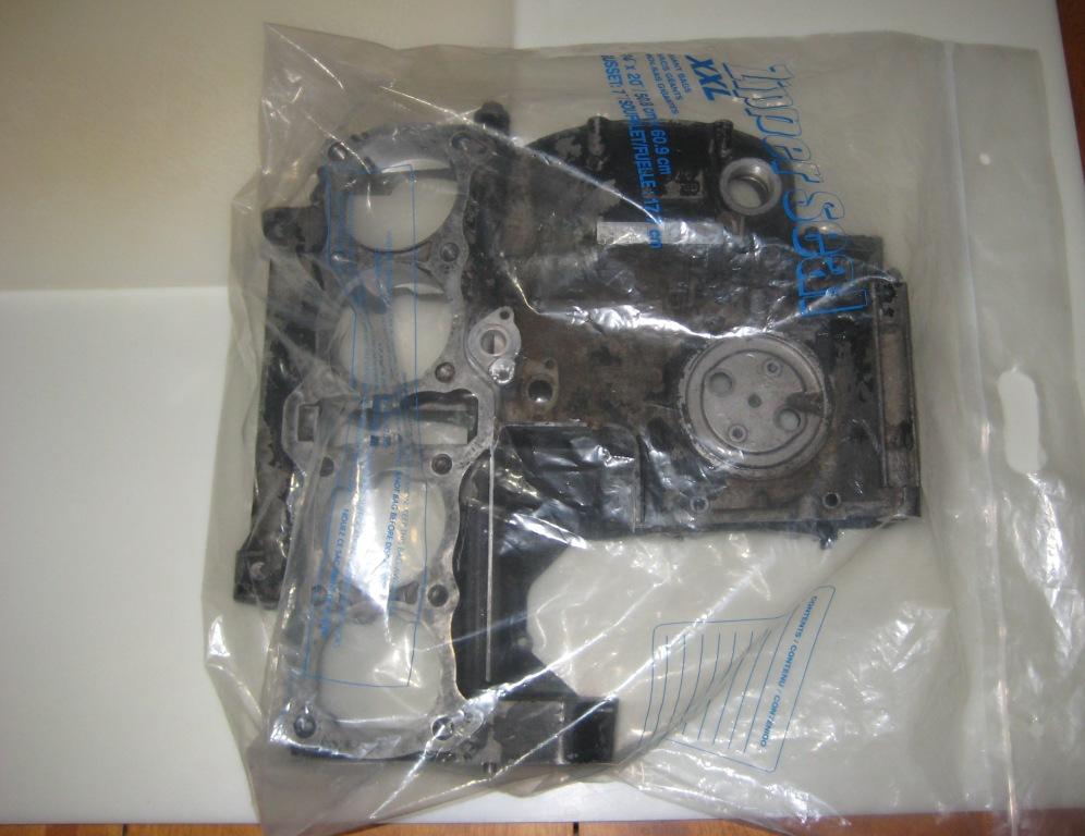

My wife supplied me with the zip bags... even this one :

Funny you should mention "can't get this part in a zip lock bag"
I watched a similar test on Eco strippers on You Tube and it showed car guys using the brush on gel on fenders/quarter panels - They covered the wet gel with Saran wrap (food plastic wrap) or plastic sheet and had the same results I did, the paint came off in big sheets/bubbled up so it could be scraped off.
There are several videos on there to look at for ideas.
