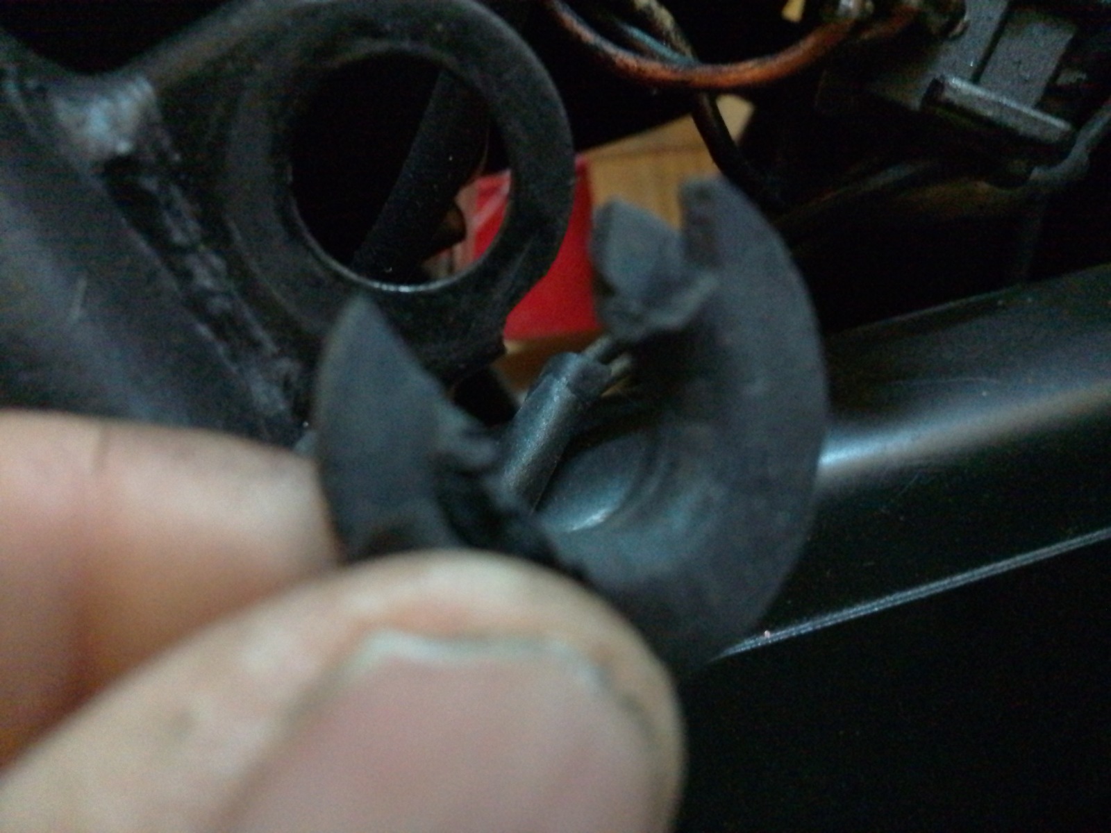

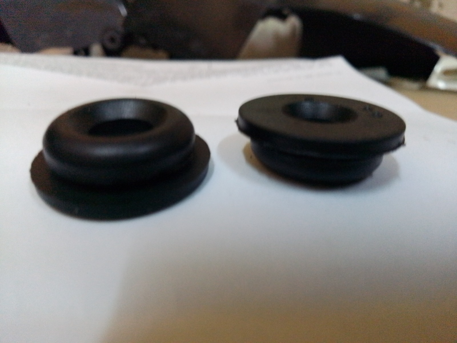

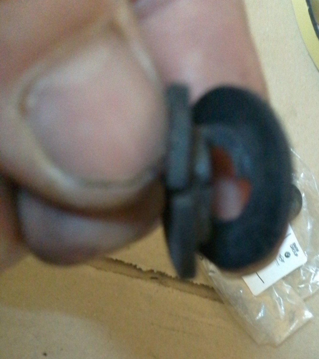

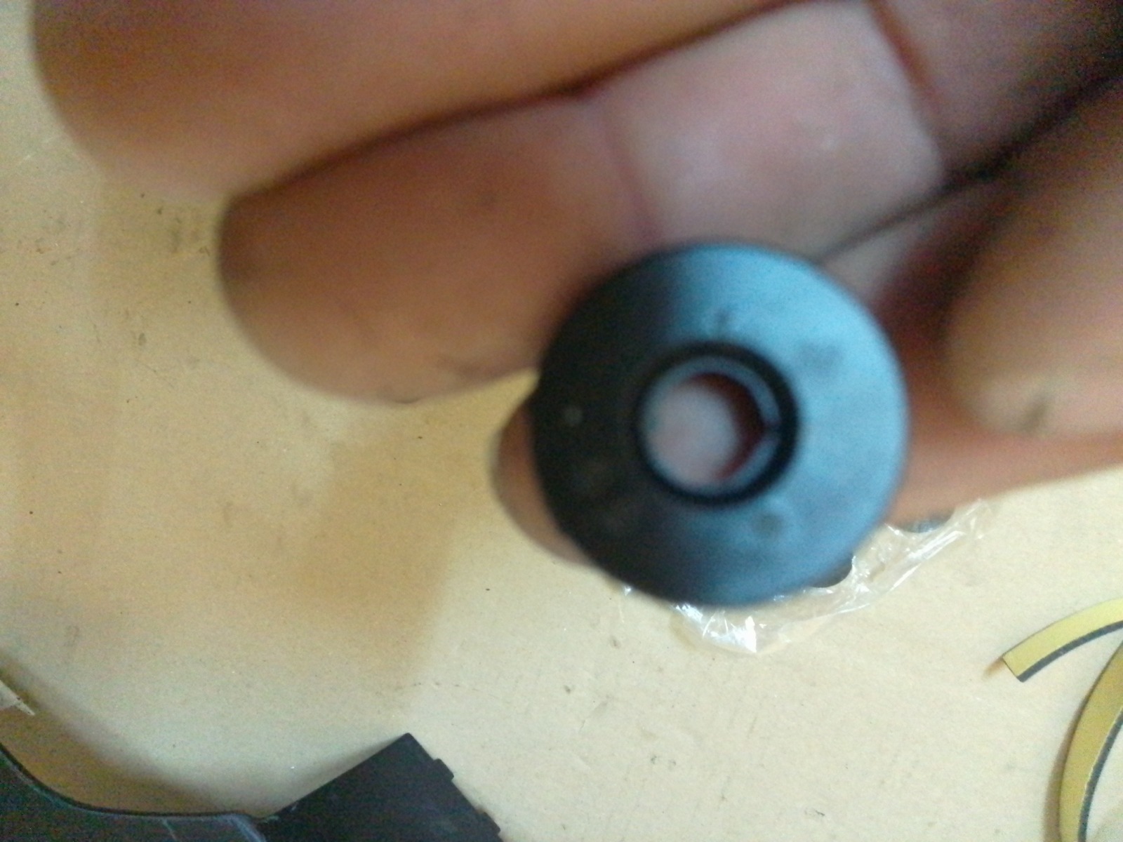

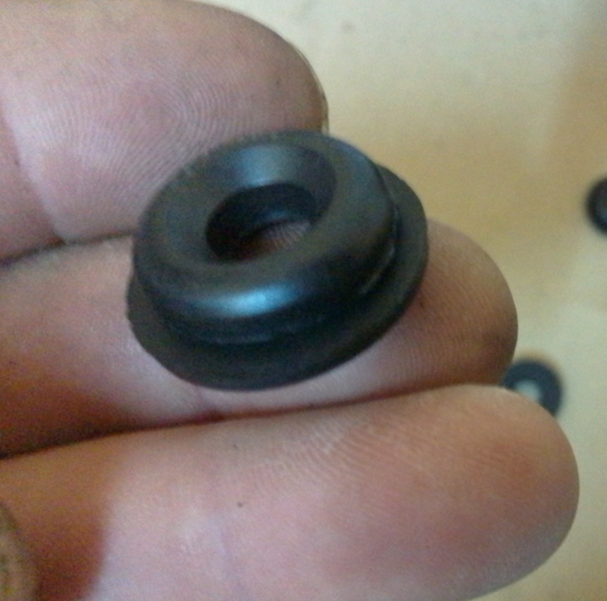

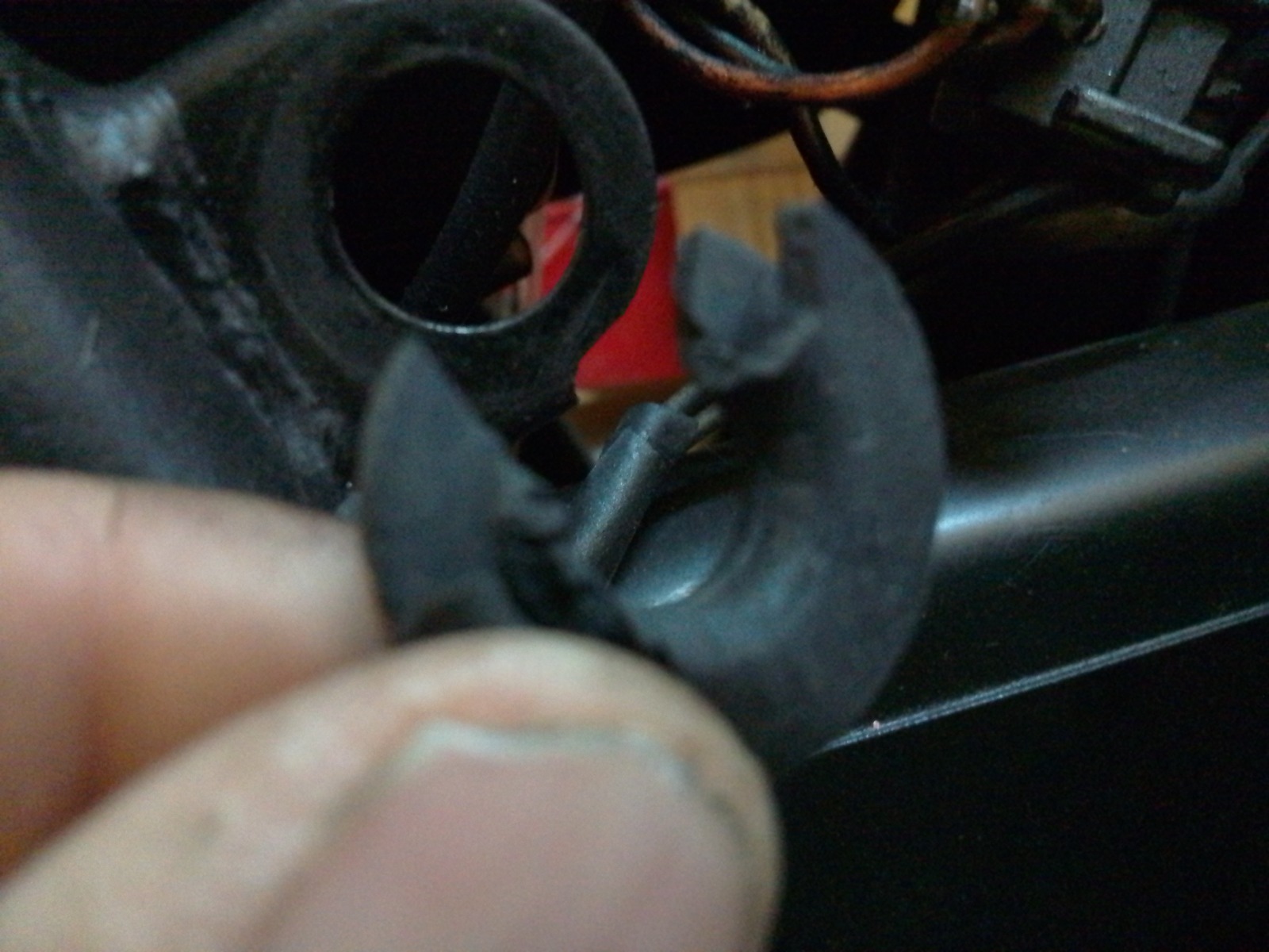

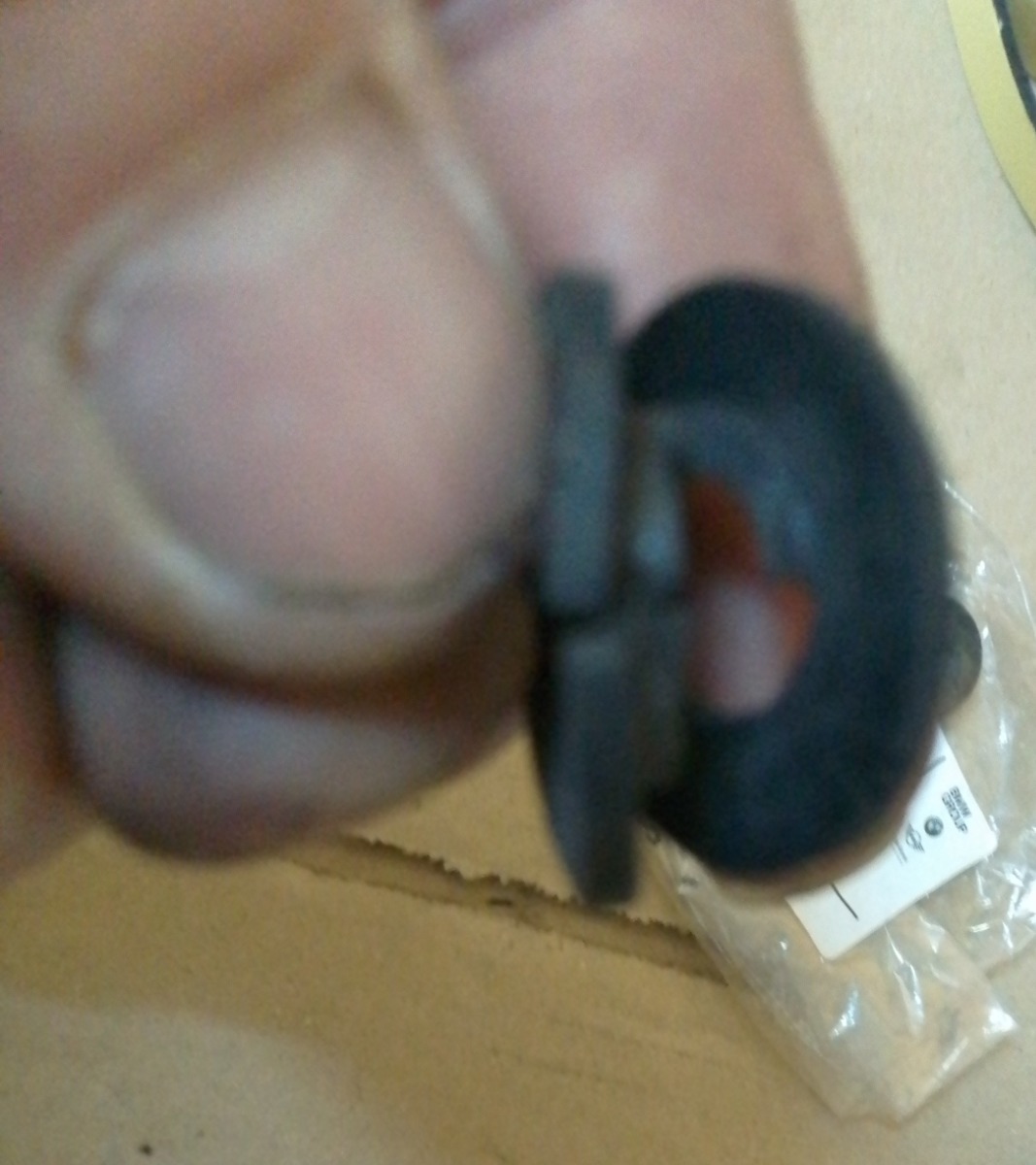

Sometimes a small detail can ruin our lives.Due to some old and worn rubber grommets I lost a side panel of my Z650 running.Kawasaki grommets, even new, are soft and offer very little resistance as a side panel attachment.I have another BMW brand motorcycle that also has side panels and I decided to use those German grommets to replace the ones on my Kawasaki, the result is much better, the BMW grommets are stronger and more resistant with a thicker profile providing more strength and rigidity to the anchorage of the side covers.Also its price is somewhat lower.I attach photos of the old Kawasaki grommets and the new BMW grommets and their reference in BMW spare parts.

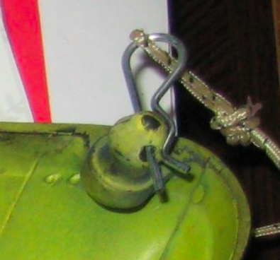

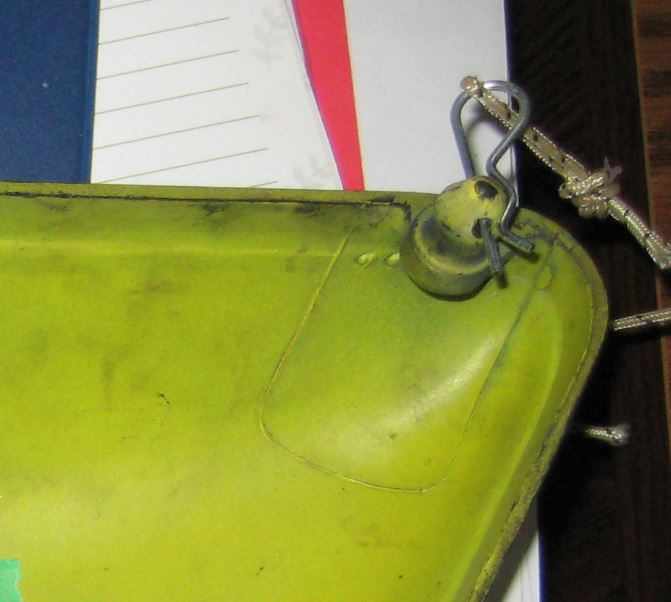

Are you running with an airbox or pods/stacks. Without an air box there is a big void that will fill with wind pressure and can make side panels pop off.
The solution is to drill the panel prong and put an 'R' clip through which is bigger than the frame hole.

My problem was some old and worn grommets, when I ride firts time my bike i get about 112MPH and the side panel decided to fly alone.

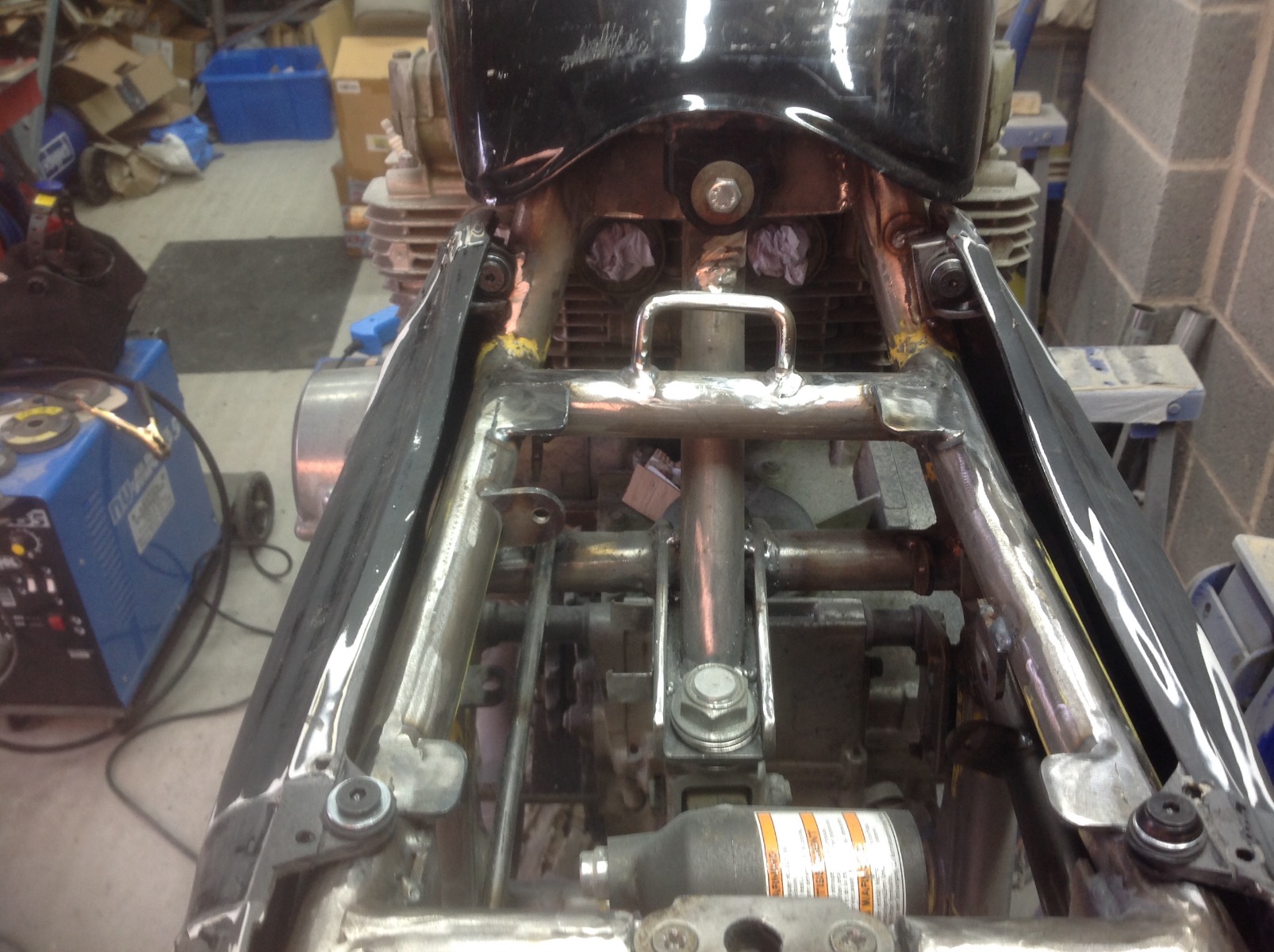

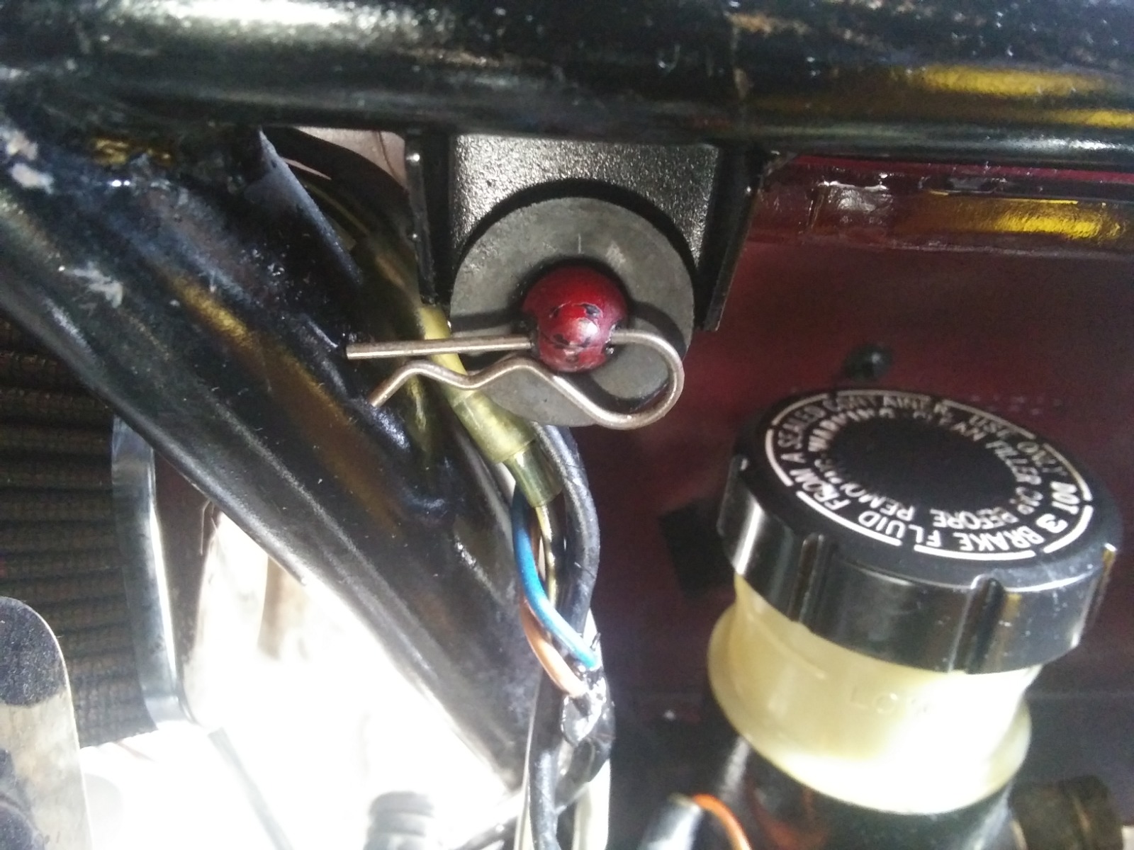

1/16" diameter jewel clip, top rear post on both sides clears the 650 tool tray.
Prevents "blow off" and is anti-theft device

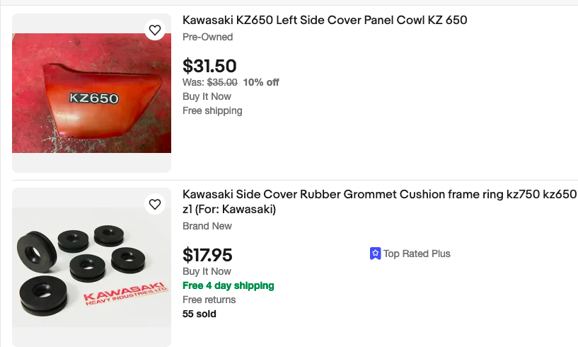

Sorry you lost your side panel. There are plenty on ebay. Grommets too:

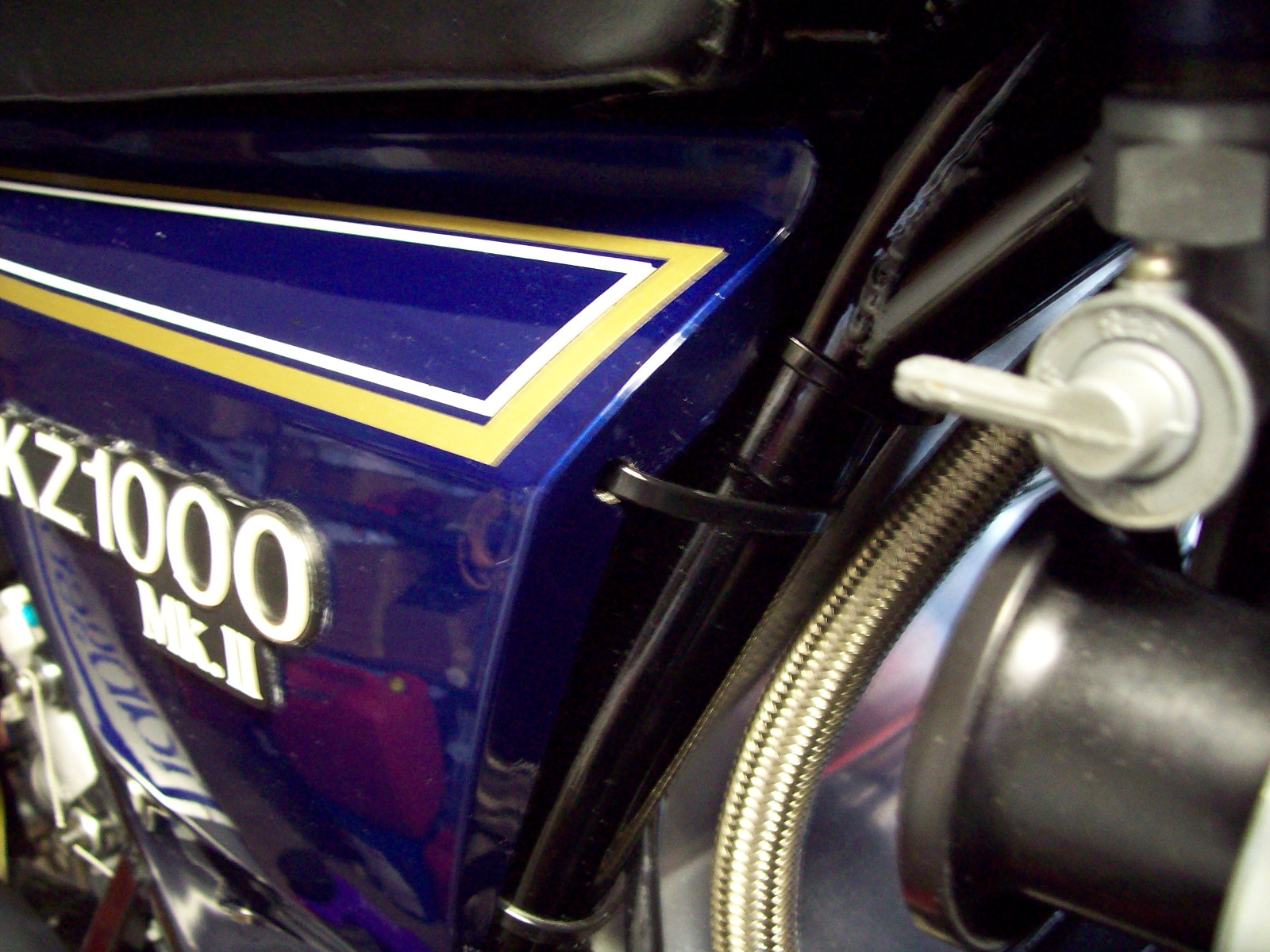

The best method I have found to keep my side covers from becoming a pile of smashed plastic in the middle of the road is to drill a small hole in the front edge of side cover. Then insert a wire tie through the hole and wrap it around the frame tube. Have not lost a side cover since back in the '80's using this method.
