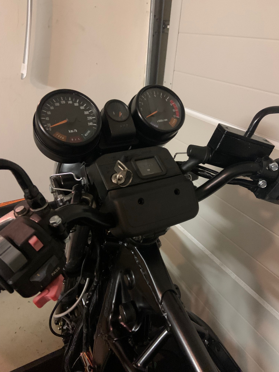

Hi,
My bike (Z1000J -82) is missing the handle cover and I have been searching for one for quite some time. The part number is 59441-1001 and they seem pretty rare, at least in good condition.
I have found both a used one and NOS one with part number 59441-1003 now. On pictures, I cant spot a difference, also on parts diagram they look to be mounted the same way.
1003 is for KZ1100 A and D versions, 1001 is for different kz1000, both for 81-82 model years.
Does anyone know if its the same parts or what the difference could be? Maybe the diameter of the handle is bigger on Z1100 (which would mean that 1003 fits 1001 reasonably)?
thanks!

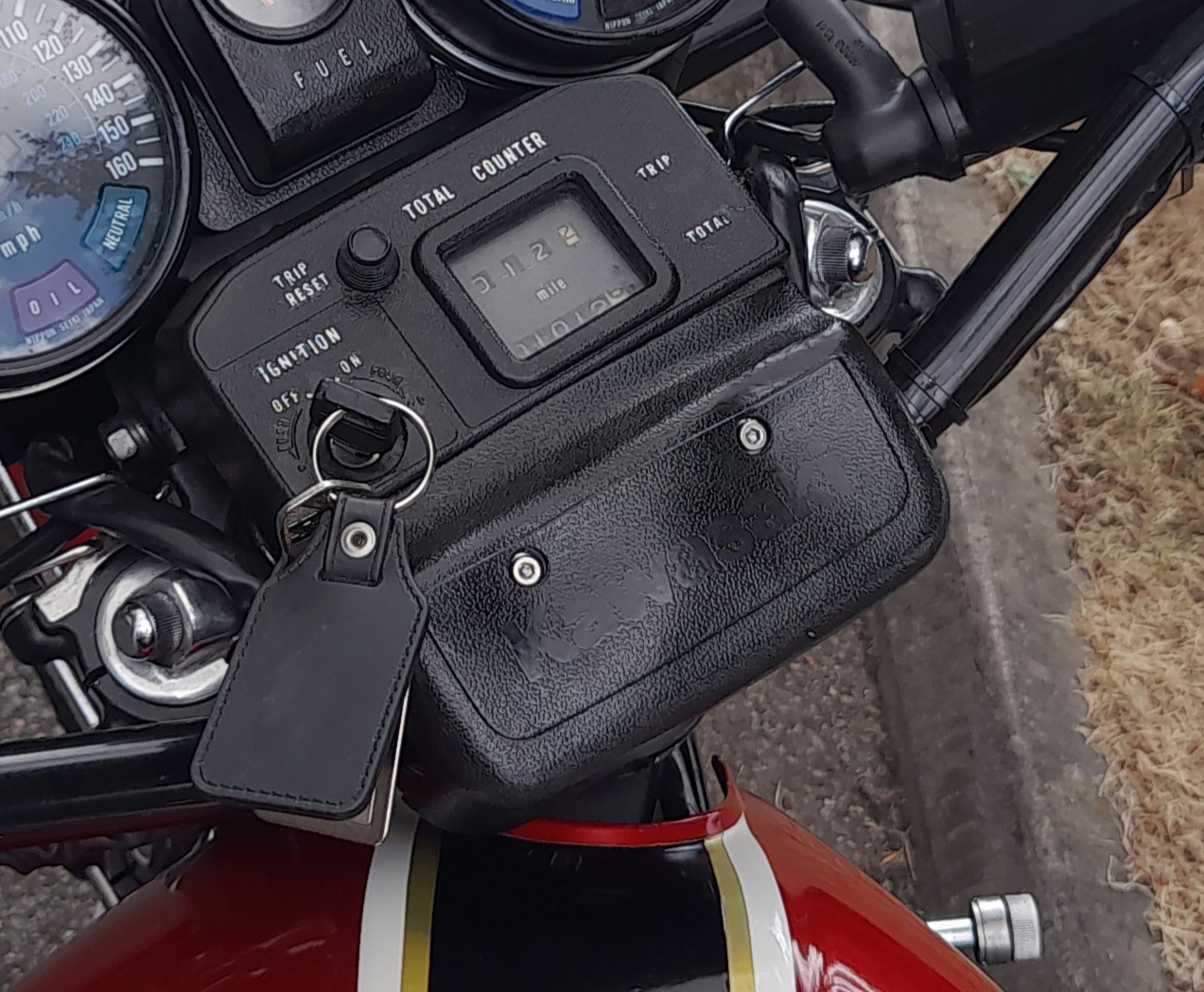

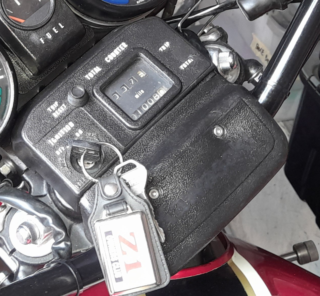

Does your source have a picture of the 1100 one?
This is what an 82 1000J one looks like. The kawasaki lettering embossed should be gold but I didn't like it.

Thanks for the pic! after seeing that, maybe the "lip" covering the gap to the trip meter is wider on the -J part then KZ1100:
Here is an ad pic from Greece I found:
www.car.gr/parts/view/3282408-kawasaki-k...monioy#bigger-photos

- Warren3200gt
- Posts: 1773
- Thanks: 953
Re: Handle cover for KZ1000J -82
30 Oct 2022 13:31 - 30 Oct 2022 13:36
I would say they are the same. I think it's the picture angle that makes them look different. ill have a look to see if I've got a pic from a similar angle.

14 Nov 2022 11:09
The cover arrived today, and its a perfect fit!
thanks, I would not have bought it without your input!
