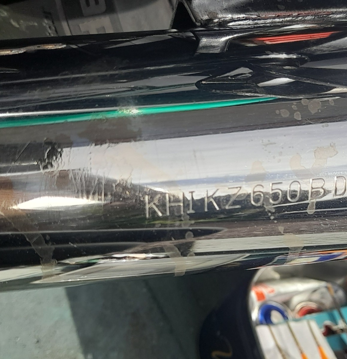

Battery acid marks on chrome exhaust?
It's not bad but rather irksome. Not bad enough for rechrome but is noticeable on an otherwise mint stock bike.

I don't think it's stripped the chrome Kev, just discoloured it. It's not a bike that I use so doesn't see any rain.

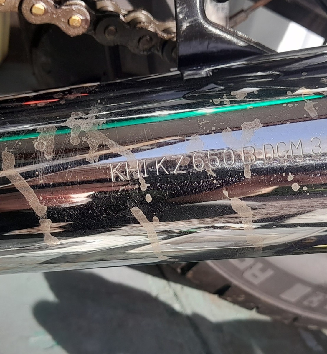

OK, before and after with 0000 and some fine metal polish. Only did the bit above/left of the khi embossing.
Before
After
New tin of elbow grease opened to do the remainder then seal with quick glo.
Before
After
