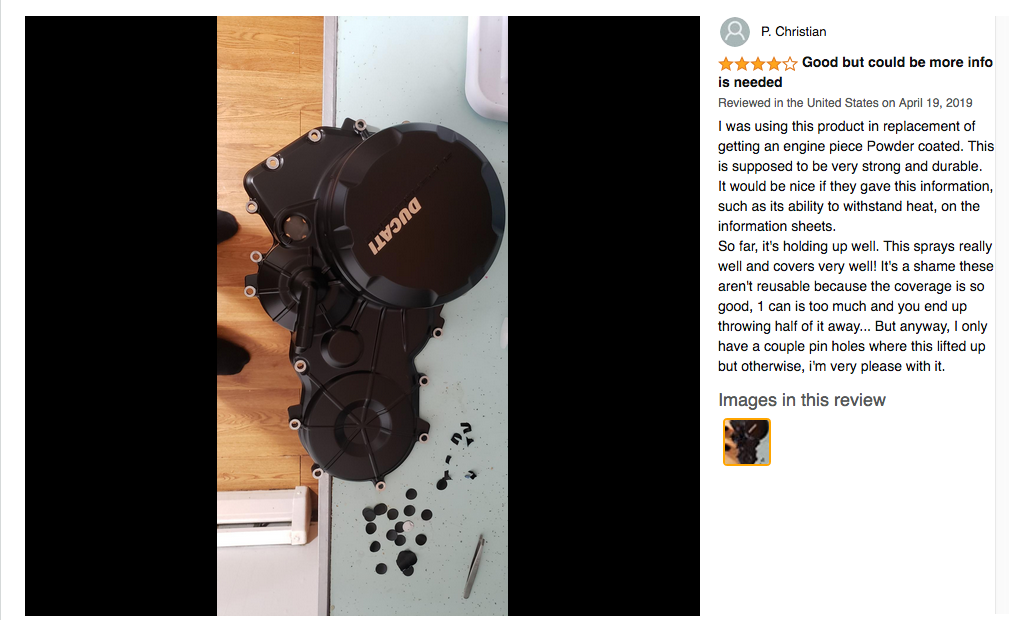

18 Apr 2022 11:52 - 18 Apr 2022 12:37www.spraymax.com/en-us/products/product/...atte-2k-clear-satin/
and then I saw this
SprayMax makes a satin black 2K.
www.spraymax.com/en-us/products/product/...ts/2k-hot-rod-black/

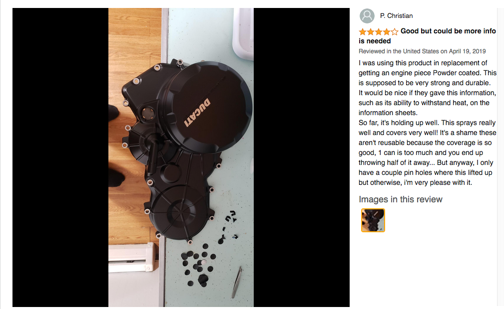

amazon review photo

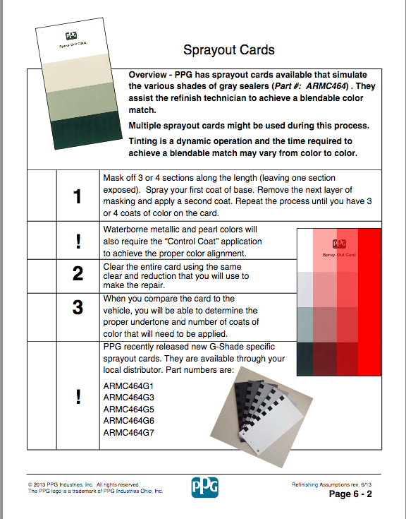

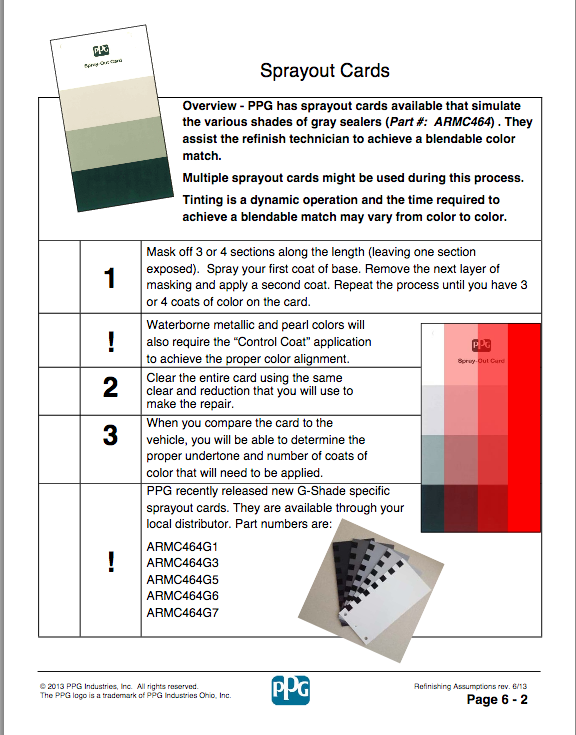

You will have to test on spray out cards or a test panel and see if the finish matches.
There is no standard for gloss level terminology.
One companies' semi-gloss finish maybe another companies' matte finish.
photo:PPG training/basic assumptions-refinishing
nanopdf.com/download/refinish-assumptions-guide_pdf

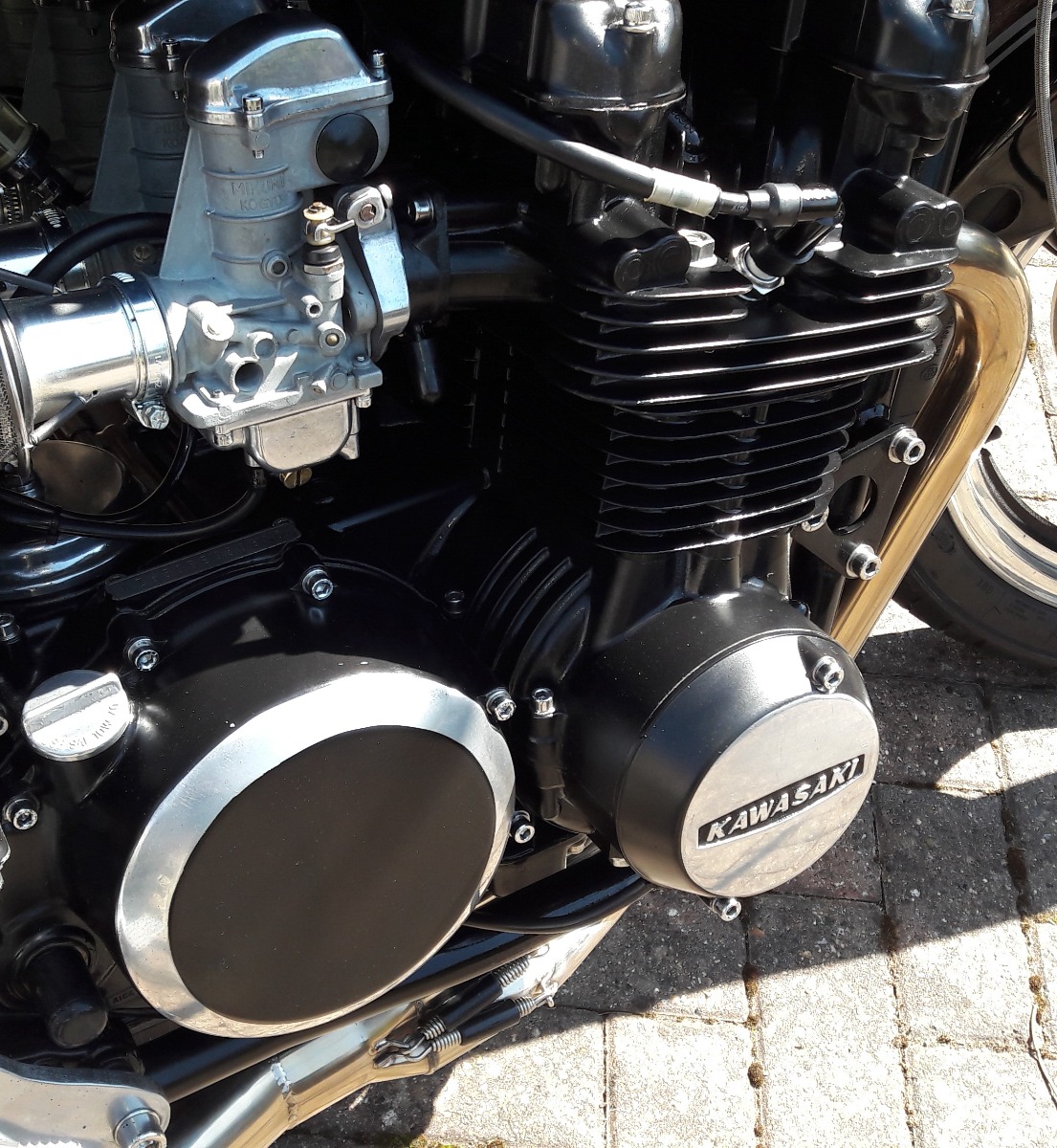

I used VHT Roll bar and Chassis paint in satin black to touch up spots on my 1978 1000 LTD matched perfect. I’d buy you a week of dinners if you can tell me where I touched up the frame. Not Urethane but claims to be Epoxy.

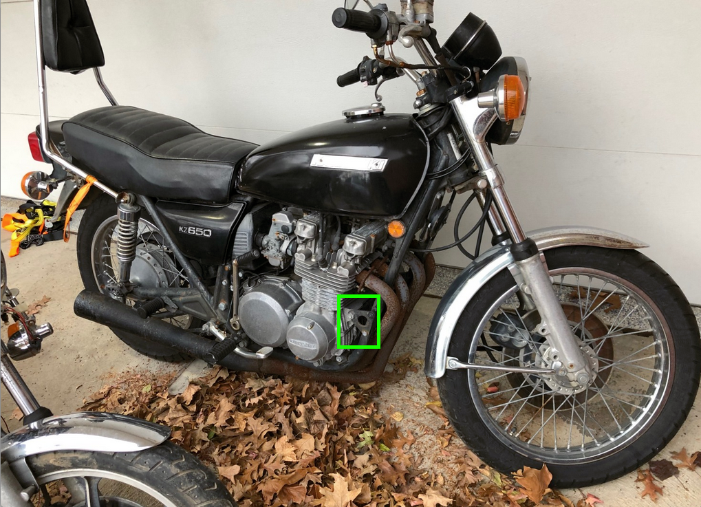

You could buy this piece and match the gloss level to it.
engine mount
There aren't many 2K rattle cans out there. Eastwood has their own line as well.
engine mount
