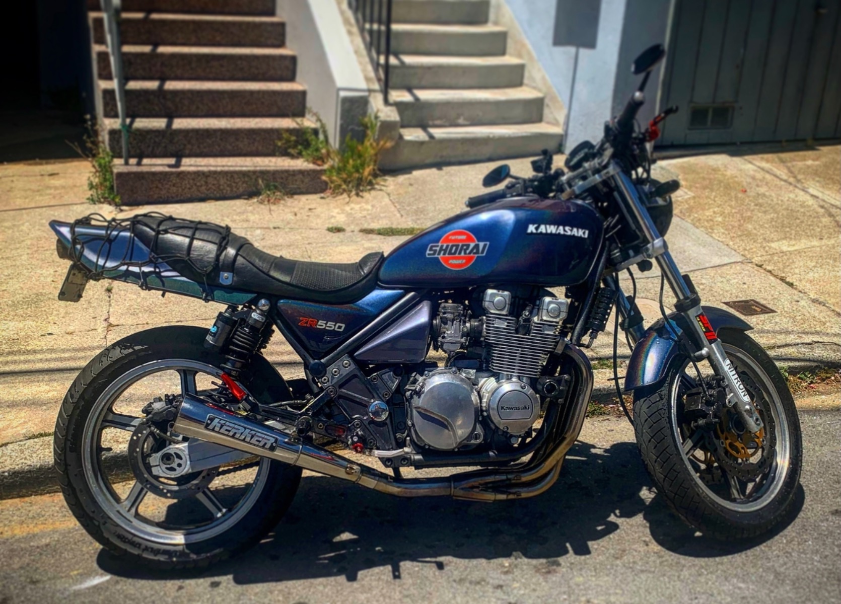

Color shifting paint
22 Sep 2021 22:19
1990 Zephyr zr550 B1
Wiseco 615cc kit
zx550 cams
SPII ignition system
Kerker stainless steel race exhaust with 1.5" competition baffle
K&N Air Filter...
Wiseco 615cc kit
zx550 cams
K&N Air Filter...

Nice bike! Looks fantastic.
Do you have any other threads on it here? I’m curious about your other mods.

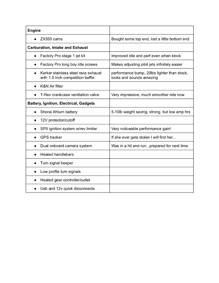

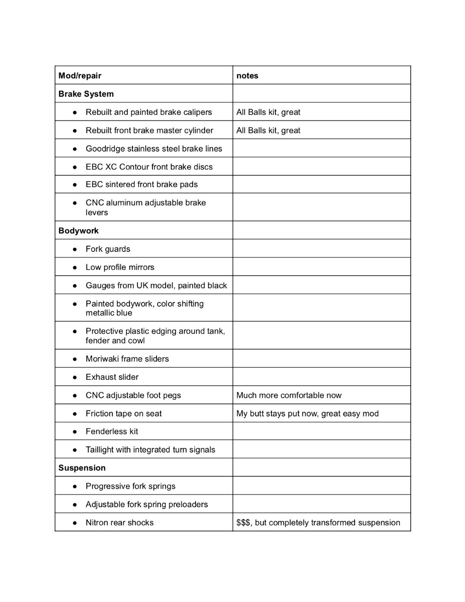

Most of the mods and repairs I've made to the bike. All worth it in my opinion - maybe will give you some ideas?
Wiseco 615cc kit
zx550 cams
K&N Air Filter...
Wiseco 615cc kit
zx550 cams
K&N Air Filter...

Cool stuff! Thanks for sharing. I have some ideas about some mods I might make at some point, but I’m still a new rider so I’m more concerned with just keeping the bike healthy and practicing my riding skills.
But with that said, I can see how as my skills improve, and I spend more and more time in the saddle on different roads, and at higher speeds, I may desire some upgrades. It seems like the front suspension is the place to start, so I’m thinking about rebuilding the stock forks with RaceTech springs and gold valve emulators. I haven’t yet decided if I want to invest in the tools to do this myself, or if I want to just send them in to RaceTech to be done professionally. Rear shocks should probably be rebuilt or replaced at some point too.
For the motor, it’s plenty fast for me right now, but I do feel like sometimes I need a little faster acceleration. Maybe it’s cause I’m just timid on the throttle, and that will improve with practice. But I’m not overly concerned with being the fastest guy out there and having the highest top speed. For that matter I do a lot of commuting so mid range power makes more sense. This is why I don’t think that the GPZ550 cam swap is the right mod for me, and when I am ready for more power the Wiseco big bore kit sounds like it will be a good choice.
But I’m in no hurry here, and have plenty of time to think about my options before I commit to anything that can’t be reversed.

It's a hooligan bike for sure. Probably about perfect for San Fran. 40 yrs ago I was piloting my GPz550 through the same streets.
Nice job.
