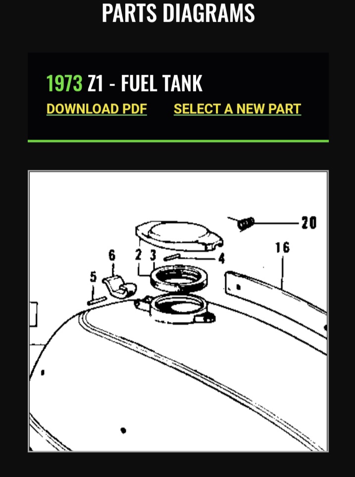

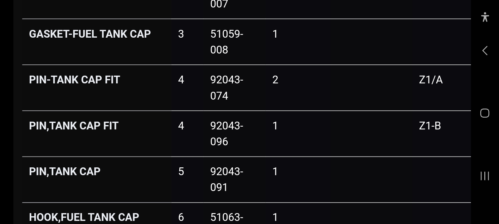

21 Apr 2023 02:10Thanks Wookie, Unfortunately that's for the locking cap that needs only one pin the cap I have is a repop Z1 cap with no lock just a latch.

As its an repop cap they have covered all the bases as Z1, Z1A & Z1b were slightly different.
I would say the roll pin is the for the cap as all the hinged cap tanks I've seen use a roll pin there.
For the latch I would go with whichever of the other two that matches the width of the latch.

Thanks Warren! That makes sense, I didn't know the Z1/Z1A cap was different from the Z1B that explains why I have an extra pin.
Thanks for taking the time to answer my question.
