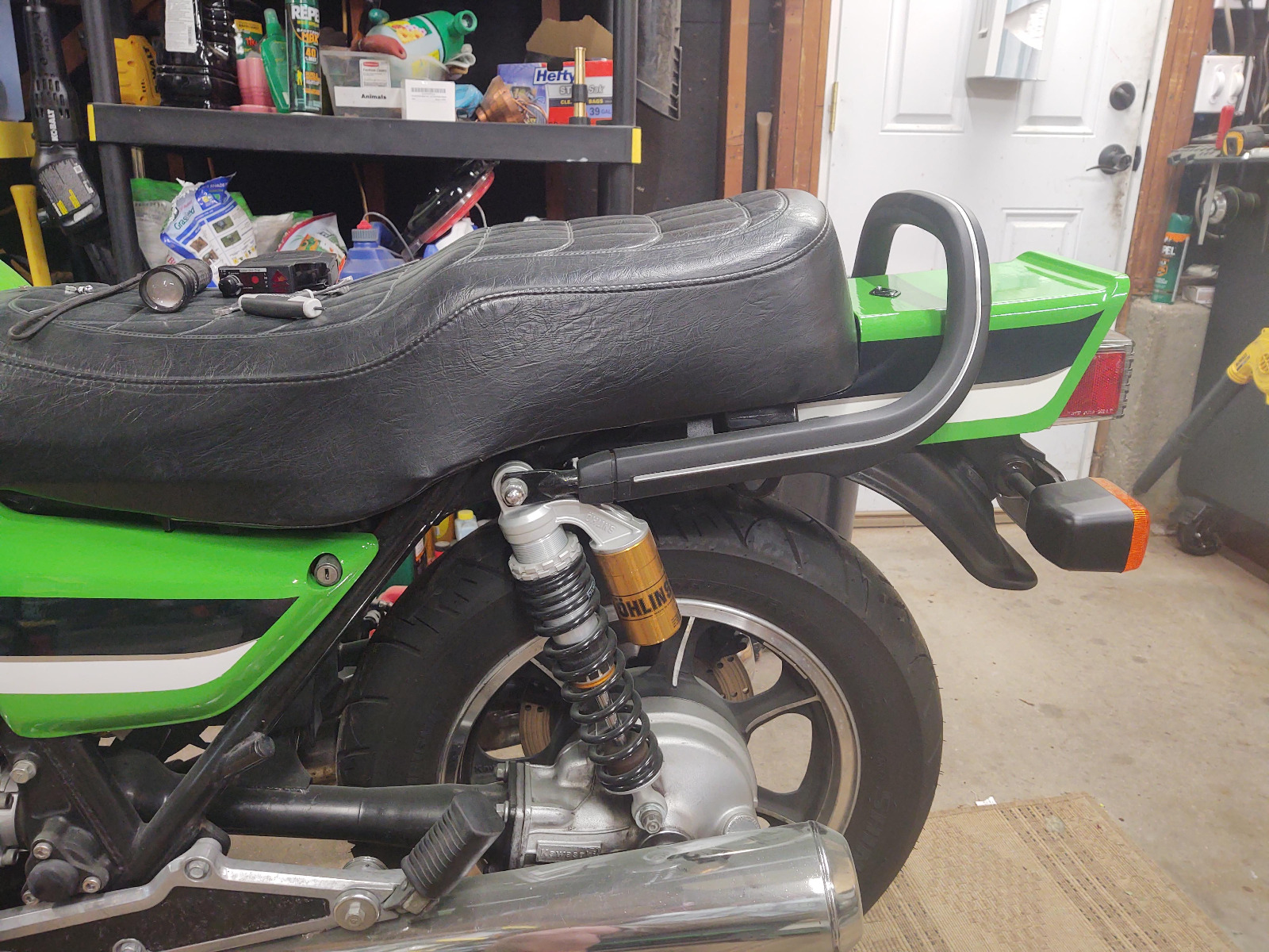

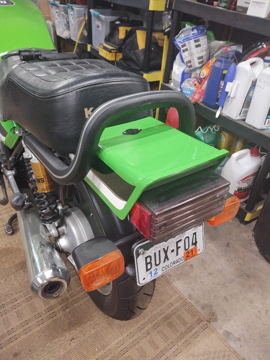

Thought some of you might find this interesting. I'm playing with an 82 1100 Shaft and of course painting it up like an ELR. I can paint the bodywork green and add stripes, but this model doesn't have a tail fairing, and it just doesn't look ELRish without one. So I fired up the 3D printer and made one. Pretty neat, we'll see if it holds up.

This is ABS (Hatchbox). Took a lot of learning to get it printing successfully, but I knew the standard PLA would not hold up.

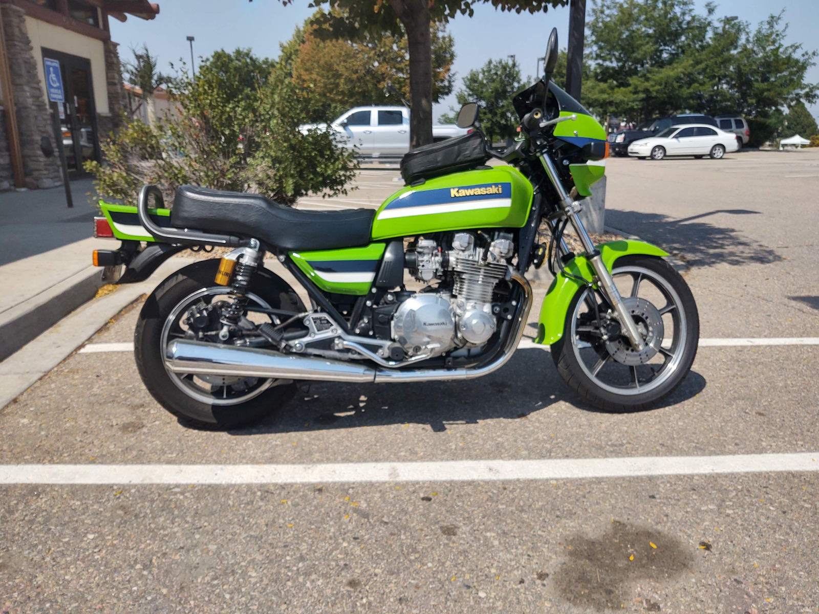

I imagined that a tail would look good on a KZ1100A, and this adaptation confirms it.
If possible, please post a couple pics of the entire bike...

Ender 6 printer
As it sits today, still a lot of work (which is the whole purpose, this is just for fun)

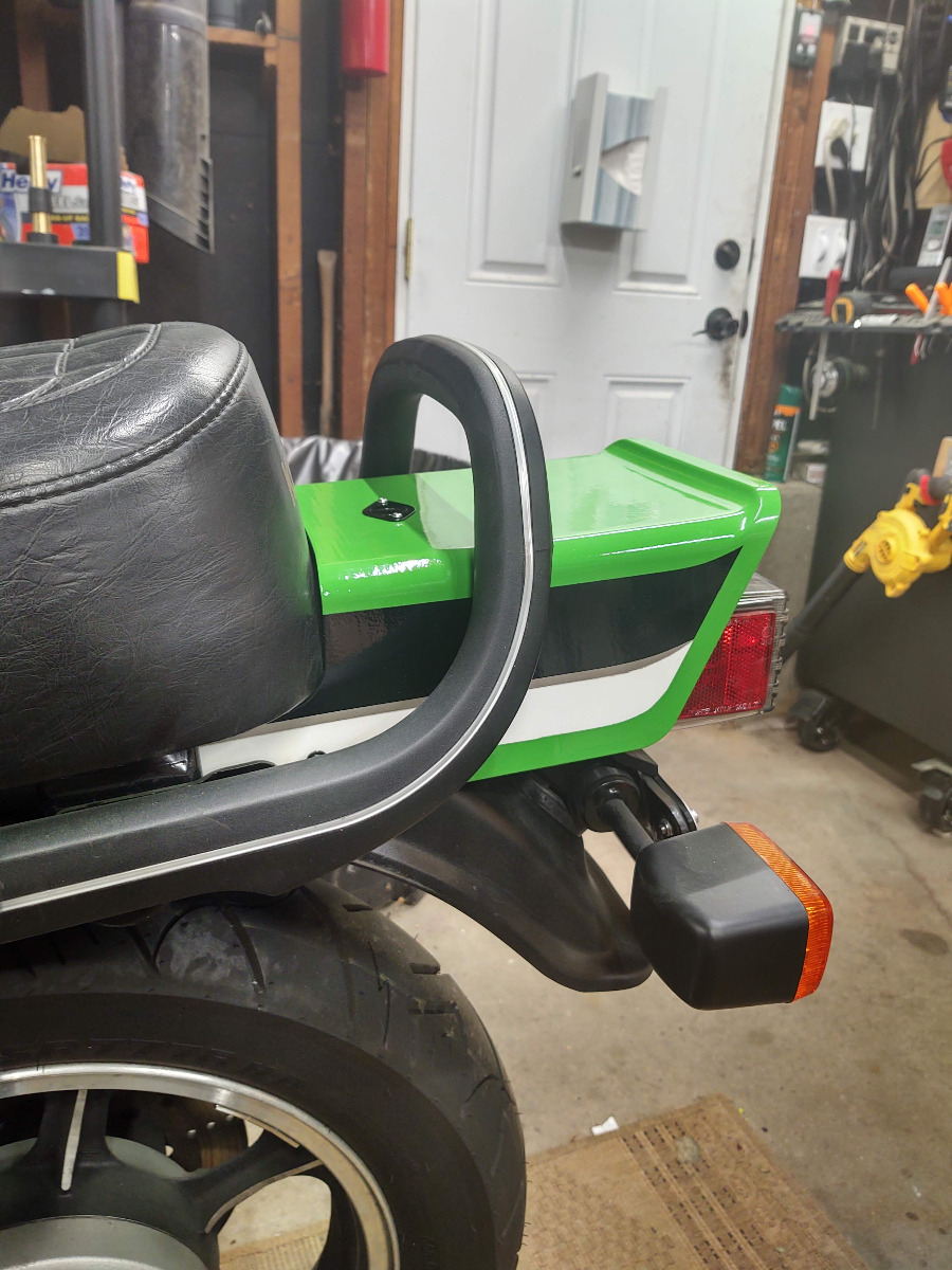

All of the 3d printing that I've seen so far has had a fairly ropey surface finish; the end result of yours looks great. Did you use a filler on the final printed item, and if so, what did you use? Plastics are gnerally hard to get stuff to stick to them.

25 Feb 2022 10:10 - 25 Feb 2022 10:12Printing is in ABS, pretty slow with a small layer setting. Then a whole bunch of sanding before painting. No filler, but I would bet an experienced body worker could do it better and faster with some filler.A tail definitely suits the bike!
