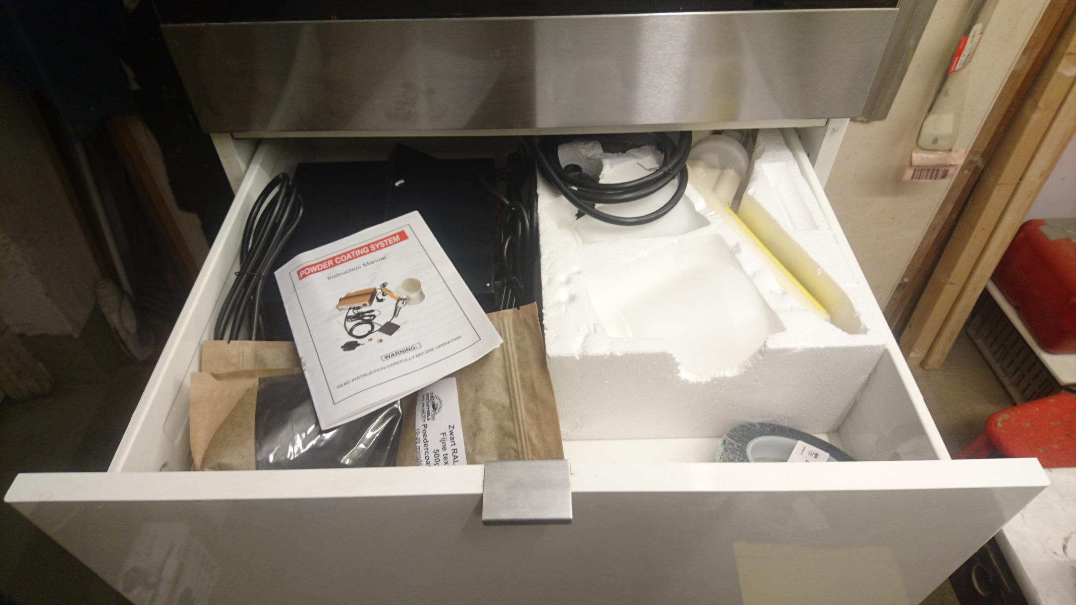

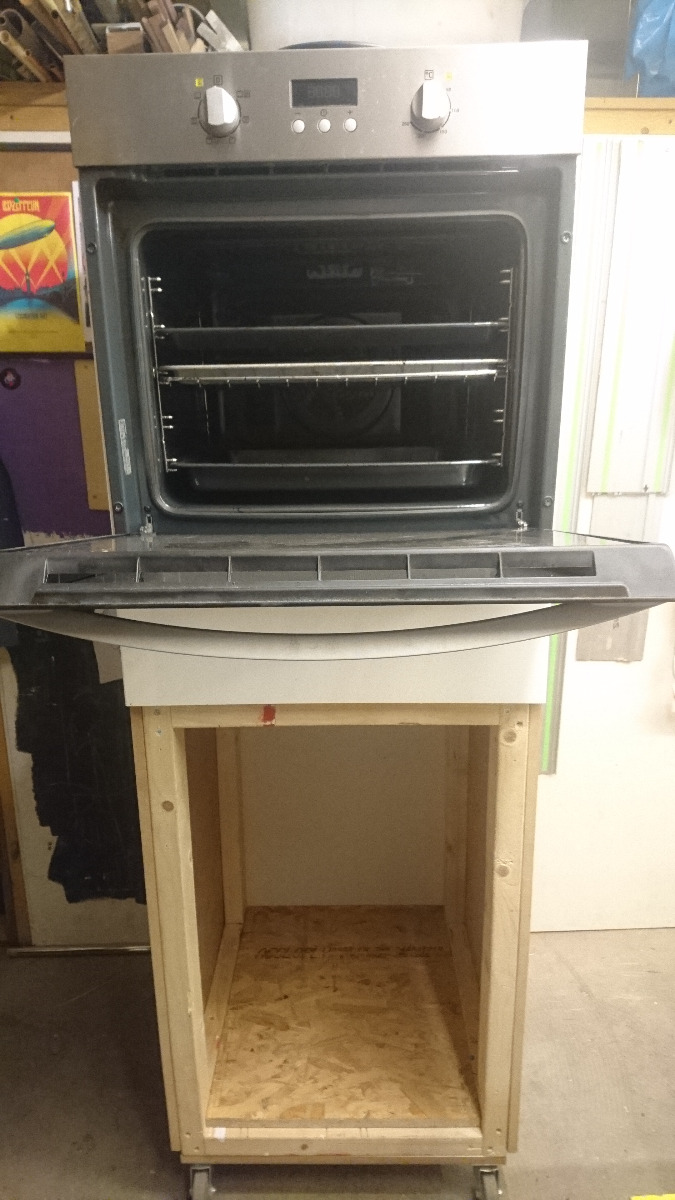

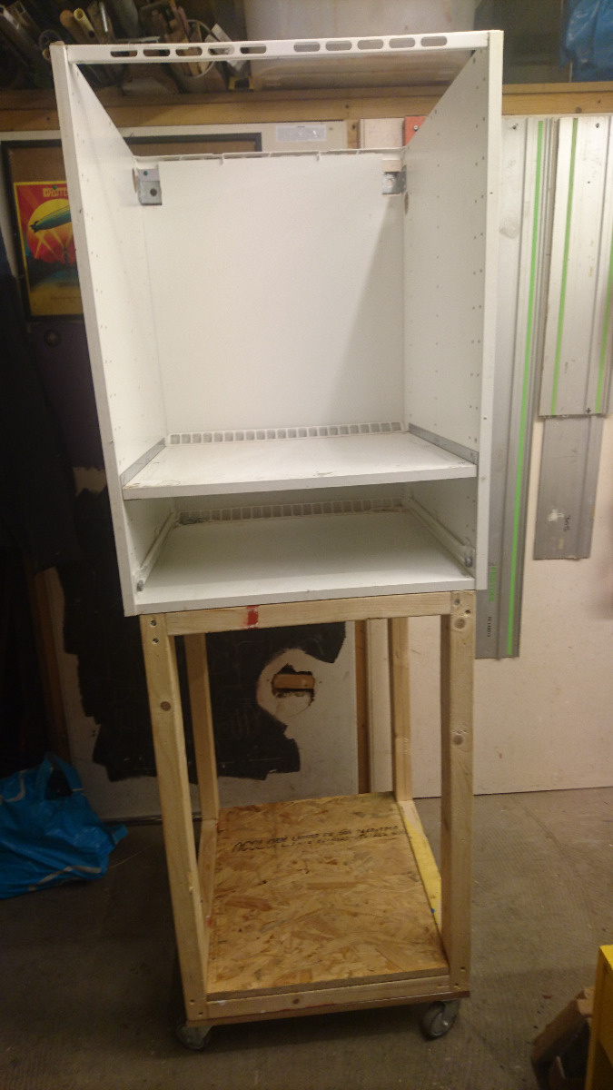

I bought a powdercoat kit off Amazon a couple of weeks ago and this week I started reforming a house in town. The kitchen was going in the garbage so,I now have a dedicated powdercoat oven. A couple of hours in the workshop with a set of wheels and some offcuts.......
Still working on the ventilation though,so it will be a while before I can start cooking. Also, Im looking at a small blast cabinate which i'snt expensive but I think my compressor is too small, I might need to invest in something bigger first.
The main problem (other than budget) is finding space for all this stuff.
