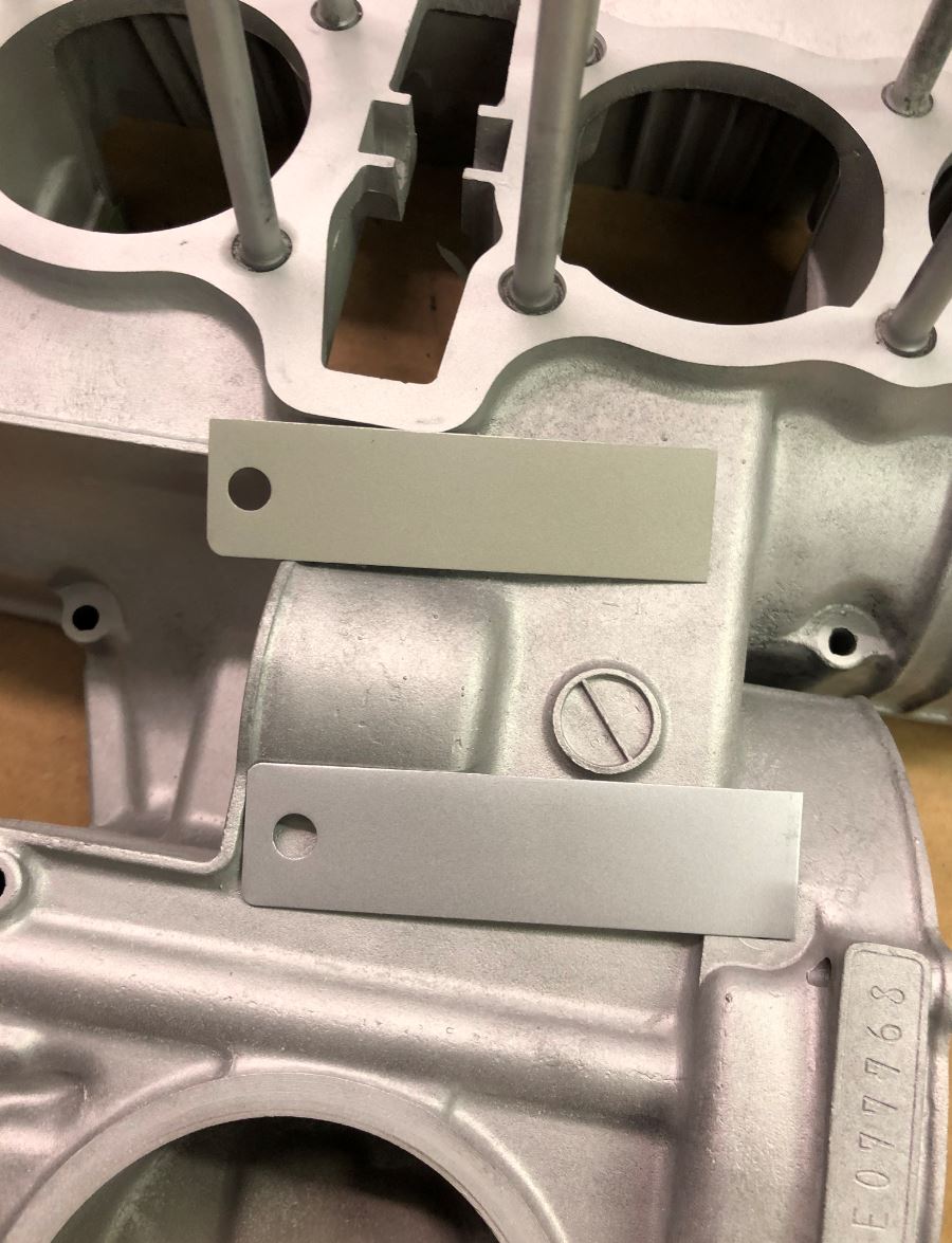

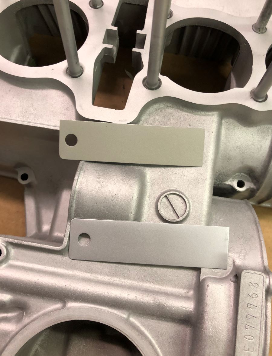

15 Mar 2021 07:52
Received paint samples from Cerakote. I think I will go with bottom one. Matches blasted aluminum perfectly. Handles 1800F. Air dry product.
Still need to bake cases to get any of the grease out, but it is doable.
