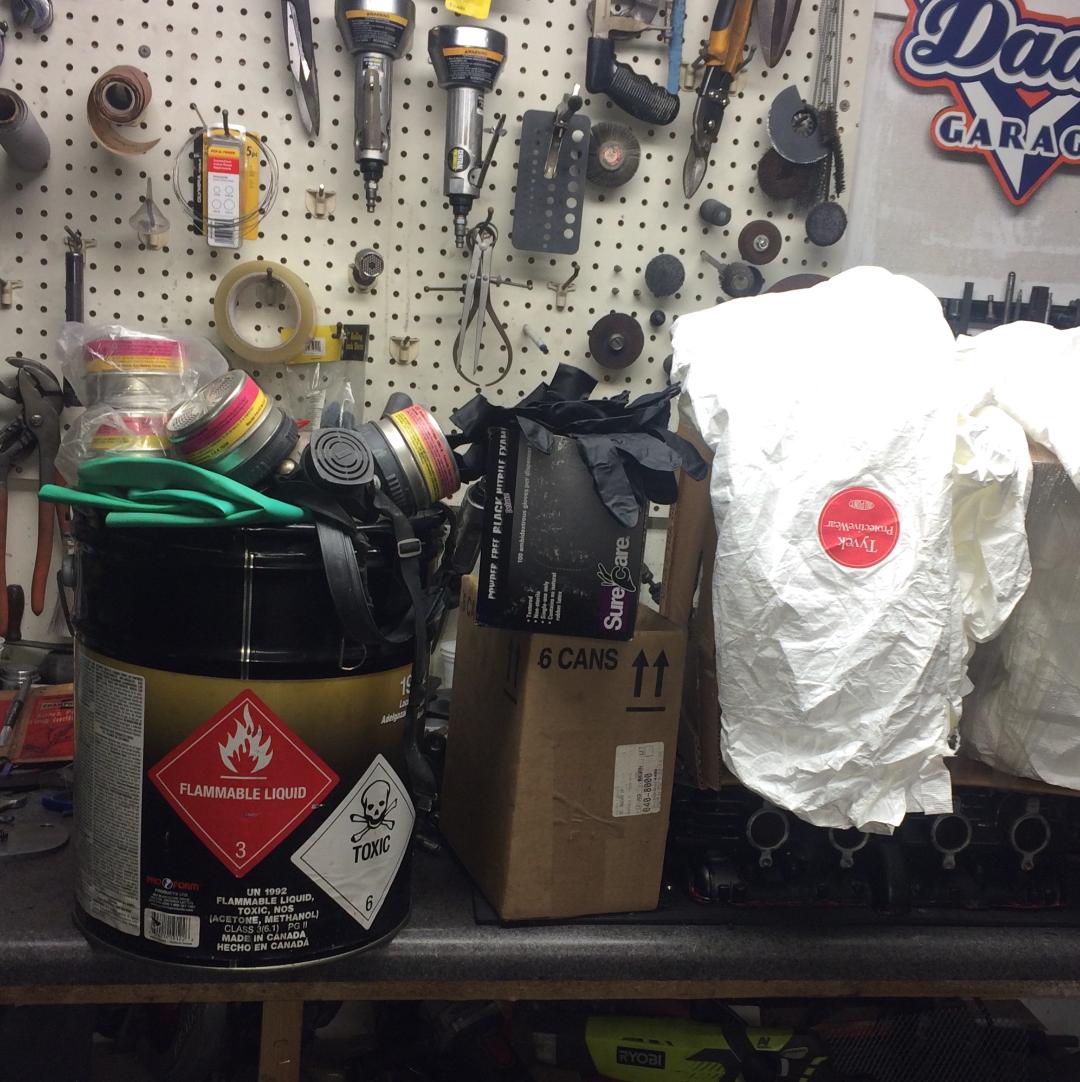

Re: How in the world to get this tank liner removed
17 Feb 2021 16:11
Real Auto Body Shop Lacquer Thinner, 5 Gal. pail. Fill it outside or in a garage. Just let tank sit full. Lacquer thinner is the universal solvent! I sniffed enough of these fumes the past 40 years! :laugh:
