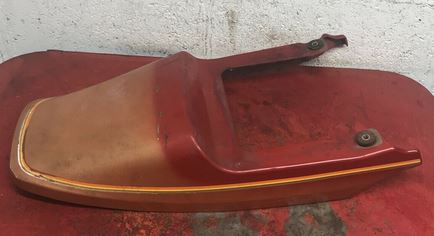

Here's an example of a 1979 (not the same year, I know) KZ650 red tail piece. Quite faded, and we don't even know how many years it actually was in use. Believe it or not, I've seen much worse. Ed
