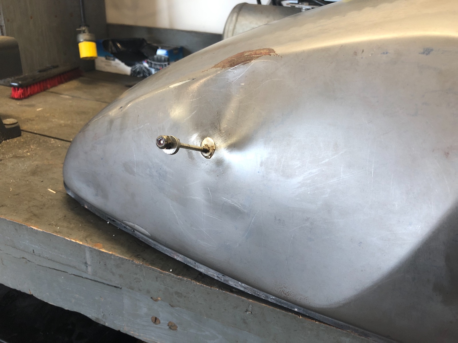

Re: Dented gas tank repair advice request
16 Feb 2022 06:20
73Z1, how about this:
Yours is a bit worse, but if the tank is to be repainted, this might get you close enough to finishing the job with a thin skim of filler.
Ian
Ian
