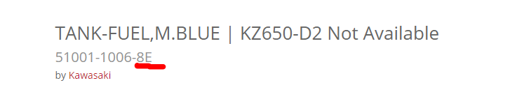

Re: Paint code for midnight blue
17 Oct 2020 09:54
I think the code is 8E

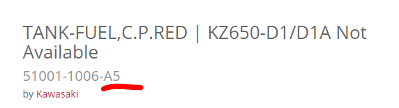

17 Oct 2020 12:29 - 17 Oct 2020 12:34martin_csr wrote: There are no bona fide paint codes for old Kawasakis.
Martin,
If you look at the parts fishe under fuel tank for example you will see that there is a suffix on the part number for the different colors. I take this to mean the number is a color code. Mind you this information is pretty useless unless some paint manufacturer makes a formula to match the color. That's a different matter though. The OP asked for a paint code thus my response...
17 Oct 2020 18:44 - 17 Oct 2020 18:46
AFAIK, those part number suffixes aren't useable as paint codes in and of themselves. Someone like Painworkz would have to come up with a matching paint by scanning old body work. Then they would have a code which they could then say matches the 8E or whatever the suffix happens to be.
